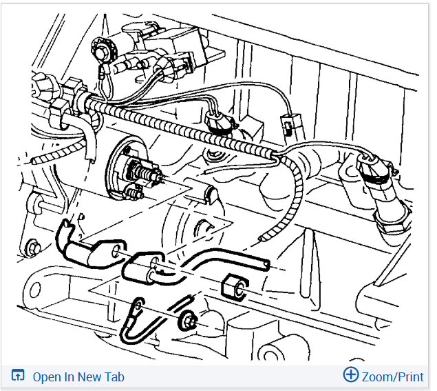

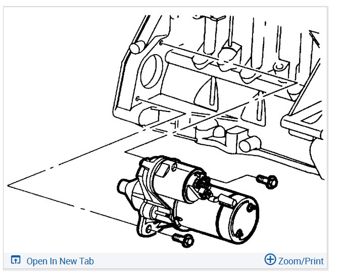

I am having a hard time removing the starter to replace it. I need help on the easiest way to do this.
May 24, 2025 at 2:54 PM
  • 55,381 POSTS
Sure, we can help you, I don't know if there is an easy way, but you will need to jack the car up, this guide can help:
Also, you can remove the CV axle if it is in your way to make it easier. Please disconnect the battery first. Check out the images (below). Please upload pictures or videos in your response of any problems so we can see what to help you with.
May 25, 2025 at 6:03 AM
INDIGOBLISS1979
Thanks. I ended up getting it. But went from the top. Just had to have like 4 extensions on my ratchet, laying across my engine. Lol. But thank you.
