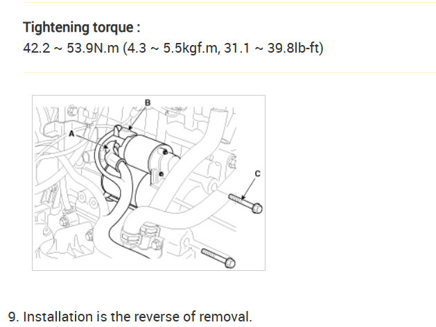

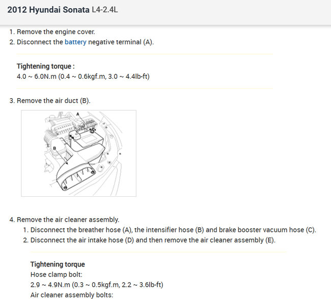

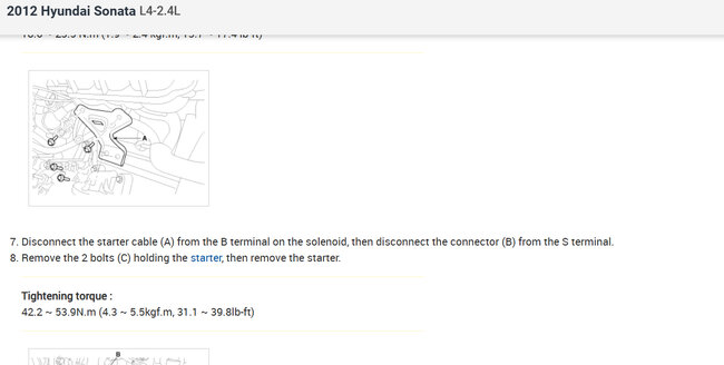

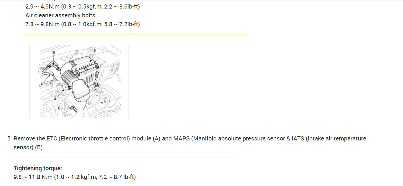

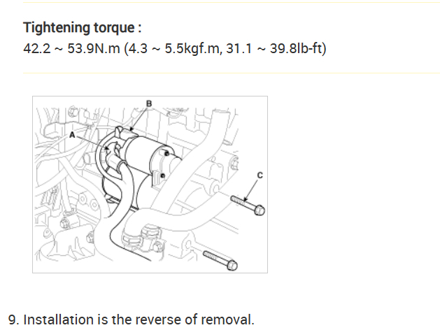

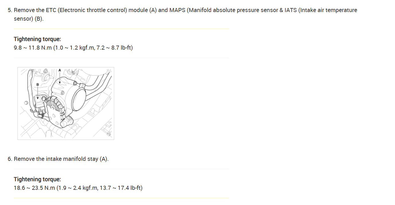

Sure, I can help you, here is a guide that will help step by step with instructions for your car in the images below. Please disconnect the battery first and park the car on level ground before you start. Check out the images (below). Let me know how it goes
