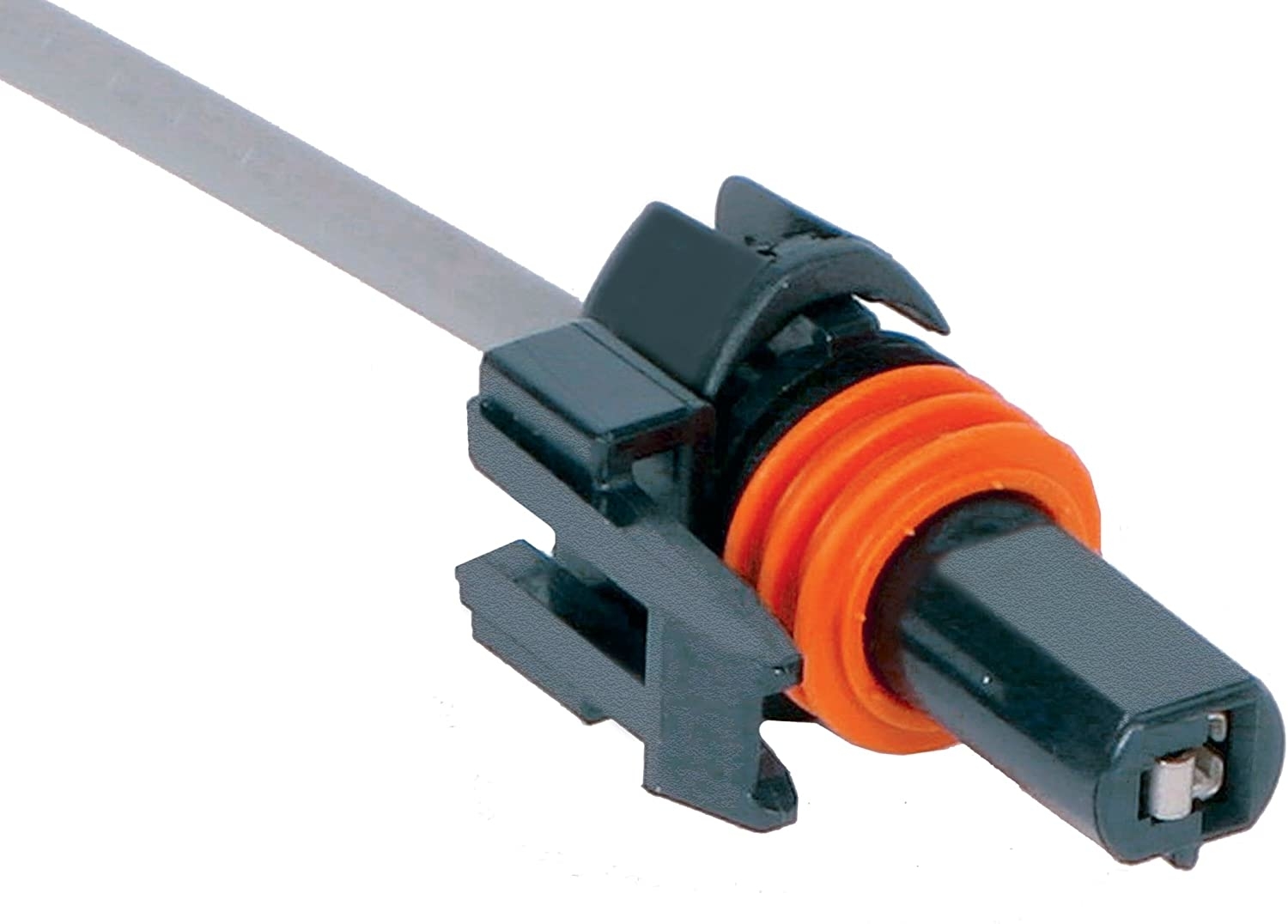

I have to replace my starter. I bought a refurbished starter. I was able to take out the old one and my old starter normally is one you plug in. Well the new one doesn't plug in the shop that I bought it from said I would have to crimp the wire onto the new starter giving a longer life. But I'm concerned on if this is safe and if so how do I go about doing so?

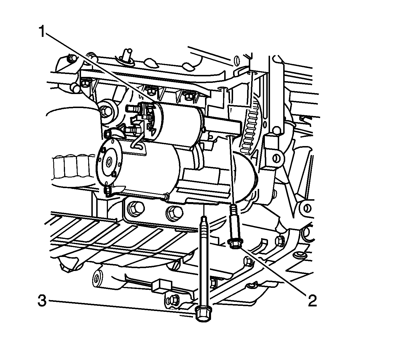

pic 1

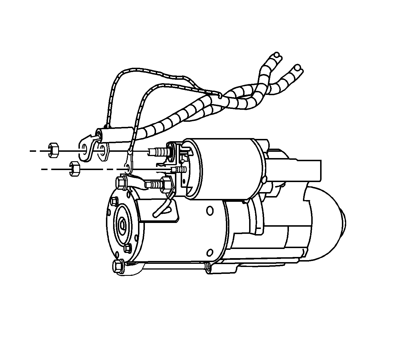

3. Remove the starter motor solenoid positive terminal nut and electrical wires.
4. Remove the starter motor solenoid S terminal nut and electrical wire.
pic 2

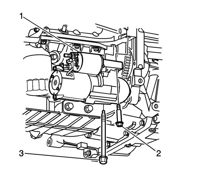

5. Remove the torque converter cover bolt (2).
6. Remove the torque converter cover (1).
pic 3
7. Remove the starter motor bolts (2, 3).
8. Remove the starter motor (1).

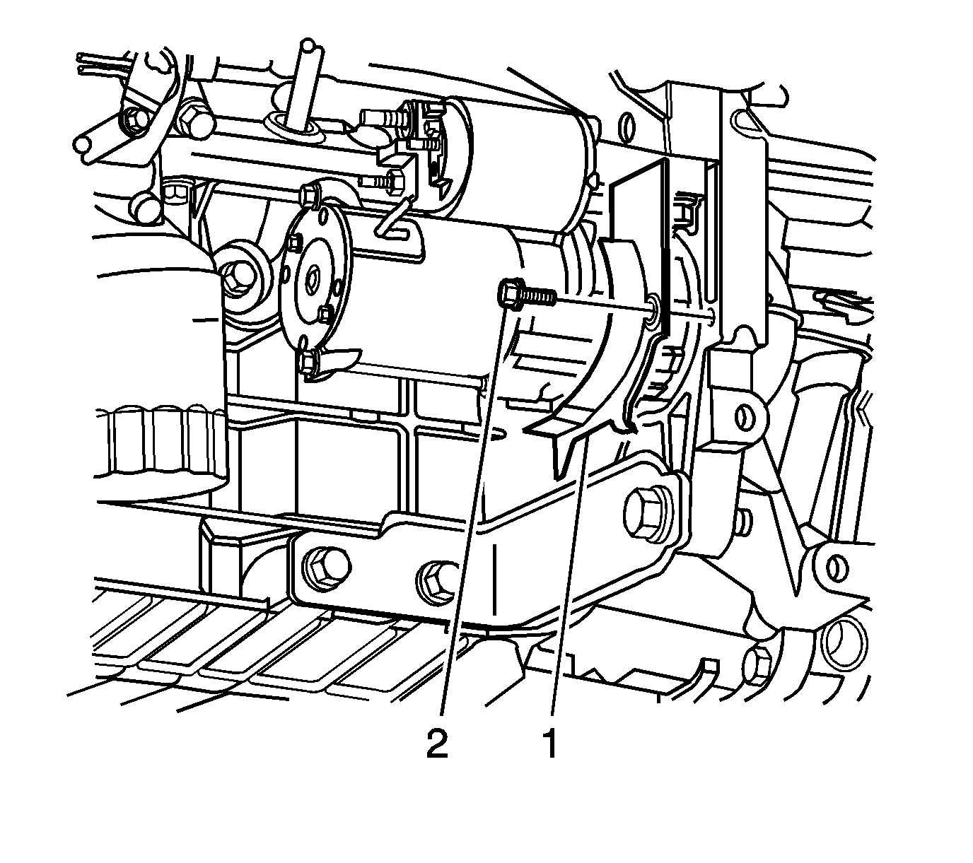

pic 5
3. Install the torque converter cover (1).
4. Install the torque converter cover bolt (2).
Tighten the bolt to 8 N.m (71 lb in).

5. Install the starter motor solenoid S terminal electrical wire and nut.
Tighten the solenoid S terminal nut to 3 N.m (27 lb in).
6. Install the starter motor solenoid positive terminal electrical wires and nut.
Tighten the solenoid positive terminal nut to 10 N.m (89 lb in).

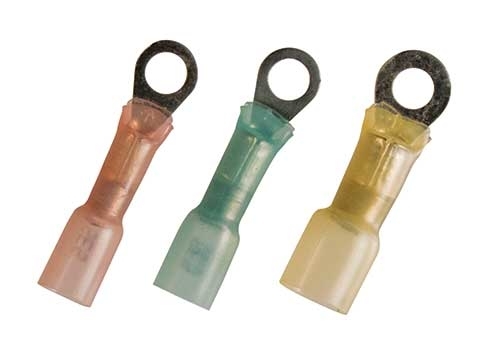

If it's what I remember they used two different connections for the solenoid control wire, one is the original style that used two studs and nuts as shown in service info but they also have a newer design with a single plug in connection like in the image below. If you get the replacement that uses the stud and nut in place of the single pin you need to cut off the plug and replace it with a crimped on ring terminal to use that starter design. Both types are out in parts stores.
This is the process if you use a cheaper connector. Personally it is not the method or connector style I would use on a starter connector that is exposed to the elements.
https://www.youtube.com/watch?v=MhEjz32aEdE
This one shows the process a bit better toward the end of the video except I like to use heat shrink tubing that has a sealant in it to protect the wiring better.
https://www.youtube.com/watch?v=kjSGCSwNuAg
You can also buy ring terminals that have a heat shrink sleeve with sealer in them, but those can be difficult to crimp if you don't have the correct tool and if you damage the heat shrink while crimping you end up cutting it off and doing it again.
