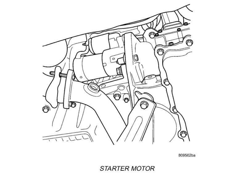

Is the removal and putting it back in similar to the steps you gave and procedure as the question I read regarding removal and replacement? Is there a reason to turn gears to get it in or to use a shim? My starter was good so just putting it back in and clip was partially broke off of the ground wire when removing but was told it would be okay. Since it is just a ground. It is my car I am female and listening to them talk while they are trying to reinstall it. I am freaking out. Please give directions. The information I read was being done from above it looks like, at least for the battery. My battery is in the wheel well.

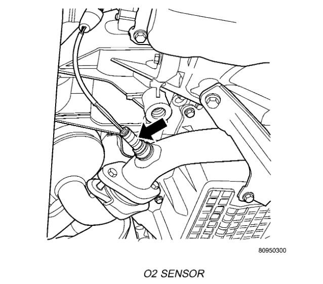

4. Disconnect the electrical connector from the 02 sensor.
O2 Sensor
5. Remove the 02 sensor from the exhaust manifold .

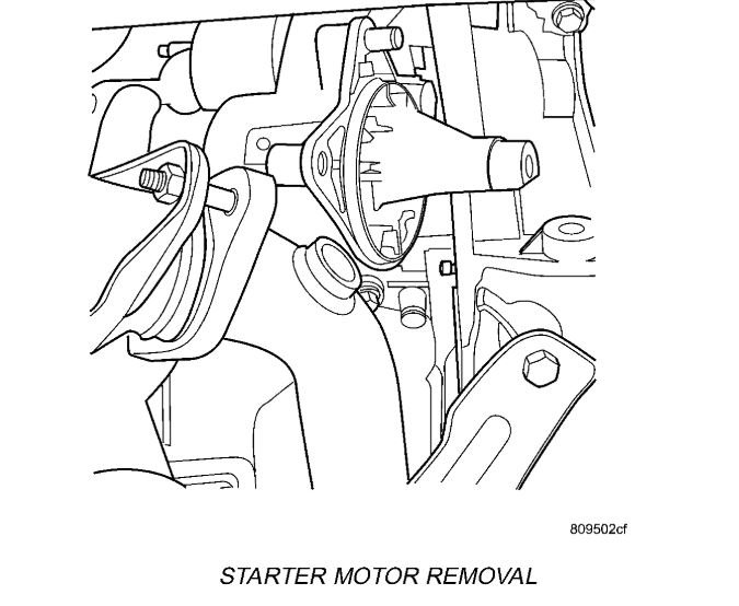

Starter Motor
8. Remove the battery cable from starter.
Starter Motor Removal
9. Remove the lower starter bolt and remove starter.
