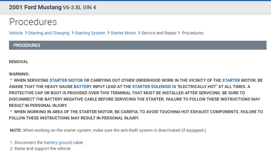

Yes, can you please send me directions on removing my starter? my car won't start, it's just clicking when I try to start it.
Jul 26, 2023 at 11:00 PM
  • 110,244 POSTS

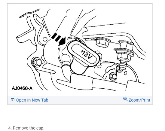

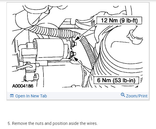

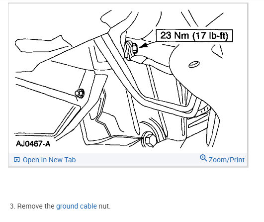

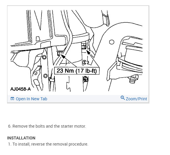

Replacing the starter motor isn't too difficult. Just make sure the battery is disconnected before you start working on it.
To get you started, here is a link that explains how, in general, one is replaced. Take a look through it first, it will help explain things better.
If you look below, I attached the directions specific to your vehicle. Take a look through them and let me know if you have questions.
Take care and let me know if this helps.
