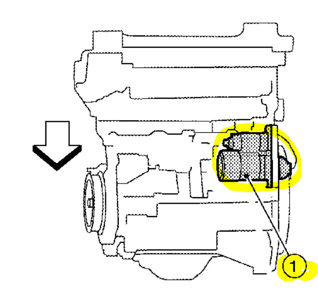

Hi, where can i find the starter to replace it?
Nov 27, 2022 at 3:48 AM
  • 110,244 POSTS
I attached a pic below of the starter location. Note the arrow. It points to the front of the vehicle. If you open the hood, it will be where the engine and transmission are bolted together. It will be below the battery tray.

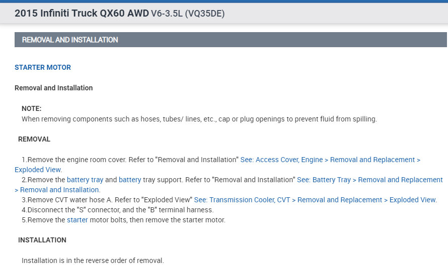

As far as replacement, here is a link that explains in general how it's done:
Remember, make sure the battery negative cable is disconnected prior to starting this procedure.
Pic 2 below are the very vague directions from the manual specific to your vehicle. If you need help with any of the items needing to be removed, let me know.
