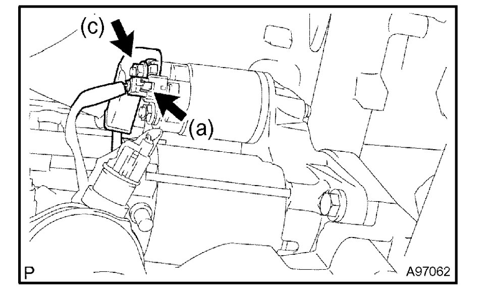

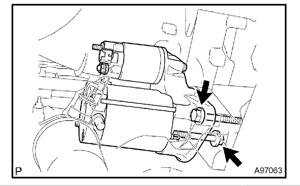

I attached the procedure for you as well as the pictures.
The top bolt you get from the top. you will need to move a harness out of the way and use a 6 inch extension with the 14 mm socket.
Replacement
1. Disconnect battery negative terminal
2. Remove engine under cover rh
3. Remove engine under cover lh
4. Remove starter assembly
a. Disconnect the starter connector.
b. Open the terminal cover.
c. Remove the nut, then remove the starter wire.
d. Remove the 2 bolts, then remove the starter.

He says he can't get his hand in there.
Dec 28, 2018 at 11:46 PM
He? who is that?
you do not get your hand in there, you get the socket with the extension.
Dec 28, 2018 at 11:48 PM
he? who is that?
you dont get your hand in there, you get the socket with the extension.
STEPHBILLD
Removed what we think are the correct bolts but it won't budge.
Dec 29, 2018 at 12:20 AM
Give it a smack with a hammer. if it does not release then you did not remove the correct bolt.
Dec 29, 2018 at 12:27 AM
STEPHBILLD
Yay! His hammer worked. Thank you.
