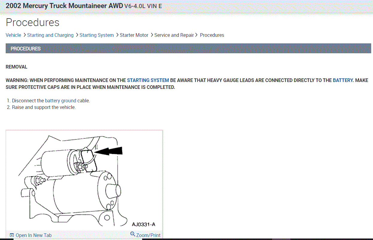

What tools do I need to remove my starter?
2002 MERCURY MOUNTAINEER
2,000 MILES
LOVELOVELOVE
May 3, 2021 at 10:01 AM
  • 110,194 POSTS

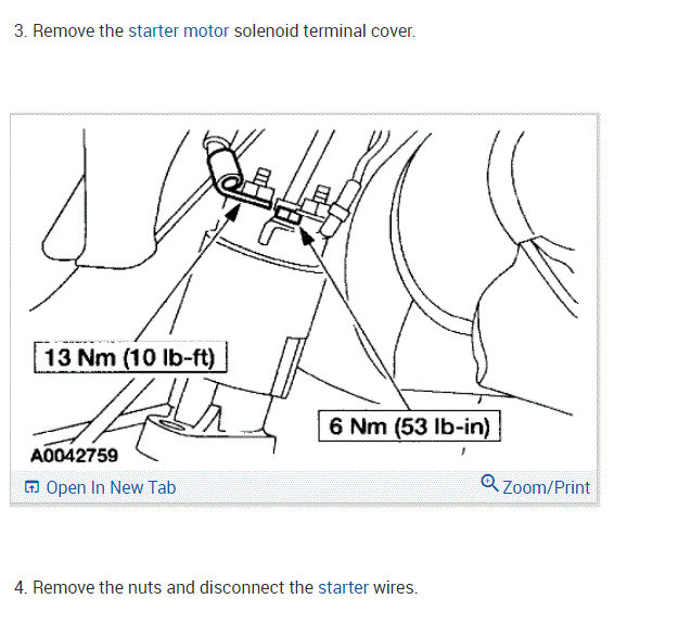

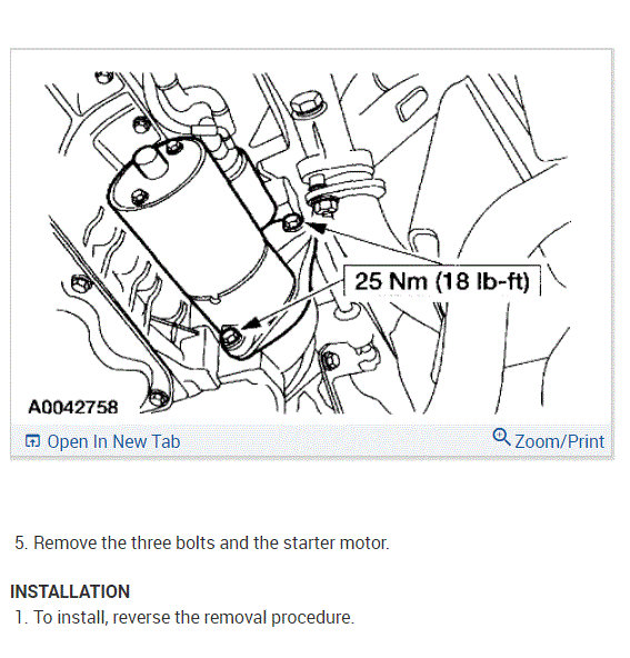

All you will need is a basic socket/ratchet set. Deep well sockets could be needed to remove the wires at the starter, but chances are you will be able to do it without.
One thing I need you to remember, you must disconnect the negative battery terminal before starting to work on the starter. There is a 12v power supply constantly from the battery that can short.
To get you started, here is a link that shows in general how it is done. You can use this to help guide you.

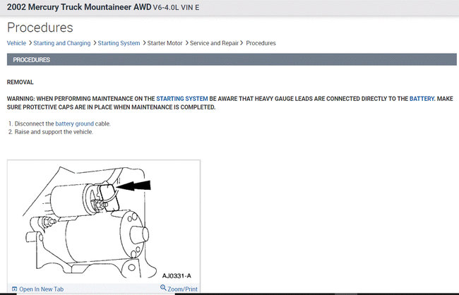

If you look at the attachments below, I provide the directions specific to your vehicle along with pics.
