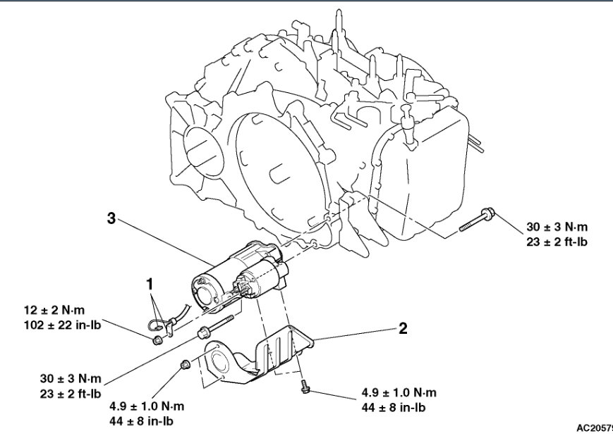

Okay, so i removed the bolts that hold it in place but it still won't budge and remove. what am i doing wrong?

I've attached a picture below of your vehicles starter. It looks like only held in with 2 bolts.You might need a screwdriver or pry bar to wedge it loose.Hope this helps and thanks for using 2CarPros.
