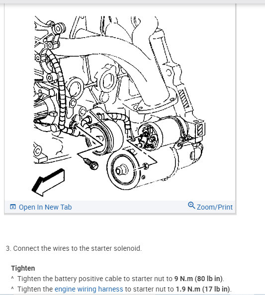

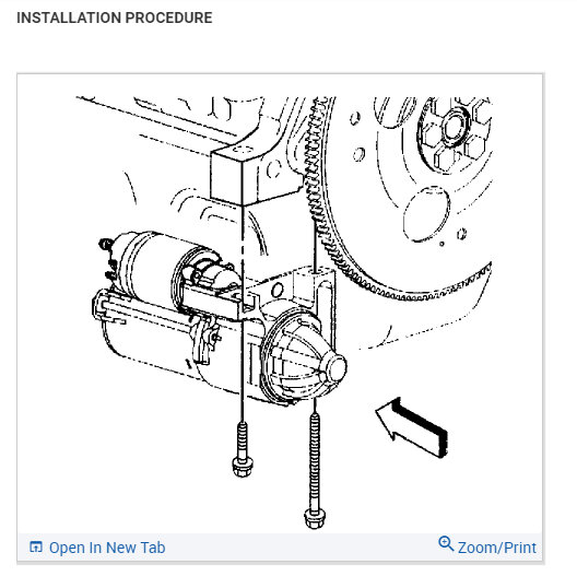

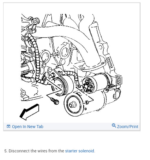

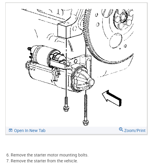

Starter bolts are out but it won't pass through exhaust pipe.
Jan 28, 2023 at 5:27 AM
  • 110,244 POSTS

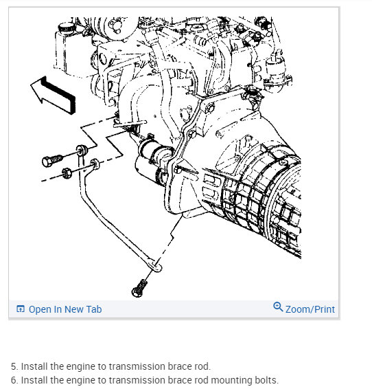

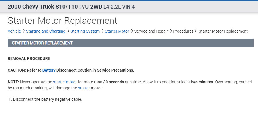

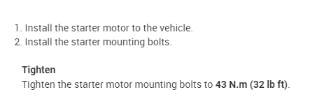

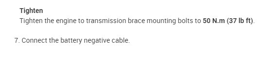

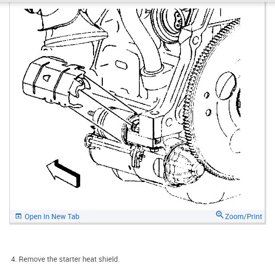

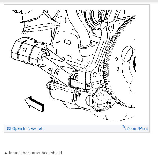

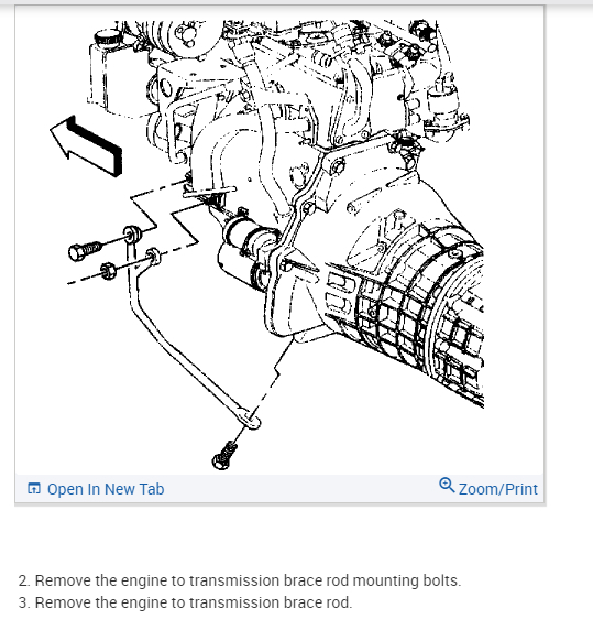

There is a bracket between the engine and transmission that needs to be removed. Once that is out, you can lower the starter downward.
I attached the directions below for you. Take a look through them and let me know if they help.

On my S10, there's no bracket between engine and transmission concerning starter removal?
Jan 30, 2023 at 3:43 AM
  • 110,244 POSTS
That's odd. By chance, could you take a pic of what is obstructing you from removing it? According to two manuals, that is what needs to be removed, but if it isn't there, that certainly isn't the issue.

there isn't a bracket or a shield and exhaust looks custom. Thanks for help.
