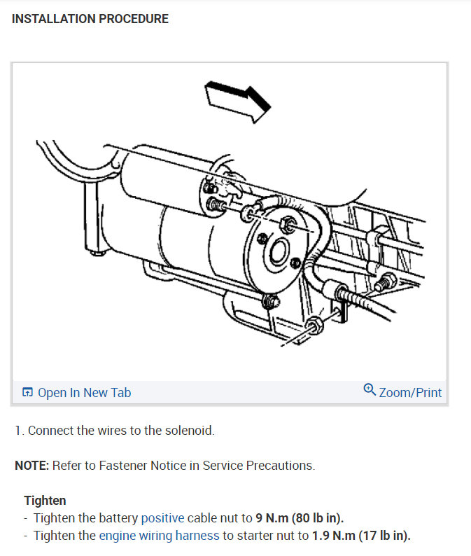

how do i remove the starter from the chevy s10 truck, 6 cylinder, 2 wheel drive
Jan 1, 2010 at 5:26 PM
  • 110,194 POSTS
Disconnect the battery, remove the wiring from the starter, then there are two bolts that holds it to the engine / transmission. This guide will walk you through the steps with instruction in the diagrams below to help you with your car.

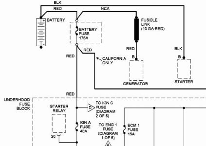

changed bad starter put new one on now the there is voltage problems liike the altanator is bad is there a wire from starter to altanator
Nov 25, 2020 at 5:38 PM (Merged)
JDL
  • 16,098 POSTS
https://images.2carpros.com/forum/automotive_pictures/170934_2000s10_1.jpg
As you can see from the power distribution diagram, there is no direct connection.

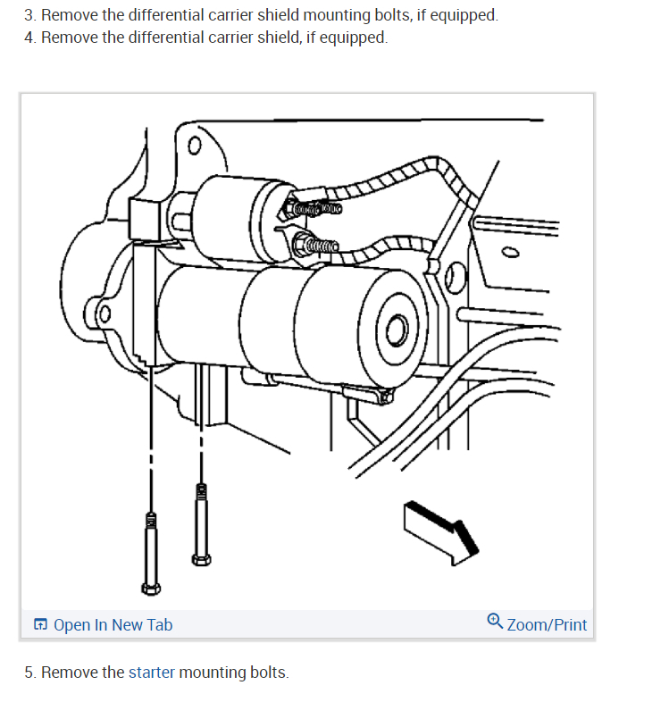

Have removed all mounting bolts and brackets from starter on 1994 chevy s-10. Starter is hanging loose but am unable to remove it from vehicle. Do I need to remove transmission bell housing (flywheel cover) to remove starter or is there another trick to this?
Nov 25, 2020 at 5:41 PM (Merged)
  • 110,194 POSTS
Nothing else needs removed. If you removed the mounting bolts, it should come out.
DALIXIN
I have a 1994 s-10 4x4, manual, and there was two ways i could get the starter out. either remove the bell housing of the transmission or take the the solenoid off the starter.
With the solenoid on the starter the assembly could not come out between the frame and bell housing, but if you removed it there would be enough room to remove it.

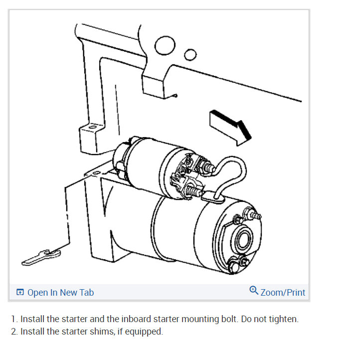

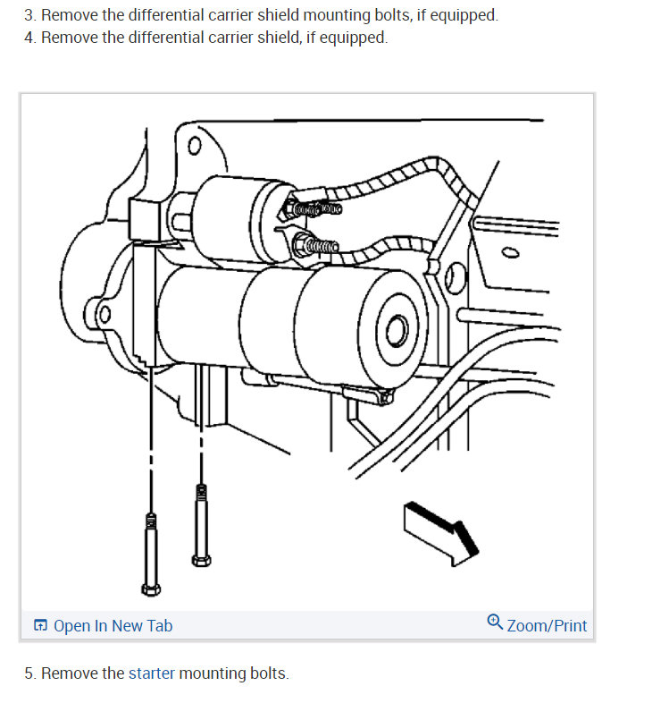

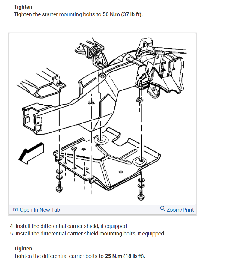

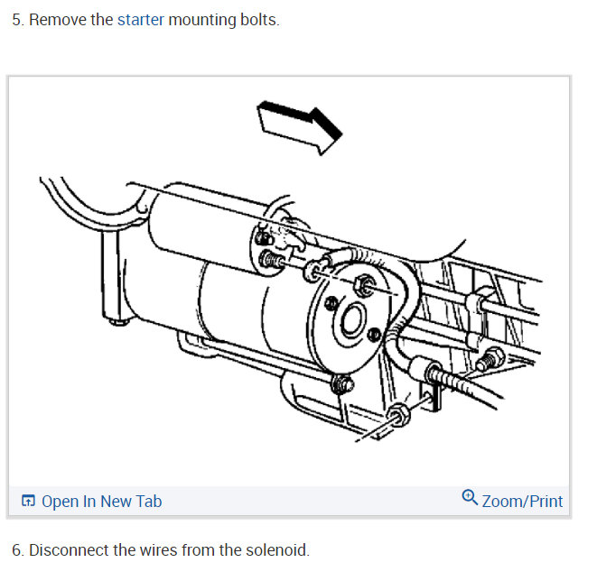

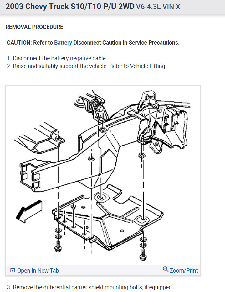

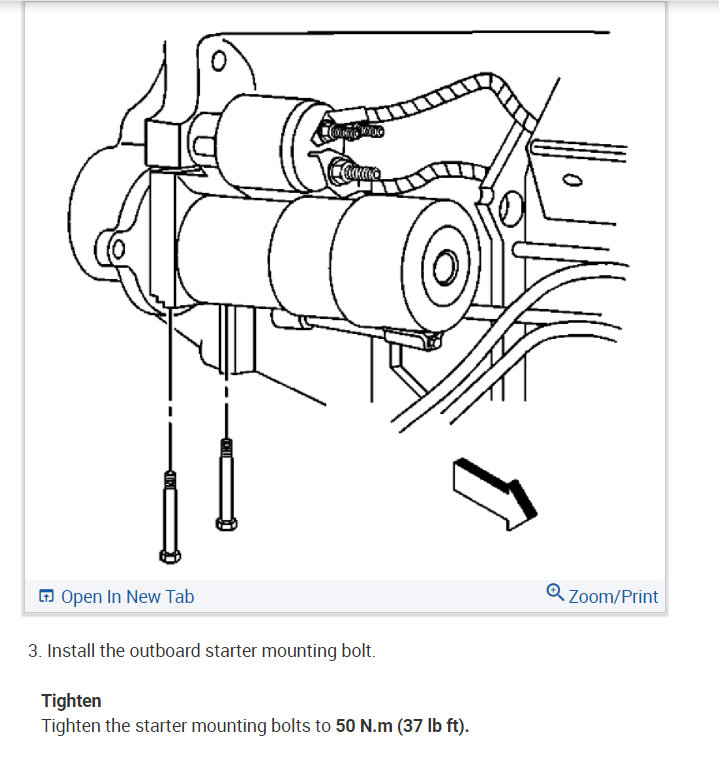

how do i remove and install the starter
MERLIN2021
  • 17,250 POSTS

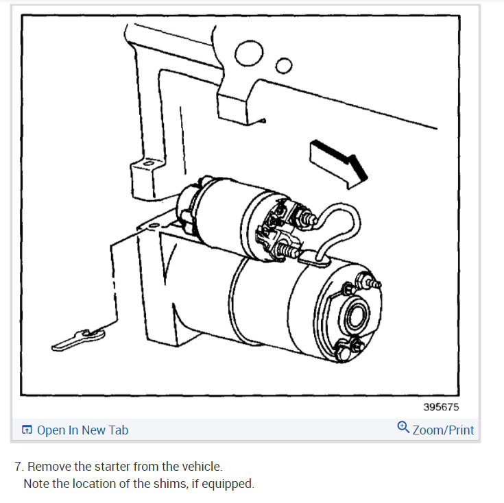

Remove the negative(-) battery cable, then remove the wires at the starter, remove the two bolts holding the starter, be careful the starter is HEAVY! use caution removing the last bolt. Install is the reverse of the proceedure!
https://images.2carpros.com/forum/automotive_pictures/62217_Starter_2.jpg
