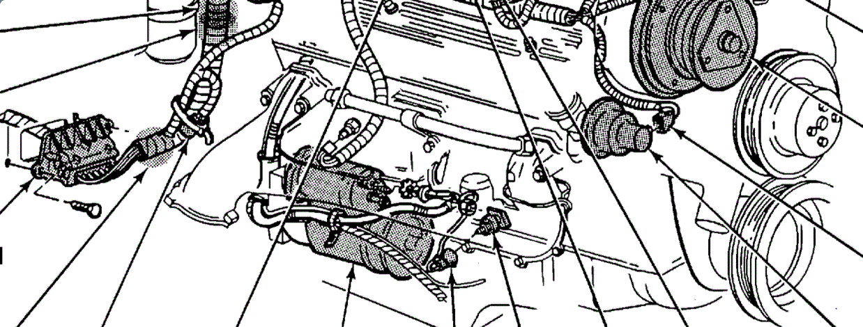

There is bolt in the way of taking the starter out. Not sure what it goes to, and I don’t want to take that bolt out if I don’t need to. What is in the way of taking this starter out ?

Can you upload a picture of the bolt?
It could be the rear support for the starter.
I attached a picture for you. Can you tell me the location of the bolt?

I was able to get it out. I had to use a really short socket (15mm) and use a couple extensions on it to get it to loosen up. Thanks for getting back with me.
