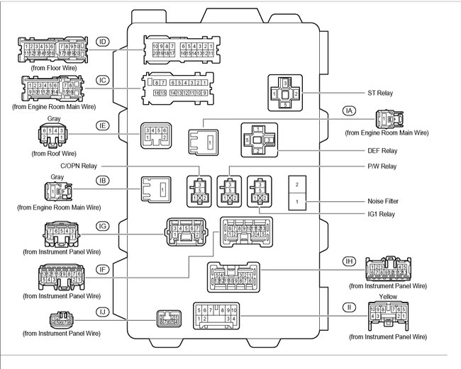

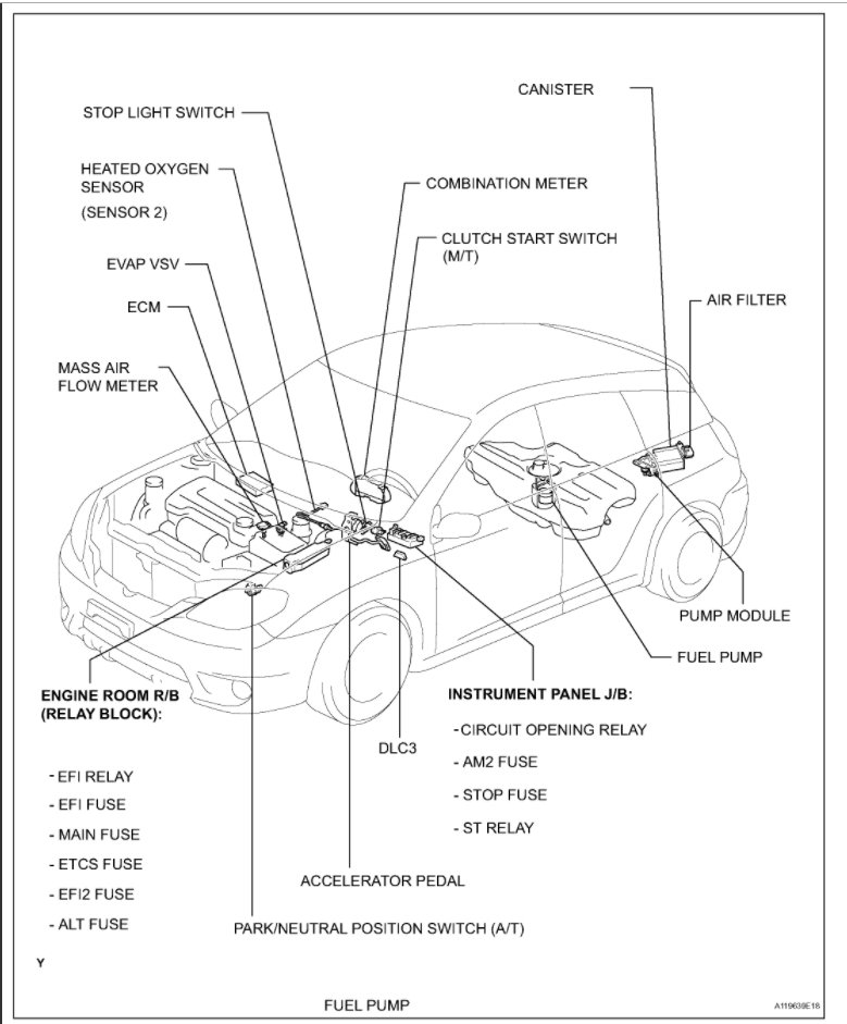

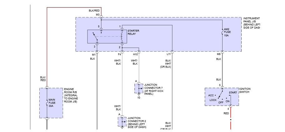

Replaced battery and starter. will not crank. checked all fuses, checked power at the ignition wire to starter. No power. Turn key, nothing. Everything is going back to the starter relay. Need location of starter relay. Am I on the right track?

Location of relay. Behind left side of dash in the power center

The starter relay is located in the PDC. Here is a guide and diagrams (below) of the locations of the starter relay (ST relay):
