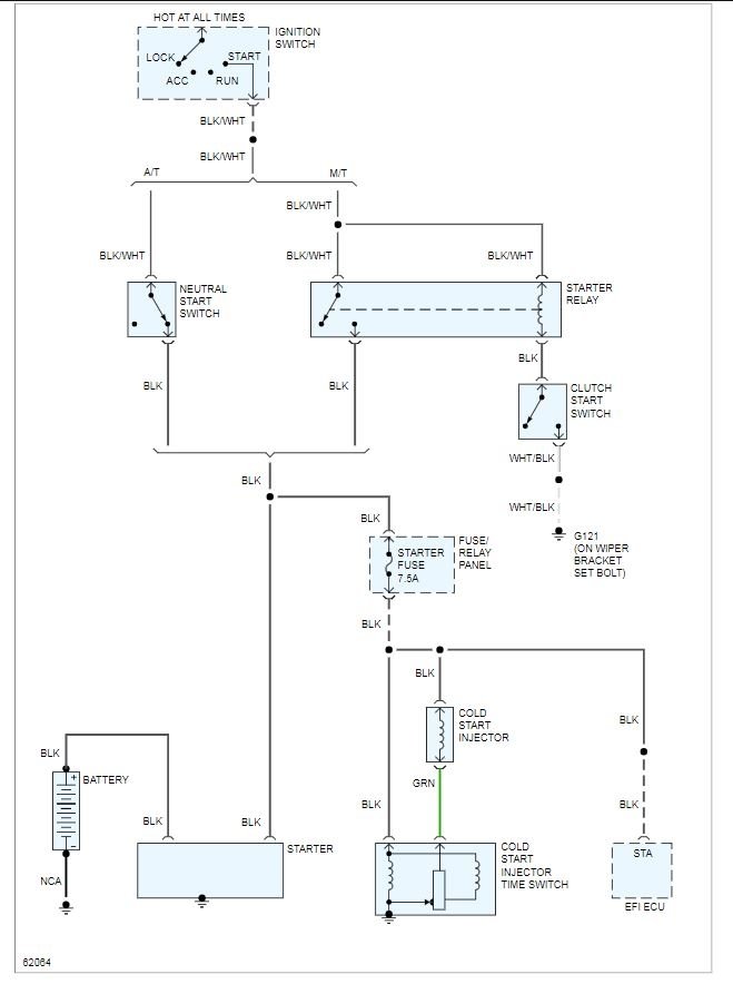

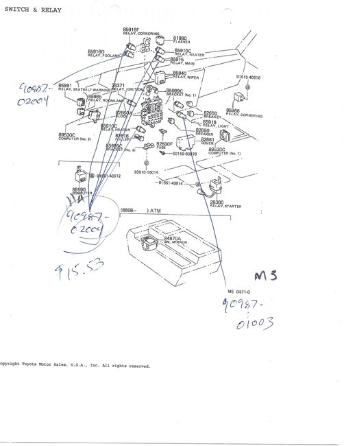

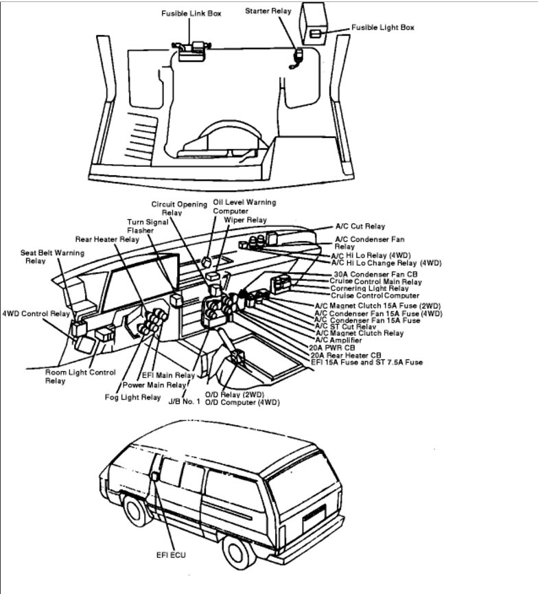

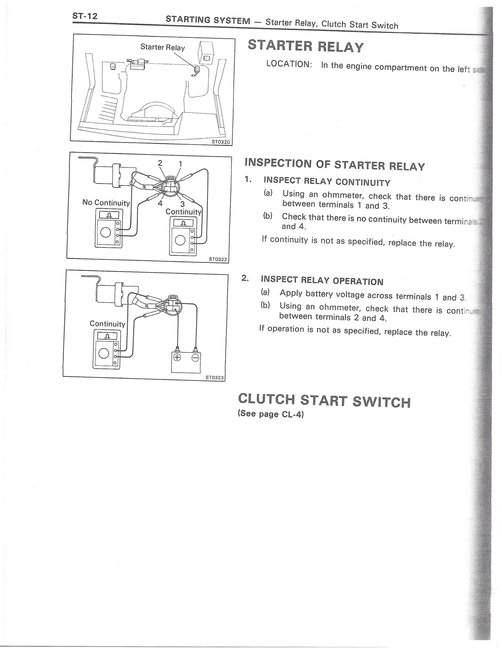

the factory service manual shows the starter relay to be in the engine compartment behind the air flow meter under the driver's seat, but it does not appear to be there. can you help me find it?

Yes this is what I have. Kind of the same thing of have. Might have to go old school and check the wire color at the starter solenoid and look for the same color at the relay.
Attached below is the relay location and the wiring diagram
