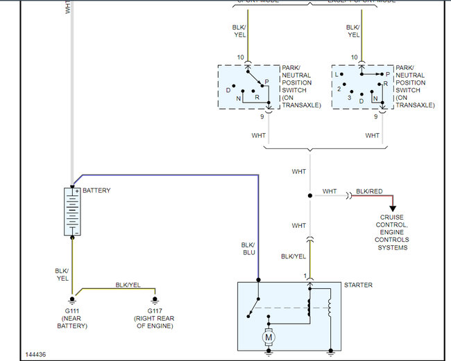

I just recently replaced my starter, alternator and battery. battery terminals are all clean and I have 12v going to my starter but only 8v going to my starters solenoid, so the car has trouble starting and turns over very slowly, I suspect the ignition switch or starter relay but can not find the location of the starter relay. PLEASE HELP
Oct 29, 2020 at 1:27 PM
Good morning,
I attached a wiring diagram for you to view.

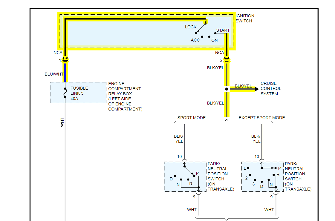

You will need to check the voltage coming out of the switch on the wire I attached.
From the switch, it goes to the park/neutral switch and then off to the solenoid.
There is no relay in the system at all.

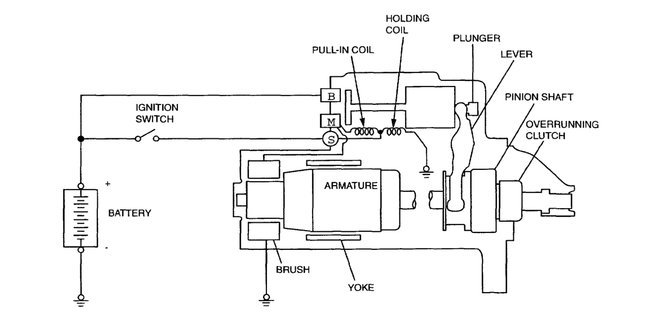

GENERAL DESCRIPTION
If the ignition switch is turned to the "start" position, current flows in the coil provided inside magnetic switch, attracting the plunger. When the plunger is attracted, the lever connected to the plunger is actuated to engage the starter clutch.
On the other hand, attracting the plunger will turn on the magnetic switch, allowing the "B" terminal and "M" terminal to conduct. Thus, current flows to engage the starter motor.
When the ignition switch is returned to the "on" position after starting the engine, the starter clutch is disengaged from the ring gear.
An overrunning clutch is provided between the pinion and the armature shaft, to prevent damage to the starter.
