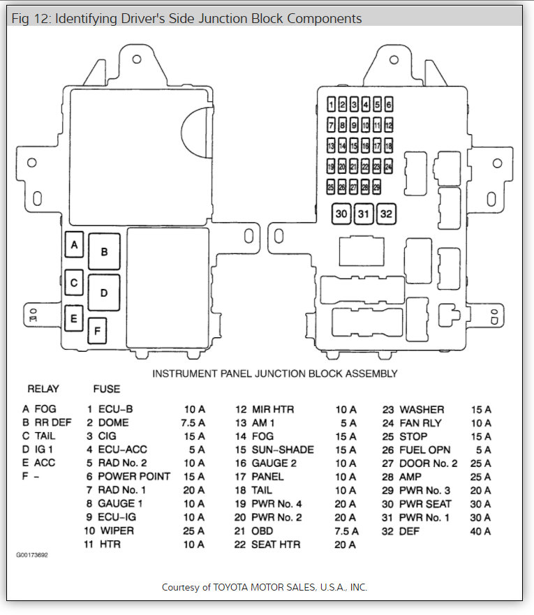

Had a bad starter replaced it but I tried to take off the relay and broke the top casing. Now the car cranks but doesn't start. I bypassed relay now cranks and no start. Also check engine light does not come on and windows doesn't work. Did I ruin my relay and is it multi-functional?
Sep 6, 2022 at 4:40 AM
  • 55,433 POSTS

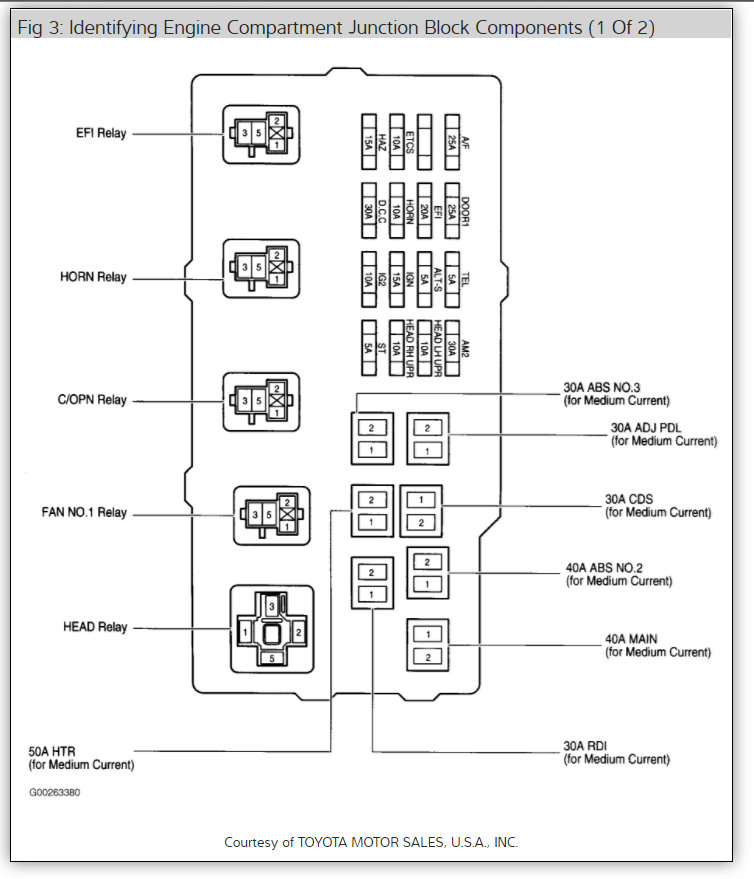

There are two fuses associated with the starter system that need to be checked, the first is AM2 30 amp in the under-hood relay fuse panel and the other is AM1 5-amp fuse in the left side of the dash fuse panel.

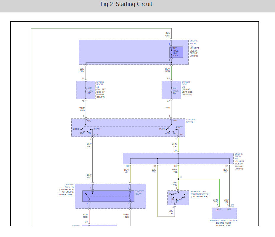

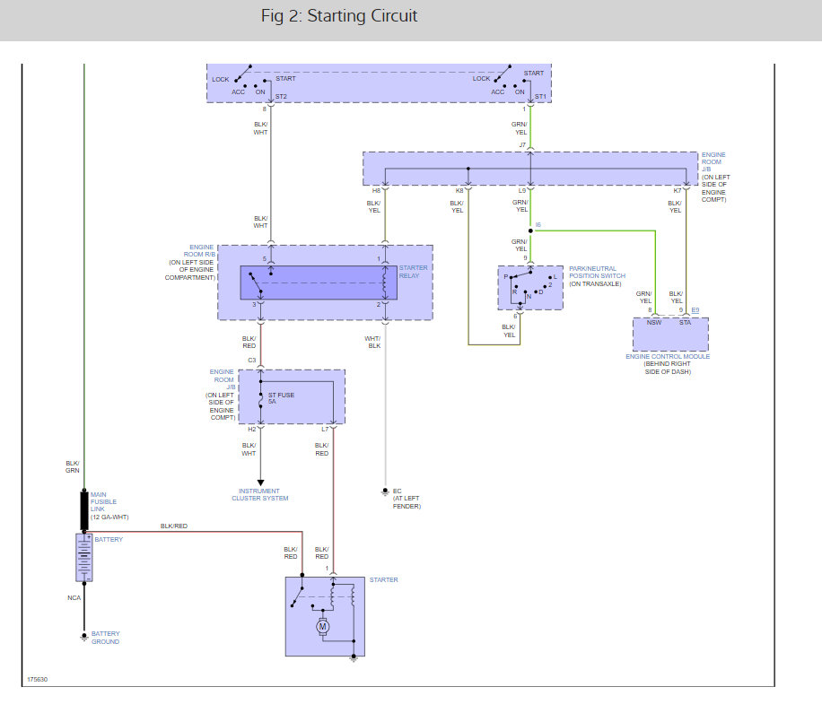

Here is a guide to help and thew starter wiring diagrams so you can see how the system works:

I have changed the blown fuse for the starting system, but it is still cranking and not starting. Before the starter went out, I didn't have any issues. It always started on the first try. Any ideas?
