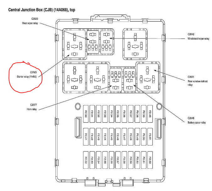

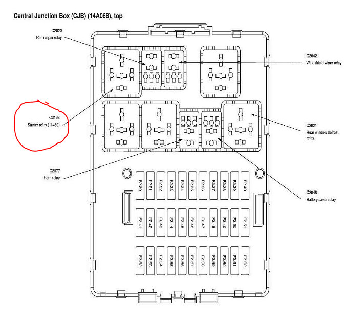

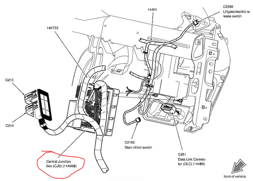

Where is the starter relay for this car? my distribution box they have Rl then numbers.
Nov 11, 2019 at 3:42 AM
DANNY L
Experienced Mechanic
5,648 POSTS
Hello, I'm Danny.
The starter relay is located in the central junction box.Here is a tutorial that can show you how to test a relay:
I've attached 2 pictures below showing its location and circled in red.Hope this helps and thanks for using 2CarPros.
