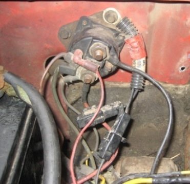

This is a picture of an 1987.
The starter cable is always all by itself on a fat terminal.
The positive battery cable and anything constantly requiring 12 volts are all stacked together on the other fat terminal.
"S" wire snaps onto the little terminal, the little terminal is normally labeled as "S" on the solenoid body.
The other little terminal is "I", if it is used (sometimes it is not) , it feeds back to the coil to sort of boost its power (full battery voltage)while the starter is robbing battery power from it. It shuts off as soon as the the key is released from the "start position".
Are you wired up like this?

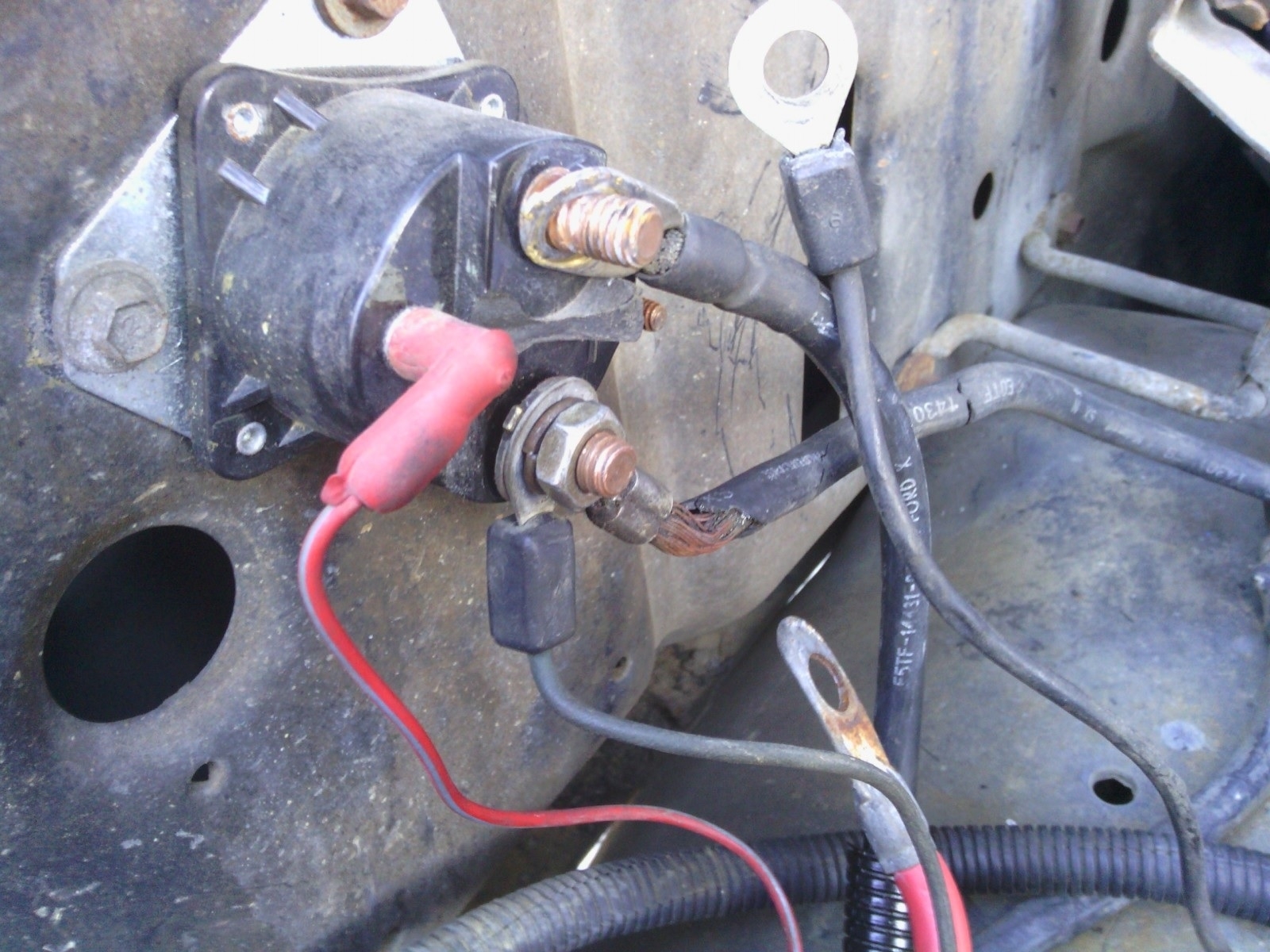

Kind of helped but I have just three terminals, two fat ones (one for positive battery post plus one loop ended smaller wire that I do not know where it went; and the other fat post was connected to the battery post that went down to the starter along with two loop ended (metal connectors) smaller wires that I do not where they went. And then one small, threaded silver (not copper) post that was connected to a rubber coated snap on wire that, again, I do not know where it went. When I crossed one of those three looped smaller wires and placed it on the wrong fat post I think that is what caused the spark and I think screwed up wherever it was supposed to go. When I switched one of those three smaller wires and put it on the other post that is when the motor turned over and ran for a second. When it shorted I must have damaged wherever the wire was supposed to go as if the ignition was now burned, or if one of those smaller wires was supposed to trigger something having to do with the fuel supply. I know I cannot make it really clear. I had it towed to the garage and hopefully tomorrow I will learn what the problem is. If you are interested I can write back to this address and tell you what it was.

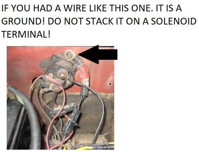

The one fat post is the starter wire only!
The rubber elbow one goes on the little "S" terminal (only place it can go!).
Everything else stacks on the other fat post with the battery cable.
Unless;
You had a ground wire as in my picture, hook it to ground.
Only you can remember if this was the case.
Once it hooked up right, do you have power where you are supposed to?

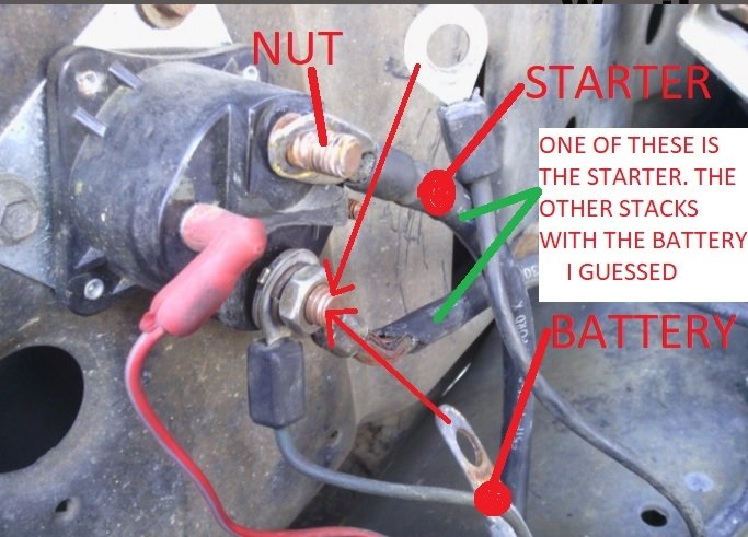

It looks like your picture except I do not have the upper wire where the black arrow is-it does not exist. If that ground is attached to one of the sheet metal screws that holds the relay to the fender it is not there no wires go to those two anchoring screws. In the directions which I, unfortunately, just glanced at it says to make sure that the fender wall and back of the relay are really clean as that is the ground. On mine the starter wire was not the only wire attached to the fat post-there are two smaller wires also, so three wires in total to the negative fat post and two wires to the positive post. I do not know where you are and how late it is but I will try to quickly find a picture representing mine on a Google image search.

Roger on a picture.
The solenoid does not have a positive and negative post!
It has a post in which the positive cable connects to.
The other post (for the starter) is dead, but becomes "positive" too, when the solenoid activates. This temporarily makes the starter turn/ crank until you release the key.
If you put anything else on the starter side, it will only get powered while you are cranking the vehicle, then it will shut off when you release the key.
Only the starter, by itself, should be on the other fat post. (it really does not matter which post)
Anything else requiring energy should be stacked with the battery cable on the opposing fat post from the starter.
Just read yours, modified your picture.

Well, you were right. One fat post on the relay should only have had one connection-the heavy starter cable. All others went to the other fat post including the positive battery cable. Took him five minutes to fix it and charged me nothing. Thanks again.
