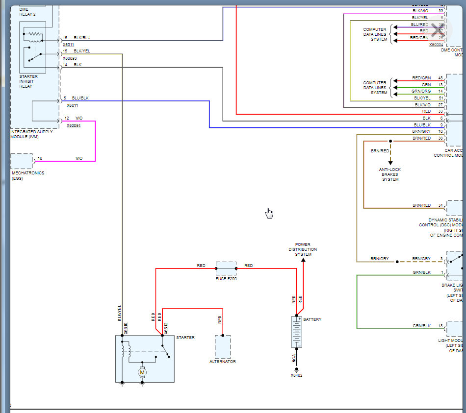

where is the starter relay located?
Jun 1, 2021 at 3:59 PM

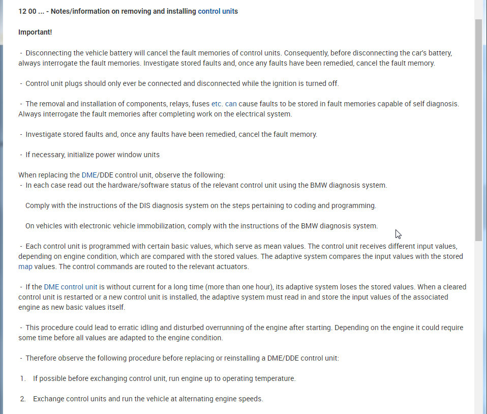

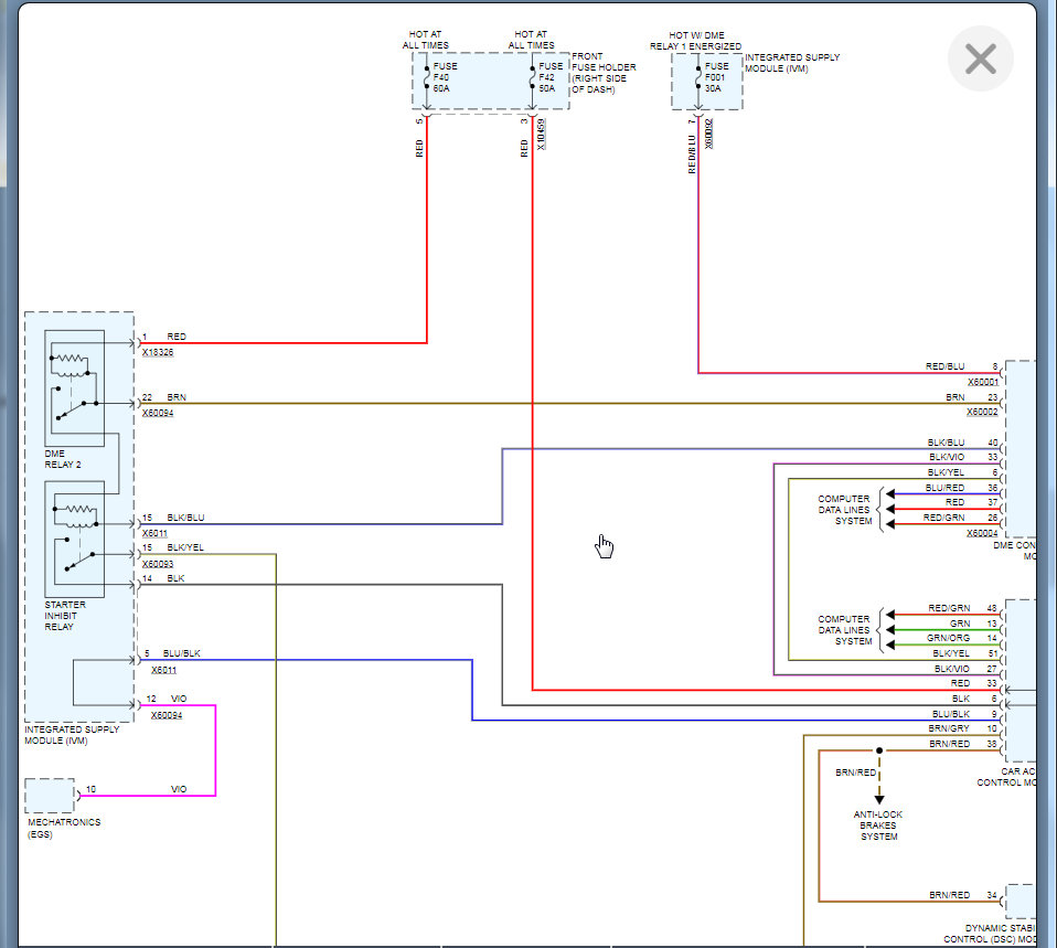

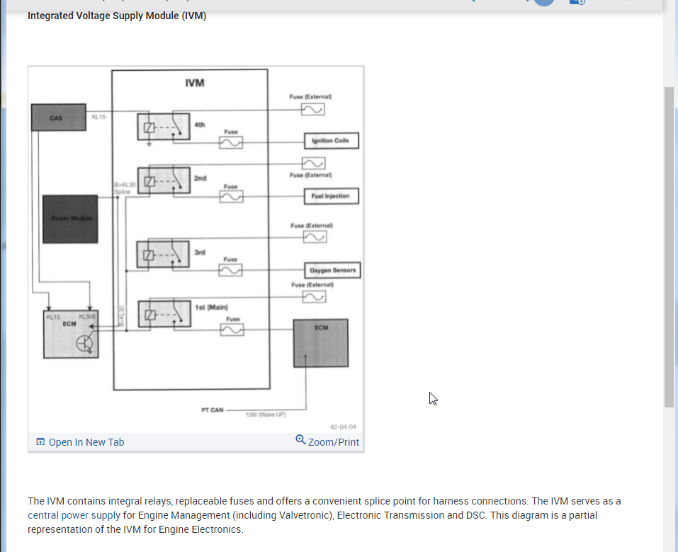

You do not have a traditional relay. These relays are part of the integrated voltage supply module and are not replaceable. As you will see it says below that these relays are integral which means they are not replaceable.
Take a look at the info below and let us know if you have other questions on this. Thanks
