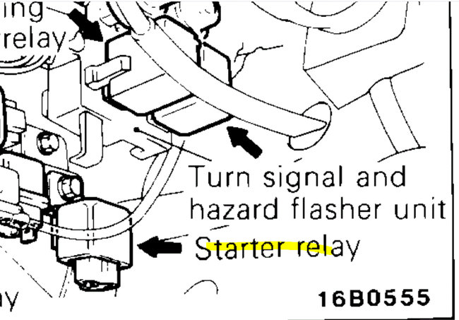

Where is the starter relay located?
1994 MITSUBISHI MIGHTY MAX
100,000 MILES • 2.4L • 4 CYL • 2WD • AUTOMATIC
PACIFICISLANDER
  • 239 POSTS
Trying to locate the starter relay if any or its the main relay that powers the starter.

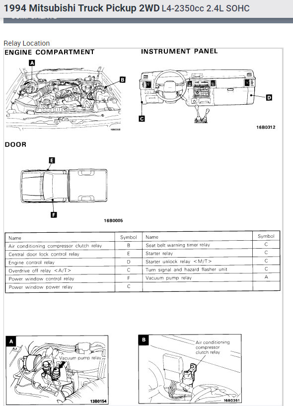

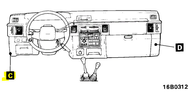

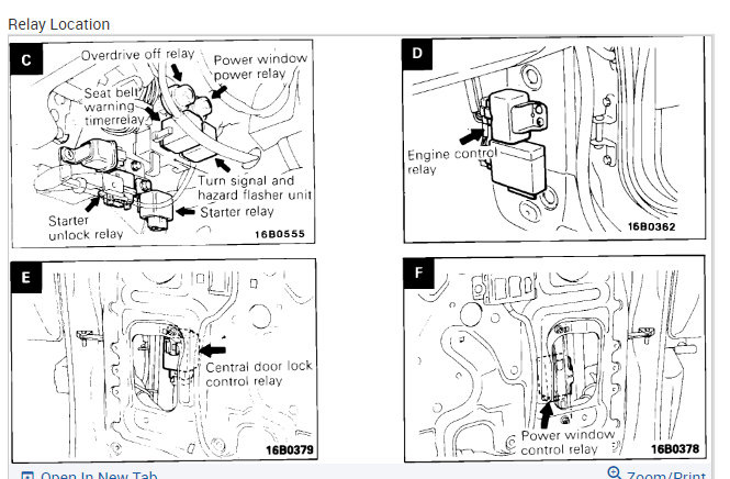

The starter relay is located on the fuse box left side of the dash (see diagrams below). I have also included all of the fuse block diagrams for your reference.

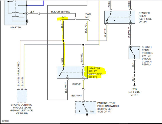

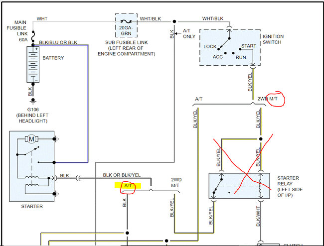

There is a starter relay. It's located under the dash on the left (driver's side). First, I attached the starting system schematic for your vehicle. There was only one pic, but I had to cut it in half to make it readable. I did overlap it so you can follow from one to the next.
The next pics show the location of the relay.

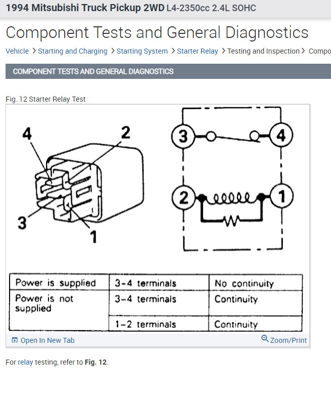

If you suspect the relay is bad, here is a link that explains how to test one.

Thank you so much Gentlemen sure appreciated. Followed the EWD and it end up with P/N switch being the culprit, Now it's time to hit the road
SQM and Joe, thanks and take care.
