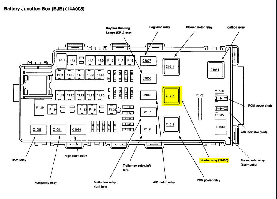

Will not crank with key
2004 MERCURY MOUNTAINEER
150,000 MILES • 4.0L • 6 CYL • 4WD • AUTOMATIC
DRAMP
Jumping starter with wire will crank. Key won’t crank. Replaced starter and have same problem. I cannot locate a relay or fuse as not on panel and don’t have owners manual. Diagrams I’ve found online don’t seem to be correct..

Hi Dramp,
I attached the location of the starter relay. It is in the battery junction box under the hood.
Let me know if you need more help but I would agree this sounds like the issue. Thanks
