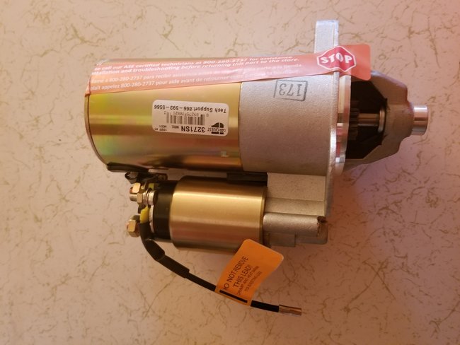

I recently bought a new starter. I removed my old starter and noticed that my new starter comes with a lead attached that my old starter does not have. What do i do with that new wire coming from the new starter?

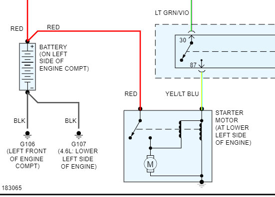

I've attached a picture below of what your wires should like like on your truck.The thick red power cable and a smaller yellow/light blue wire.If you can can you takes pictures of the starters and upload them here? Also, Here is a tutorial to view on starter replacement if it helps:

This is the starter i bought. i had to turn in the other one for a core fee. but the extra wire on this starter i do not need because it was not on the one i removed. I bought a starter off Amazon but it didn't work either and it had the same cord on it.

Just remove the extra wire, it is not for you application. It looks like a good quality rebuild though, nice work. Please let us know if you need anything else to get the problem fixed.

Hi mightyguinn5, Thank you for the donation. The wiring diagram shows only 2 wires, Red which is battery cable, terminal "B". Yellow/Light Blue is for the starter solenoid, Terminal "S". What is the color of the 3rd wire that you are refering to?

If it uis used for tapping power source, it would be attached together with the Red wire.

Thank you for your research. I have located the 2 wires that will attach to terminals B and M per your diagram. I cannot locate the wire that will need to reconnect to terminal S. Any ideas?

There should be no additional wires attached to Terminal M. Any additional wire should be attached to Terminal B.
Is the harness stock or do you have any additional starter solenoid wire?
