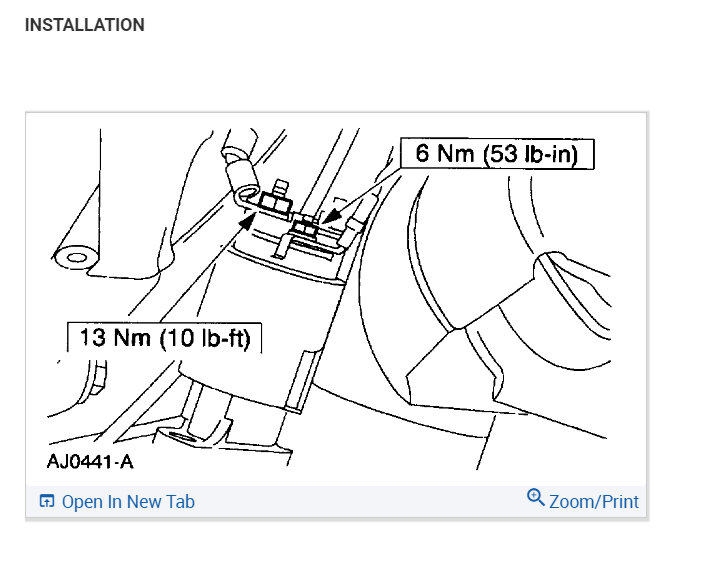

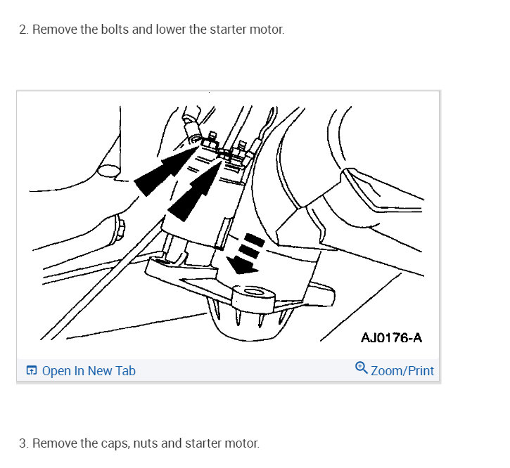

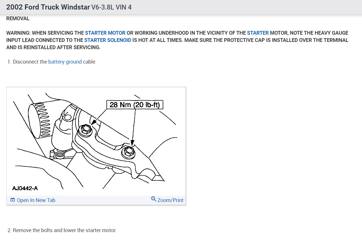

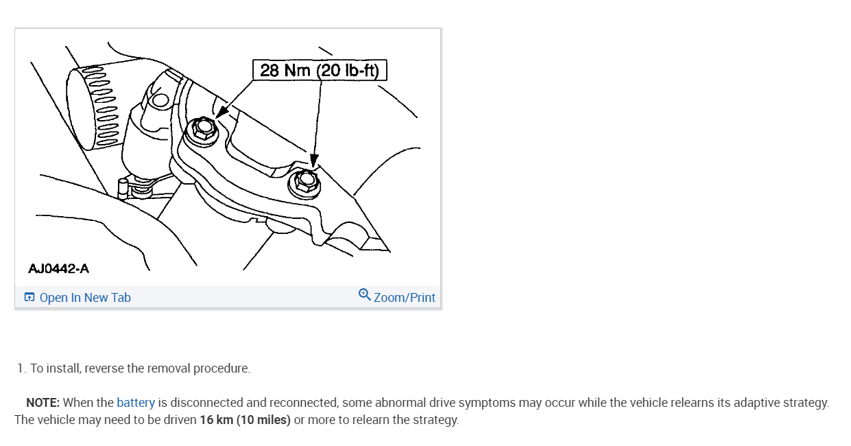

Replaced starter now I go to start it starter grinds.
Mar 21, 2023 at 4:05 PM
  • 55,721 POSTS
It sounds like you got a bad starter, I would take it back and get another one. here are the instructions on how to replace the starter in case you need it. This guide can help you step by step:
