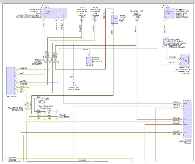

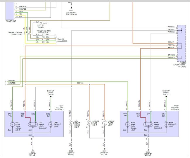

Compression isn't the issue. Pretty sure it's either electrical or gas related. Also, gear shift won't shift from park to neutral without using shift release slot. Brake lights aren't working. The fuses appear to all be good. About to the end of my rope with the care. :-D
Jan 2, 2020 at 10:58 AM (Merged)
  • 55,721 POSTS
Hey FMARSH2005EL,
There is a power junction block and a tail light relay that could be causing the problem, here is a wiring diagram that should help you test for power along the circuit.
Run some tests and get back to us so we can continue helping you.
Best, Ken
