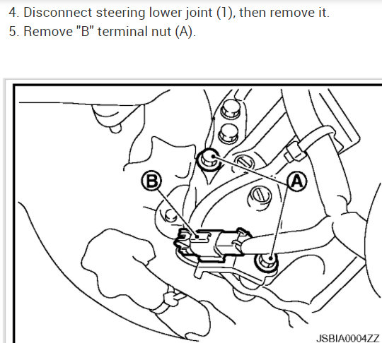

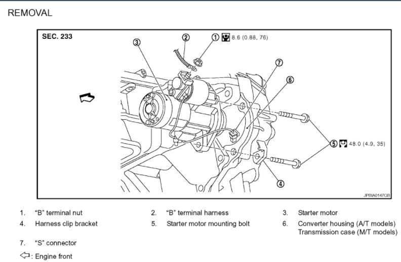

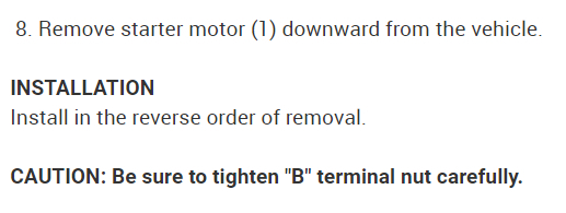

I need the full service procedure for the starter replacement and any tips to do it easier if there is.
Dec 20, 2020 at 3:10 AM
DANNY L
  • 5,648 POSTS
Hello, I'm Danny.

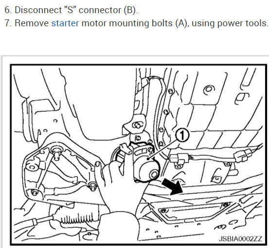

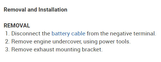

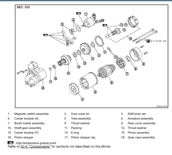

Here is the information you requested. Once you remove the starter motor from your car you can take it to any local auto parts store and they will test it for free. Here is a tutorial showing how to remove and replace a starter motor:

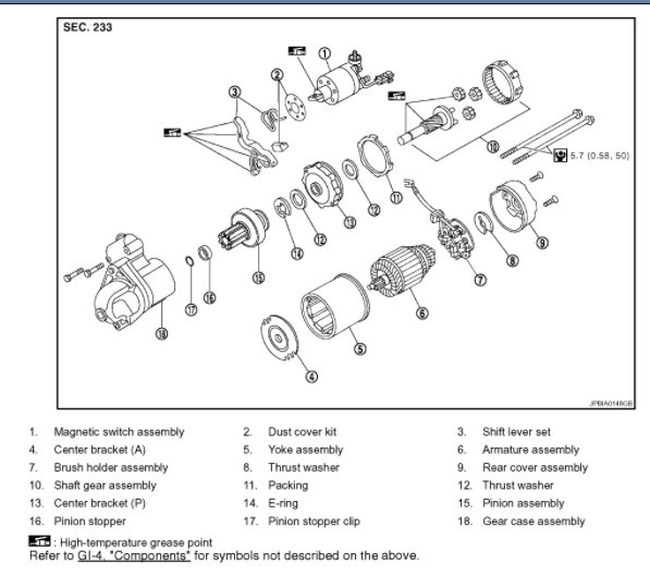

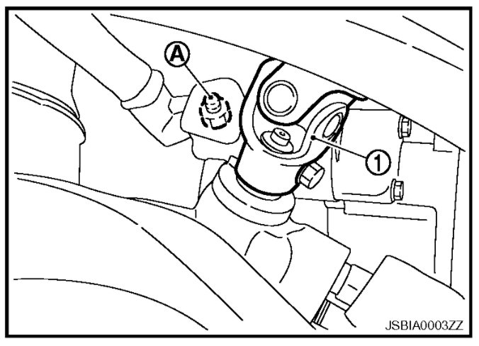

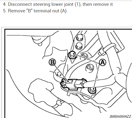

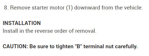

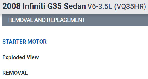

I've attached picture steps below on starter motor replacement for your Infiniti. Hope this helps and thanks for using 2CarPros.
Dec 20, 2020 at 4:17 AM
SKOOTER24
  • 275 POSTS

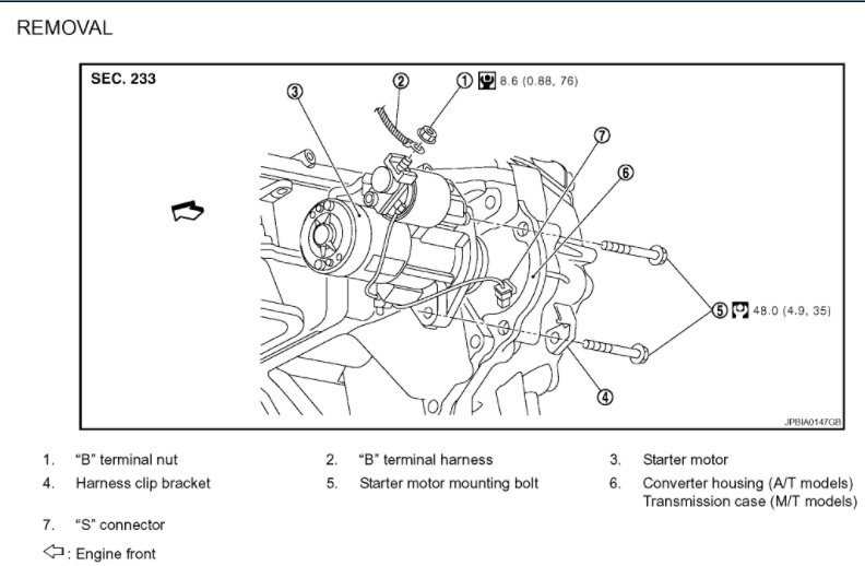

Are the numbers the torque specs?
Dec 20, 2020 at 4:22 AM
SKOOTER24
  • 275 POSTS
I can't tell if there foot or inch pounds.
Dec 20, 2020 at 5:46 AM
DANNY L
  • 5,648 POSTS
Hello again.
Sorry, I couldn't tell what those numbers were either. The correct torque specification for you starter motor bolts are 35 Ft. Lbs. Hope this helps and thanks again for using 2CarPros.

Can I rebuild it ?
Dec 22, 2020 at 1:37 PM
DANNY L
  • 5,648 POSTS
Hello again.
Not sure about that. You would have to search the internet about that. You can get a rebuilt starter for $100.00 and a new starter for $150.00 at auto parts stores. I've only rebuilt alternators. Hope this helps and thanks again for using 2CarPros.

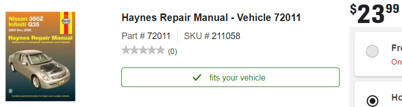

What would be a good way to get the manual for this vehicle?
Dec 23, 2020 at 3:43 AM
DANNY L
  • 5,648 POSTS
Hello again.
The companies Haynes and Chilton make repair manuals for your car. I've attached a picture below of a Haynes manual from the AutoZone auto parts site. Hope this helps and thanks again for using 2CarPros.
