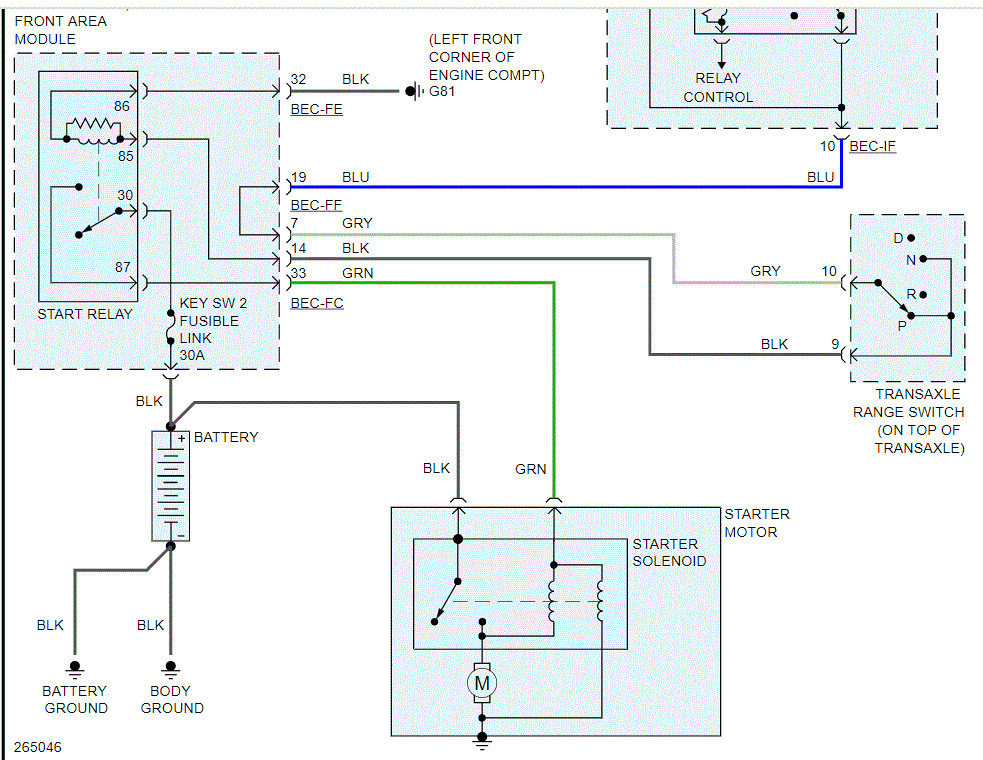

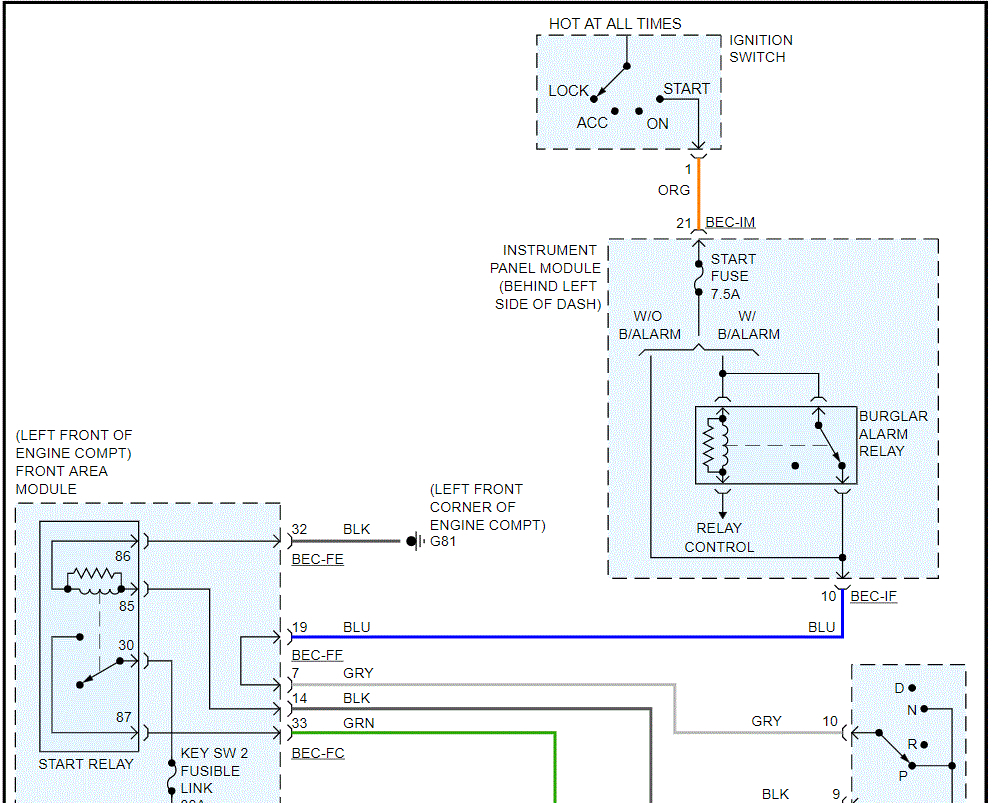

No clicks/nothing. Battery verified as fully charged and good. I sent a positive lead into pin 87 on the relay and have nothing also. I have no idea where location of the starter is and the wiring diagram i can't find anywhere. Anything else i should be checking?

Have you checked fuses and the starter relay?

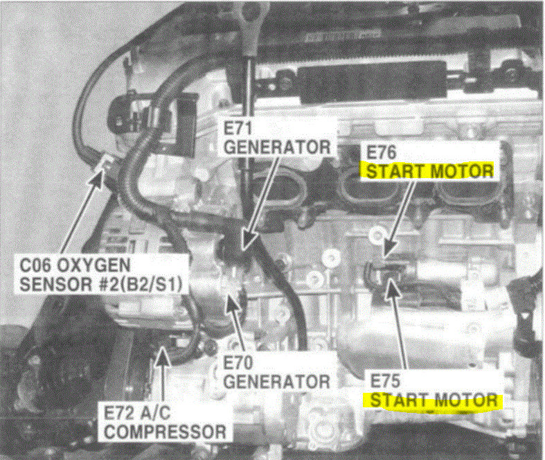

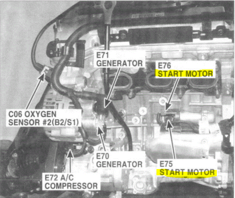

First, pic 1 shows the location of the starter.

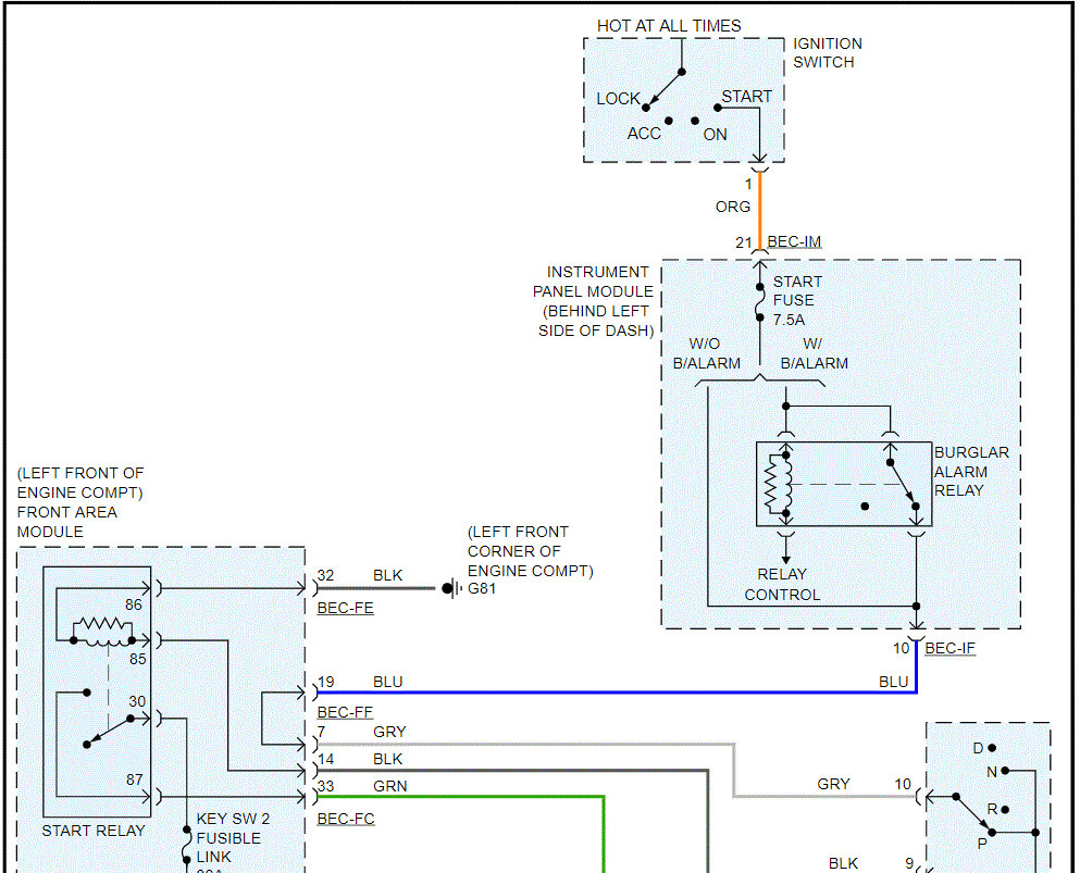

Pics 2 and 3 show the starting system wiring schematic. I had to cut the pic in half so you could read it. I did overlap them so you can follow them.
What I would do is check to see if there is power to the smaller wire on the starter when the key is in the start position. You will need a helper for that. If there is, the starter is bad. Here is a link that shows how it's done:

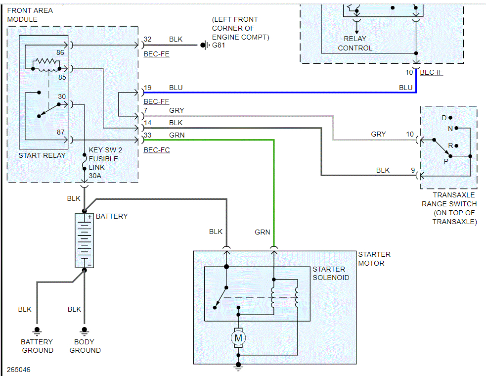

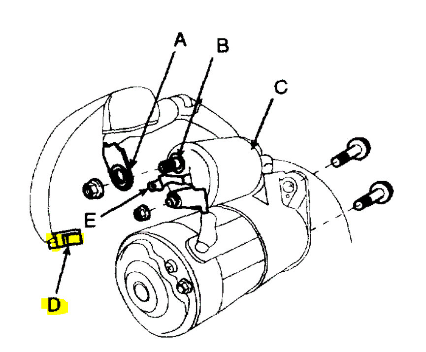

If you find the starter is bad, here are directions for replacement. The attached pic correlates with the directions. When you look at pic 4, I highlighted the wire that should get power with the key in the start position. Remember, the larger wire has 12v at all times.

STARTER
REMOVAL
1. Disconnect the battery negative cable.
pic 4
2. Disconnect the starter cable (A) from the B terminal (6) on the solenoid (C), then disconnect the connector (D) from the S terminal (E).
3. Remove the 2 bolts holding the starter, then remove the starter.
4. installation is the reverse of removal.
5. Connect the battery negative cable to the battery.

Feb 18, 2021 at 10:58 AM

You nailed it. Starter is toast. Able to get splash shield off it, But looking at it , it looks like i would have to remove an engine mount or drop the exhaust to get it out. Took 20 minutes to wiggle splash shield out. But will figure it out. Any idea if it can wiggle out the top somehow?
