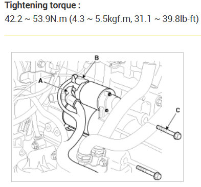

what cause starter to spin but want crank the engine all the time? sometime i have to try 3 or 4 time and sometime the Bendix will engage and then disengage why?

Most of the time it will be a bad starter motor, but once the starter motor is out use a flashlight to check the teeth of the flex plate. Here is a guide to help you step by step with instructions for your car in the images below.
https://www.2carpros.com/articles/how-to-replace-a-starter-motor/
You will need to remove the air box and throttle body. Check out the images (below). Please upload an image or a short video in your response, so I can see what's going on.
