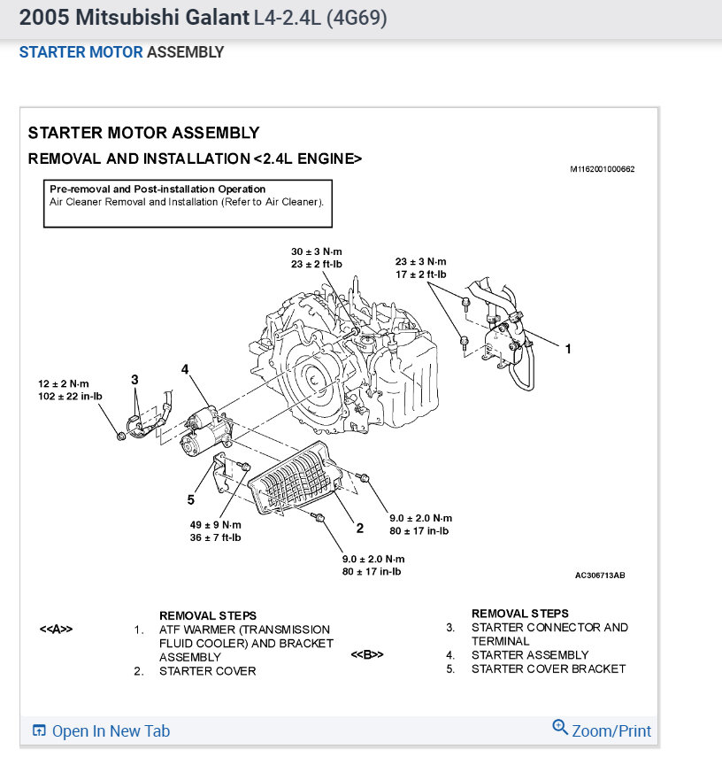

Where is the Starter Motor located?
2005 MITSUBISHI 380
10,435 MILES • 0.8L • 6 CYL • 2WD • AUTOMATIC
NATTY94
Having trouble locating the starter motor.
Dec 13, 2022 at 12:52 PM
  • 55,214 POSTS

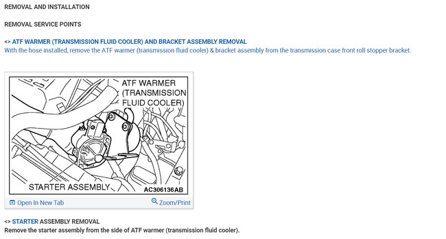

The starter motor is located at the engine and transmission connection which should be under the intake manifold. here is a generic guide that will help you go over the removal steps with instructions and location of the starter in the images below.
Check out the images (below). Please let us know if you need anything else to get the problem fixed.
