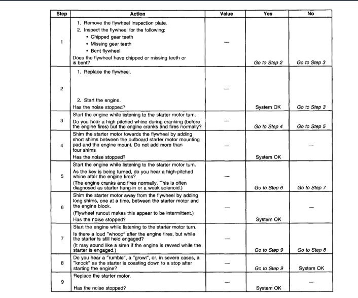

Starter makes loud grinding noise
200,000 MILES • 4.6L • 6 CYL • 2WD • AUTOMATIC
JEDCASTO

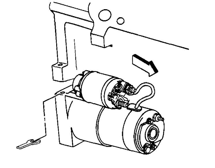

I tried putting shims in, but still makes noise.

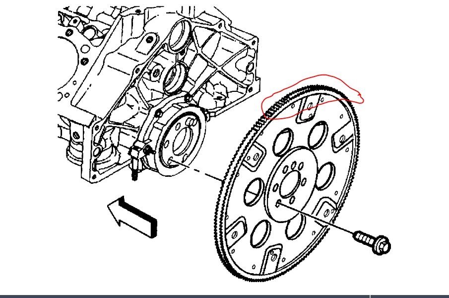

Did you replace the starter? The end gear could be damaged.
Did you check the flywheel for any damage? That is a common issue. check the teeth for any grinding off of the teeth.
