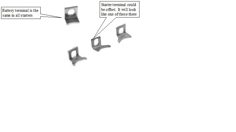

For over a week now, when trying to start It would be clicking sound and no start, recently had battery replaced and starter check without taking out, result was bad charging system suspecting bad alternator, I put it in about a year or so ago. Anyhow, I had to be towed, and the driver said at first, he thought it was the battery, but when he tried to jump it, it wouldn't, then he said your starters gone. So ordered a replacement starter and it tests good on bench test. I'm going to put the new one in but I still must have some kind of electrical issue, my guess ignition wiring, I've read that hot wiring can be done but it's too much of a pain where you have to remove the air bags to get to the ignition wiring and then there might be a immobilizer to disable I don't think my Sienna has one. I should mention so far, I've tested the positive wire from the starter to the battery for continuity and it shows it's fine. So next would I suppose ground and ignition wiring?

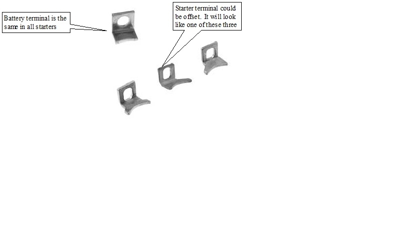

Some of your thoughts are hard to follow, but I have a suspicion you have a very common problem with an easy fix. If that clicking you're hearing is a rather loud single clunk each time you turn the ignition switch to "crank", it is due to burned / arced contacts inside the starter solenoid. Those can be replaced if you can find them. Look for a starter / generator rebuilder in your area. If you can't find one, ask at the repair department of any heavy truck repair shop. They'll tell you the company they use.
The contacts cost around three dollars each, or you may find a rebuild kit in a farm and home store or hardware store. Any of those kits will have what you need, but there are three versions to be aware of. First look at the photo below that shows four solenoid contacts. You only need two of them. That's why buying them individually is much less expensive, but you have to know which ones you need. The kits have listings to show which years and models they cover, but you can't go by that either unless you know for sure your starter is the vehicle's original one. All the different versions and years interchange, so once a rebuilt replacement is installed, you don't know what year your starter is from.
These Nippendenso starters were used on Toyotas and Chrysler products. Every one of them will use the contact listed as the "battery" terminal. At question is which one of the other three you need. You have to match the old one to one of these three "starter" contacts. It could be symmetrical, or centered, or offset to one side or the other.
Also with the repair kits, you'll get a new plunger assembly with the copper contact disc built in. I have never needed to replace that, but you should be aware that there are also three versions of that. Farm and home stores typically have two kits that cover all Chrysler models. The shaft that engages the starter's drive gear with the ring gear on the transmission is about 1/8" longer on one version. If you choose to replace that plunger, you have to use the right one. So far the only place I've found to get the plunger for starters used on Toyotas is from the dealer's parts department. Their shafts are longer than either of the Chrysler models, but as I mentioned, I've never needed to replace one yet. You can use the contacts from either Chrysler kit, and just don't use the new plunger.

Forget about testing starters. These use a gear reduction, so they draw very little current to start with compared to other brands, but when tested off the engine with no load, it can draw much less than 30 - 40 amps. It's pretty easy for burned contacts to handle that, so the test is not valid. Testing needs to be done with the starter on the engine, and then, you need to measure current flow to make the diagnosis. Motor current always starts out very high, then drops a lot once the motor is spinning up to speed. If current is unusually high, as in over 200 amps, the bearings are likely worn, the armature is dragging, and it's spinning too slowly. Spinning too slowly is very different from not spinning at all. When the voltage to the starter stays high where it should be, and current is much too low, or close to 0 amps, it's those contacts that are suspect.
I don't have instructions that I can post for you on how to replace the contacts. If you're a competent do-it-yourselfer, I can describe the procedure. It just takes a few wrenches and perhaps a screwdriver. Of course you can also just replace the entire starter. This would be a good time to use a professionally rebuilt unit with a warranty. With one from a salvage yard, there's a chance you may get one that's about to develop the same problem.

That's kind of ironic that you should mention the contacts because earlier I watched a video where they showed how to replace one of those contacts in a Toyota truck starter and yes, they don't cost very much and most likely they could be found in the local Tractor Supply. That said it's not a clunking sound It's a clicking sound, and I've already gone and installed the replacement starter. Given the fact that I don't know when to quit I didn't want to see if it'll start or not because if it didn't start, I would probably spend all night trying to diagnose the problem and I figured I'd get a fresh start tomorrow. So, if it doesn't start with the new starter in then I can only conclude there is a wiring issue. That just makes sense, it was probably the best decision to not put the old starter back in given that there could be something going on with that starter. So, in the interest of time the best thing now is for the new starter to start up if it doesn't, I know it's not the starter there is some other underlying electrical issue going on. I will keep you posted on what the status is as of tomorrow Thanks for all the good info.

Well, just as I figured I was able to start it with no issues so far so I can only come to one of two conclusions one like you said there is some kind of intermittent issue with the older starter. I'm going to open it up and clean it up and check those contacts The other is quite possibly there was some electrical wiring that may have not been making making good contact possibly on the old starter and that's been corrected now that the new started been put in I'll have to monitor the situation closely so that I don't wind up having the same issue but for now it's starts it charges up so it tells me that the alternator is good too and I'm good to go for now. I appreciate whatever able help you were able to provide me. thanks
