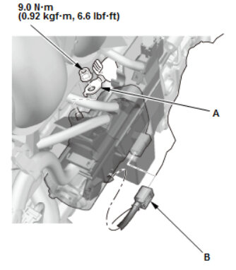

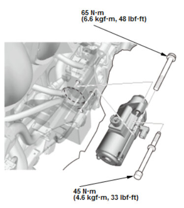

I have a starter on this car is clicking and after a couple of attempts it will start. I need to change the starter and need to know where it can be accessed from and how to remove and replace it with the service manual. I took an initial look from the top and could not really see it. Its hard to locate, and I want to know how difficult the job is.

Yep, it does sound like the starter motor is out. You first need to disconnect the battery and then remove the coolant reservoir. Then remove the starter cover which is on the left side of the engine, under the intake. Check out the images (below). Let us know if you need anything else.
