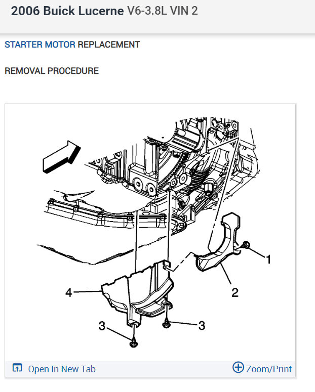

I'm wondering where the starter is on my car listed above, also what bolts do I remove to take the starter off?
Oct 21, 2024 at 2:05 PM
  • 54,832 POSTS

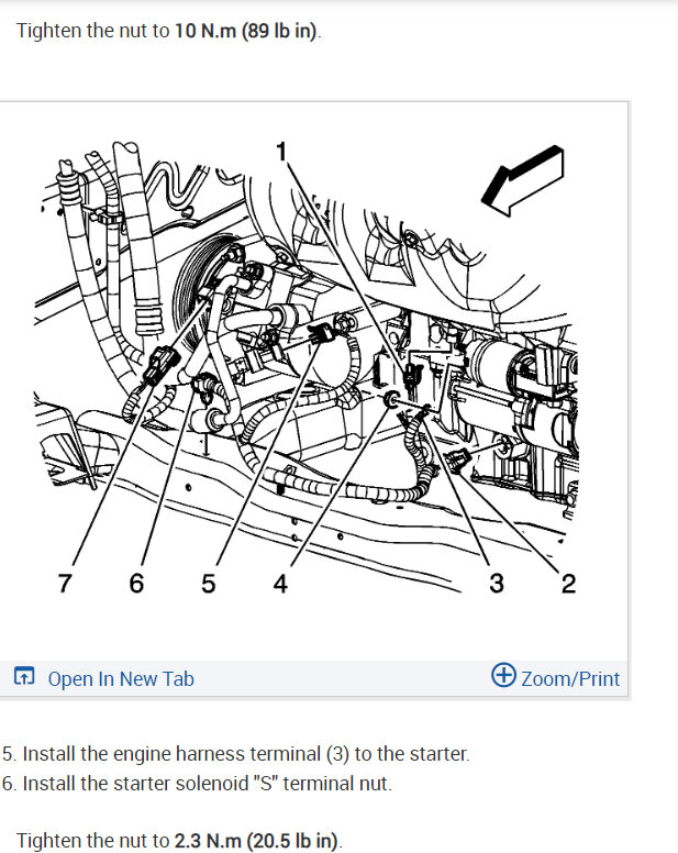

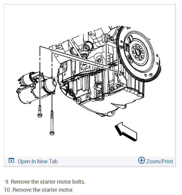

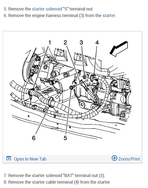

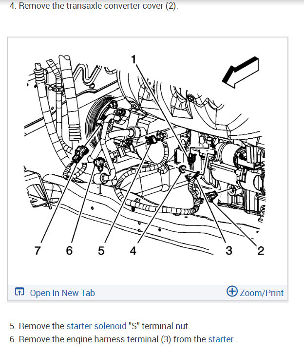

The starter is on the engine down low on the left side rear. here is a generic guide to help you step by step with instructions in the diagrams below to show you how on your car:
Check out the images (below). Let us know if you need anything else.
