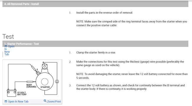

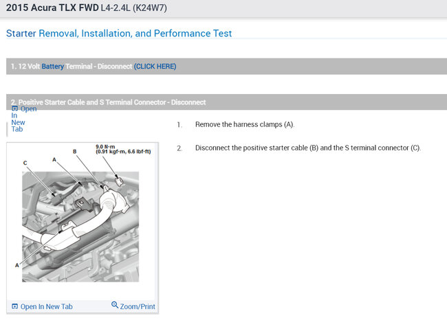

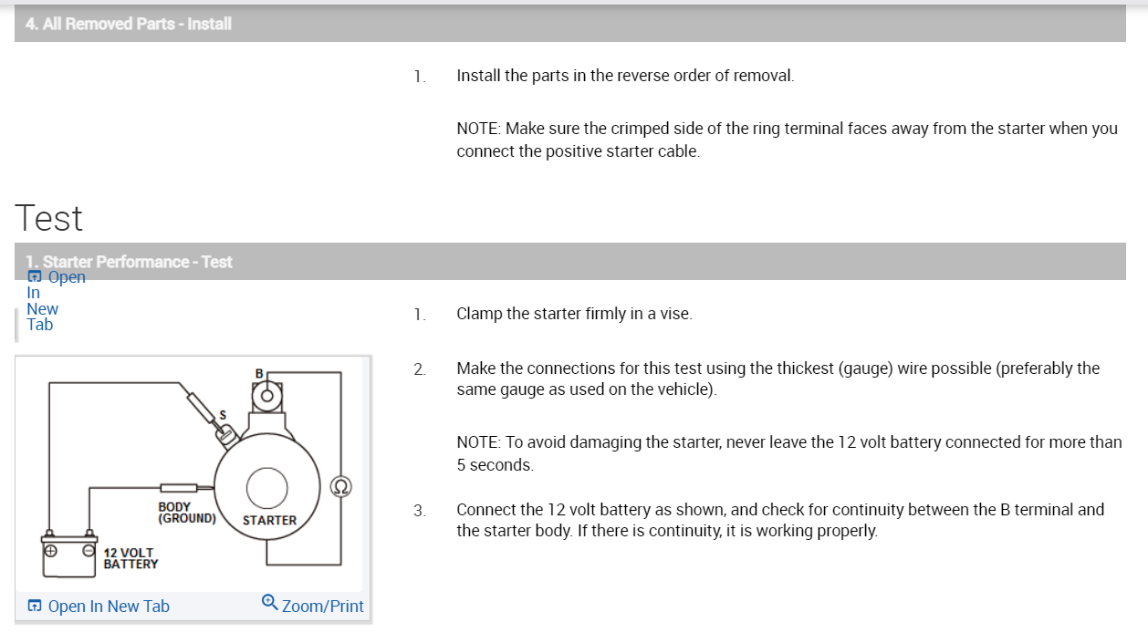

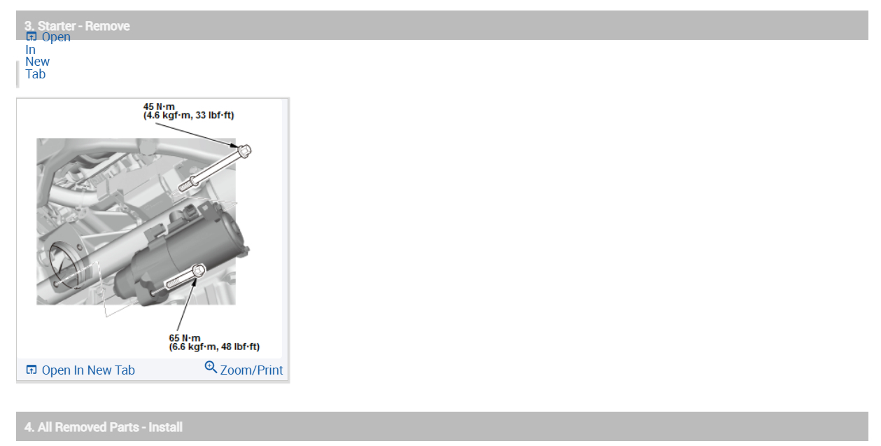

It looks like the starter is on the right side of the engine block down low. Here is a generic guide to help you step by step with instructions in the diagrams below to show you how on your car:
Check out the images (below). Please let us know if you need anything else to get the problem fixed.
