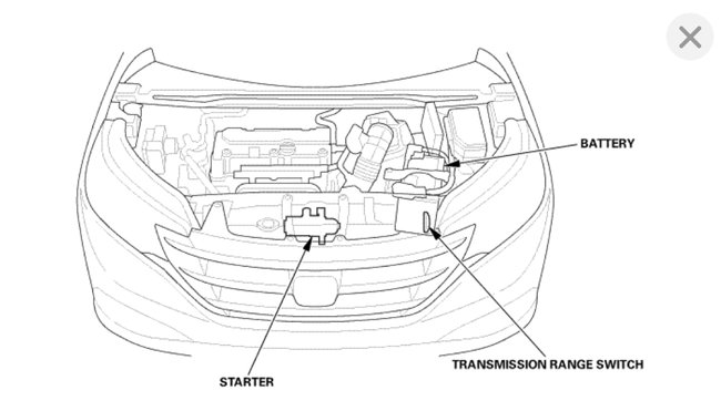

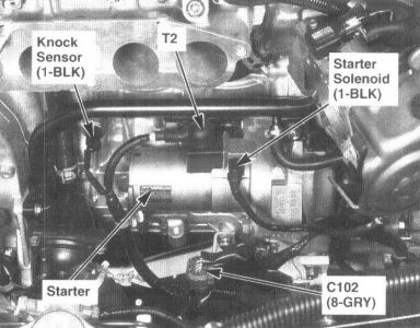

I cannot find the location of the actual starter..

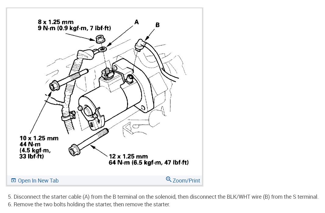

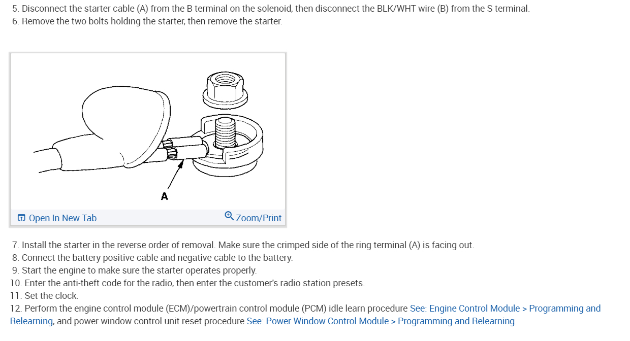

The information that you requested about your vehicle is in the diagrams down below. Please go through this information and let us know how things progress. If you need any instructions at all, like how to remove or install the starter motor on your vehicle, please, do not hesitate to ask. Here is a guide to help you step by step with instructions in the diagrams below to show you how on your car.

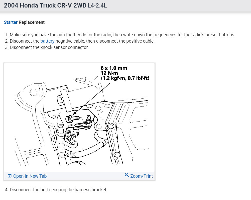

I need to know where to find the starter on a 2004 Honda CRV?

Starter Motor 14. Front of Engine (Intake Removed) Check out the diagrams (Below). Please let us know if you need anything else to get the problem fixed.
https://images.2carpros.com/forum/automotive_pictures/12900_s_22.jpg

How do you get to the back bolt to replace the starter ? The last time I replaced a starter on vehicle was in the 1980's and it was easy?

May have to jack up engine slightly to gain access. Below are the proper replacement procedures.
This guide will walk you through the repair with diagrams below to show you on your car.

Eveybody keeps telling me to remove the two bolts, but what do I need to do to access the rear bolt? I just can't seem to reach it.

would raising the engine slightly help you reach it? if so, loosen the engine mount and slightly raise the engine up some with a floor jack

Honda's aren't like other motors. there is not a lot of space to move around. It's not simply remove the bolts, disconnect the power, then reverse the process but I did it!
