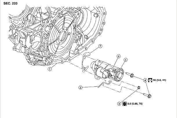

Where is the Starter located?
150,000 MILES • 6 CYL • 2WD • AUTOMATIC
CHALIE10
I want to replace it and could use diagram as I am unable to locate.

The starter motor can be found on the passenger side of the vehicle where the engine and transmission meet. Here is a diagram that should help. Also, here is a link outlining the general procedure for replacing the starter. The main thing to remember is to disconnect the negative battery cable from the battery before starting the replacement.
