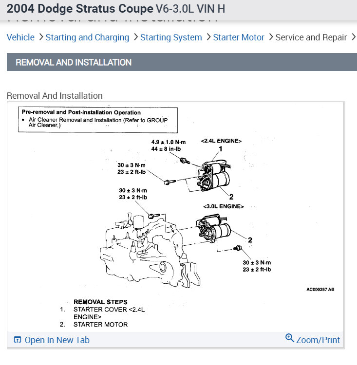

Where do I find the starter?
Jun 16, 2023 at 3:44 AM
Experienced Mechanic
55,542 POSTS
The starter is mounted to the transmission. This guide will help you step by step with the location and instructions in the images below:
