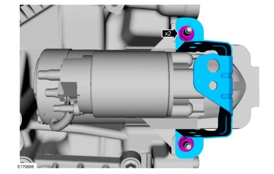

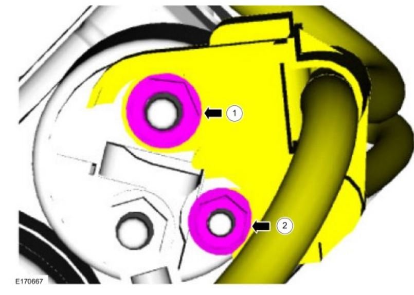

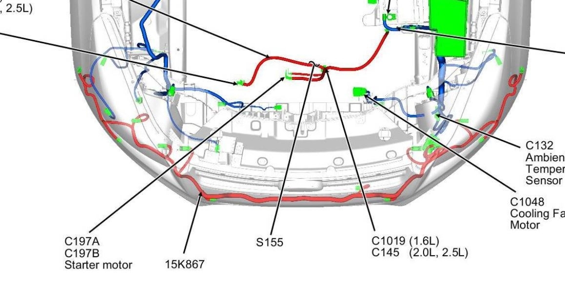

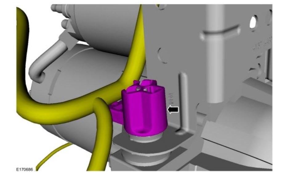

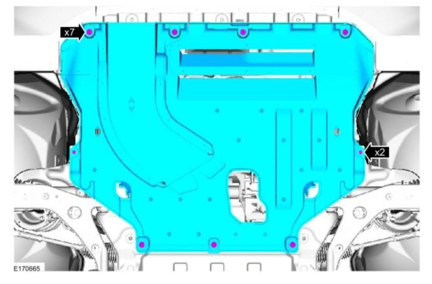

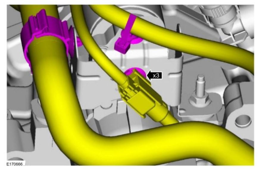

Good afternoon,
I attached the procedure and some pictures for you.
The starter is at the bottom of the motor in the front of the car where the engine and transmission come together.
Starter Motor
Removal

10. Refer to: Starter Motor Drive Gear and Flywheel Ring Gear Inspection See: Starter Drive/Bendix > Component Tests and General Diagnostics > Starter Motor Drive Gear and Flywheel Ring Gear Inspection (303-06C Starting System - 2.5L Duratec (125kW/170PS), General Procedures).
Installation
1. Torque : 35 lb.ft (48 Nm)
