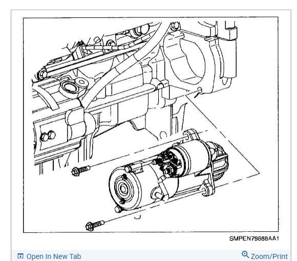

So when I turn the key the starter just spins and doesn't engage flywheel. So I changed the starter and same issue. This is driving me nuts. Someone please help.
Mar 3, 2020 at 2:04 PM
SCGRANTURISMO
  • 4,897 POSTS

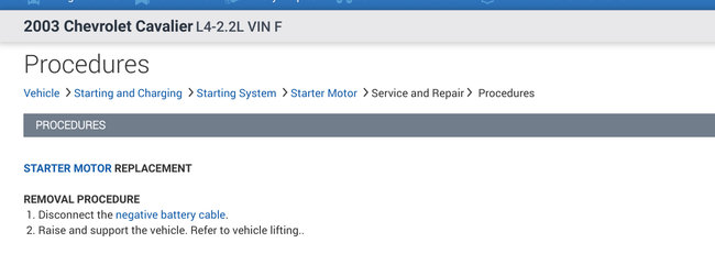

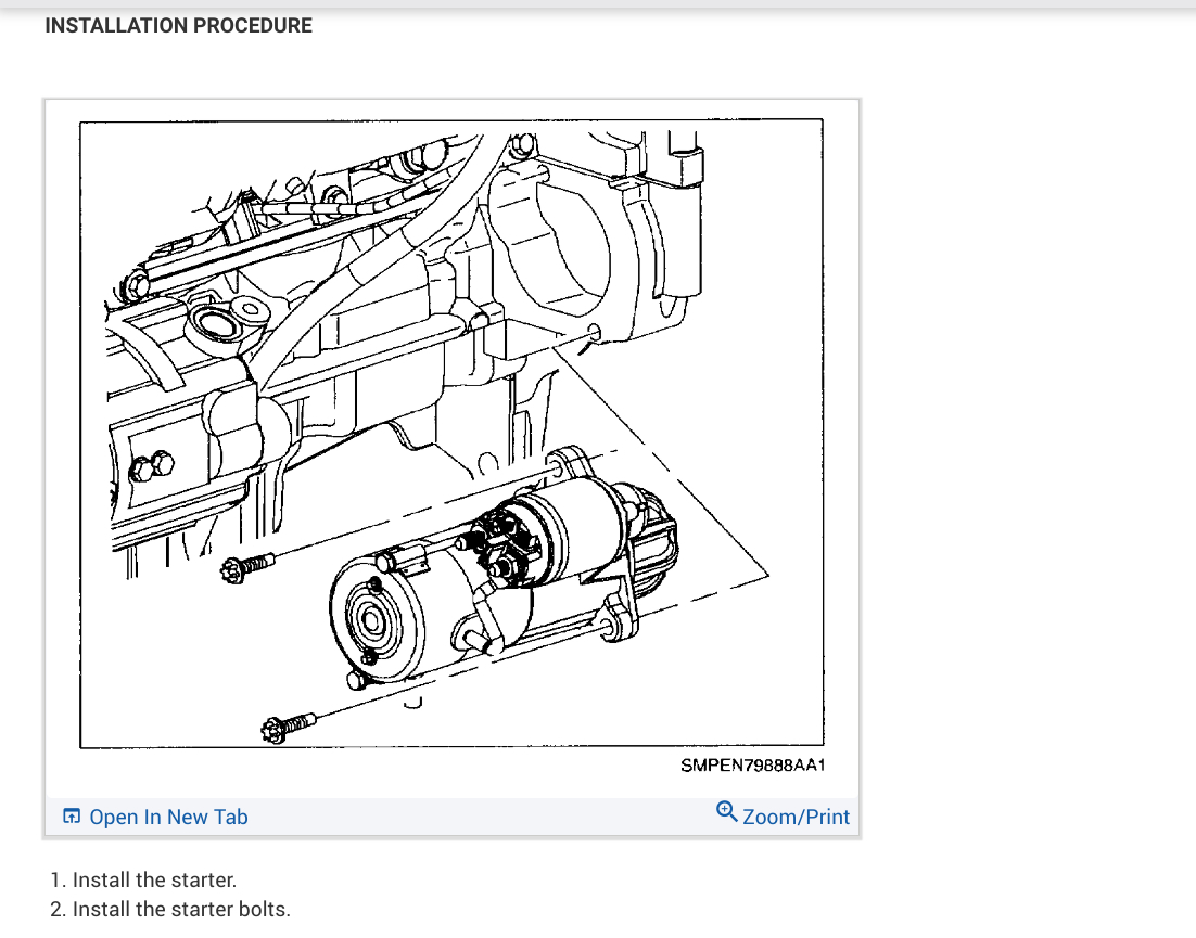

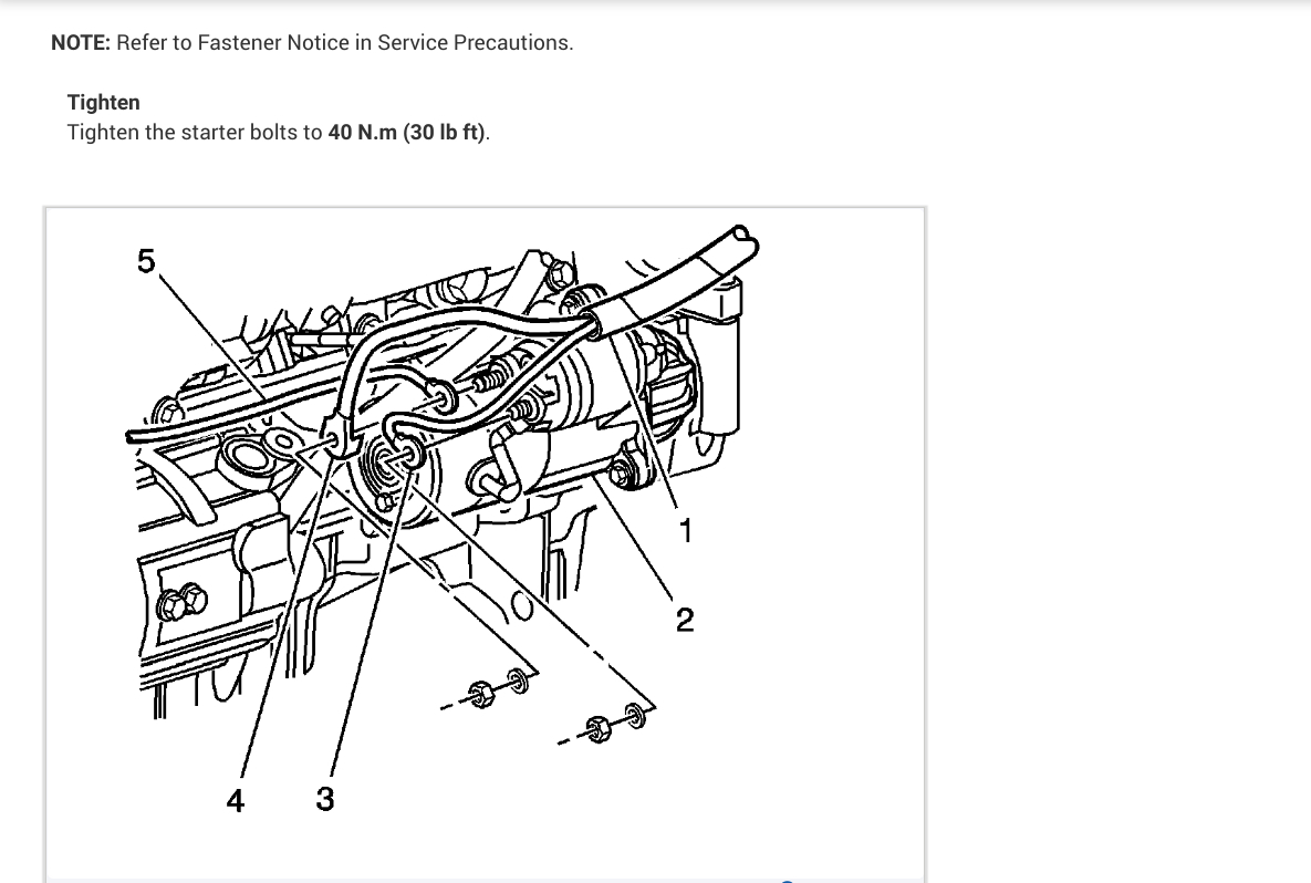

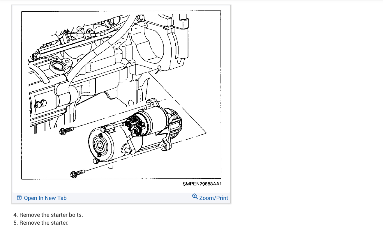

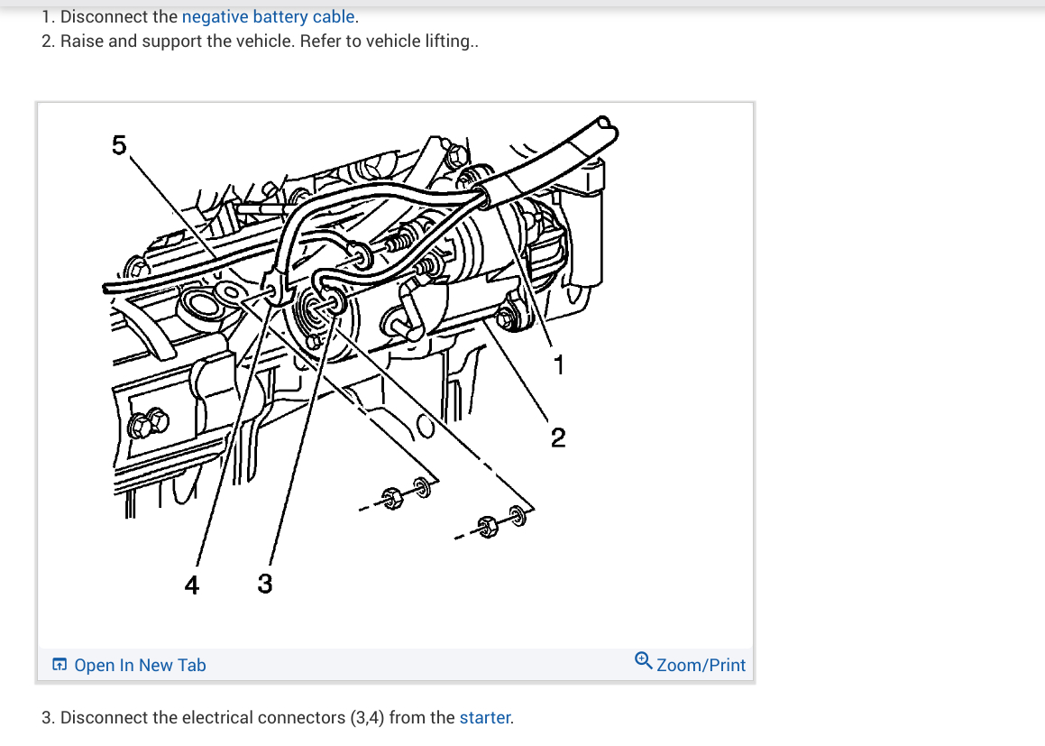

This sounds like you might have got a bad starter right out of the box. When the starter engages the flywheel/flex-plate a small gear called the Bendix gear pops out and meshes with the flywheel/flex-plate [flywheel for a standard transmission, flex-plate for an automatic] and the the electric starter motor spins the engine to get it started. In the diagrams down below I have included the instructions for the removal and installation of the starter motor for your vehicle. Please go through this guide and get back to us with how everything turns out. We can go from there if needed.
