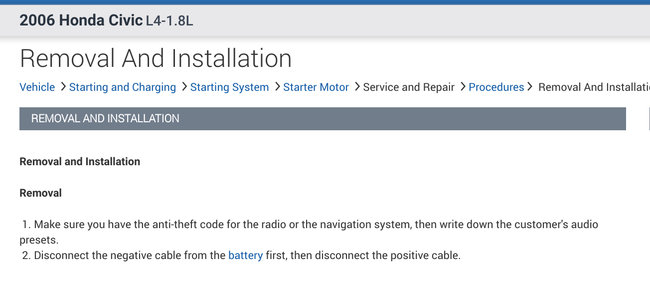

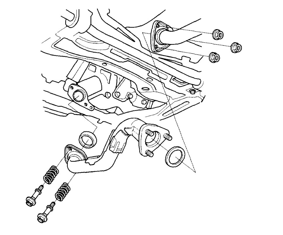

Starter went up and this will be my first time replacing one so I just want to make sure I have the accurate location of it before I start the job. Is the placement of that starter at the top or bottom and front or back of the manifold?
Nov 30, 2019 at 7:55 AM
SCGRANTURISMO
  • 4,897 POSTS
In the diagrams down below I have included the instructions for the removal of your vehicle's starter motor for you. The installation is going to be the same directions, only in reverse. One piece of advice I can give you is to disconnect your vehicle's battery before starting any work on your starter. Please go through this guide and get back to us with how everything turns out. Here is a guide to help you step by step with instructions in the diagrams below to show you how on your car.

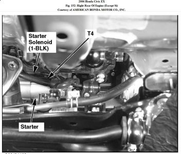

Hi Oldlegger, Starter is located at rear of engine below the intake manifold.
https://images.2carpros.com/forum/automotive_pictures/192750_StarterLocation06CivicFig152_1.jpg

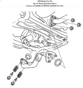

Here are removal procedures: Starter removal and installation Removal: 1 . Make sure you have the anti -theft code for the audio system and the navigation system (if equipped), then write down the audio presets. 2 . Disconnect the negative cable from the battery first, then disconnect the positive cable. 3 . Remove exhaust pipe A.
https://images.2carpros.com/forum/automotive_pictures/192750_StarterRemoval06CivicFig15_1.jpg

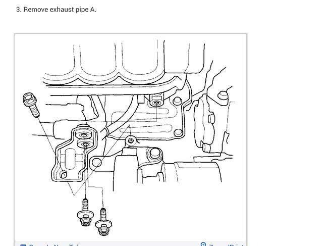

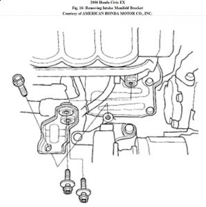

4 . Remove the intake manifold bracket.
https://images.2carpros.com/forum/automotive_pictures/192750_StarterRemoval06CivicFig16_1.jpg

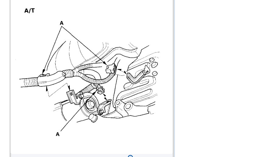

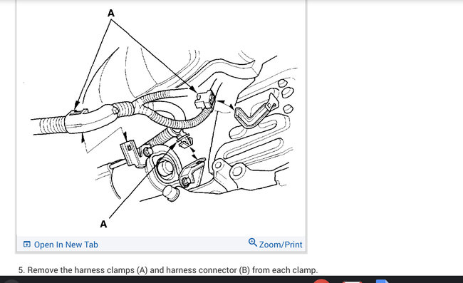

5 . Remove the harness clamps (A) and harness connector (B) from each clamp.
https://images.2carpros.com/forum/automotive_pictures/192750_StarterRemoval06CivicFig17_1.jpg

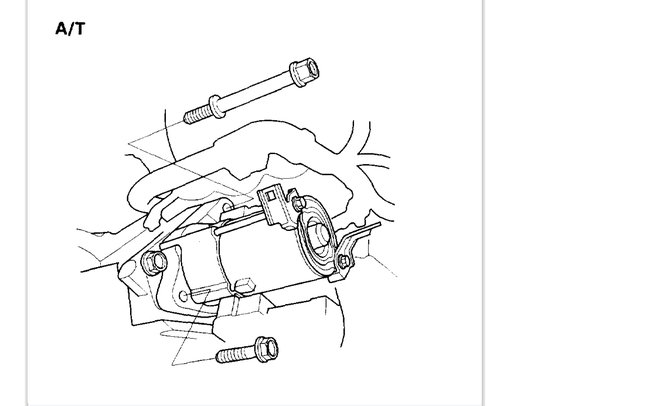

6 . Remove the two bolts securing the starter, then remove the starter from the engine.
https://images.2carpros.com/forum/automotive_pictures/192750_StarterRemoval06CivicFig18_1.jpg

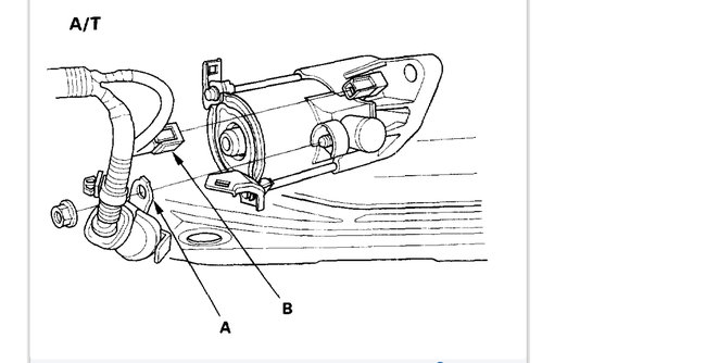

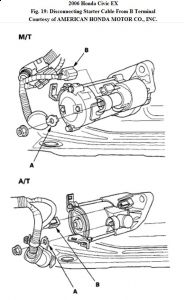

7 . Disconnect the starter cable (A) from the B terminal. Disconnect the connector (B) from the S terminal, then remove the starter.
https://images.2carpros.com/forum/automotive_pictures/192750_StarterRemoval06CivicFig19_1.jpg

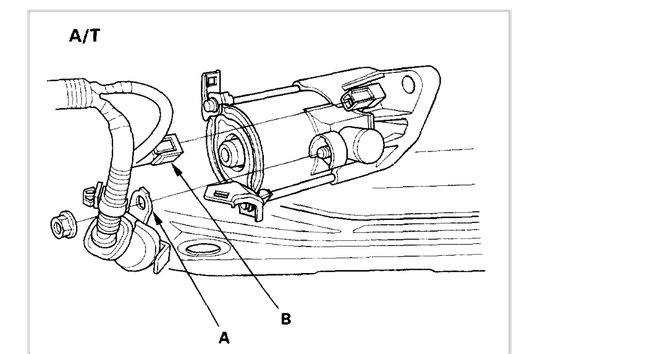

Installation: 1 . Install the starter cable (A) and connector (B). Make sure the starter cable crimped side of the ring terminal faces away from the starter when you connect it.
https://images.2carpros.com/forum/automotive_pictures/192750_StarterRemoval06CivicFig20_2.jpg
2 . Install the starter, then loosely install the upper mounting bolt (A) and lower mounting bolt (B).

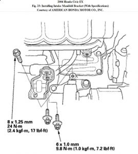

5 . Install the intake manifold bracket.
https://images.2carpros.com/forum/automotive_pictures/192750_StarterRemoval06CivicFig23_1.jpg

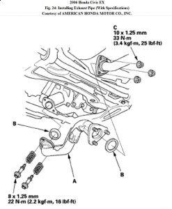

6 . Install exhaust pipe A. Use new gaskets (B) and new self -locking nuts (C).
https://images.2carpros.com/forum/automotive_pictures/192750_StarterRemoval06CivicFig24_1.jpg

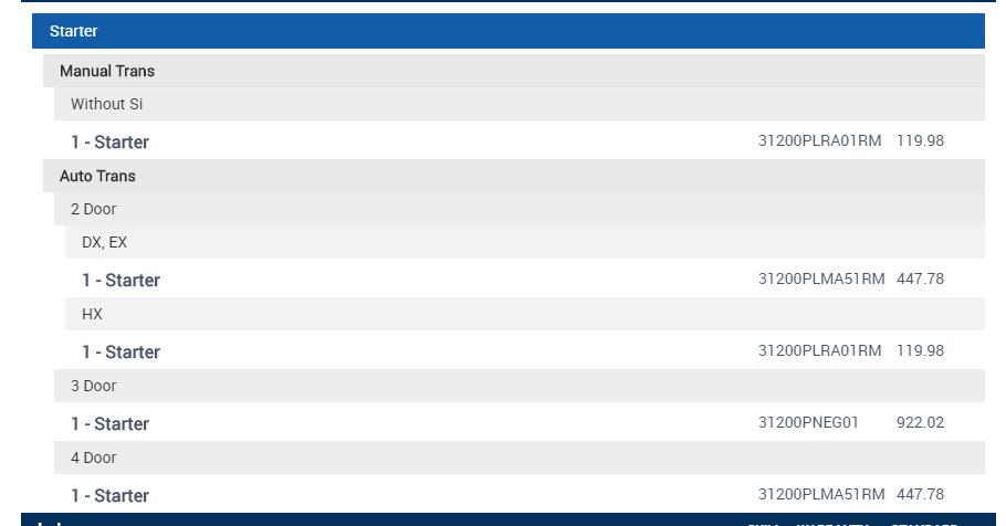

Can I use a Mitsuba sm-74009 starter on my car listed above?
Jan 22, 2021 at 5:32 AM (Merged)
Looks like this starter is for a 2.4L engine and not your 1.7L engine so it would not fit. I attached a document showing all the OEM part numbers for this vehicle depending on model and transmission. Let us know if you have more questions. Thanks
