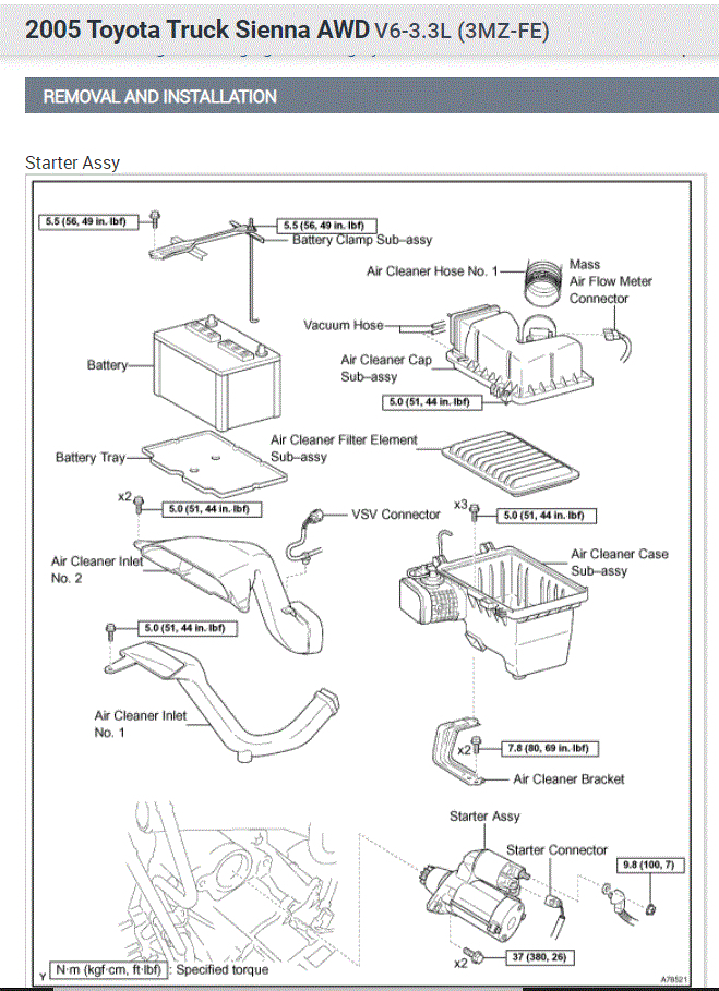

I was able to Uninstall the starter from my vehicle. I installed the new starter. Didn't bolted down yet just added one bolt but very loosely and connected the sensor and battery. Everything else like the mass airflow sensor, and all vacuum lines are still off the vehicle. Turn it on and it stays on for only 2 seconds and goes off. Left it like that all day long and came home just now in the evening and it turned and stayed on. When I turned it off to restarted, it didn't start. Is it because everything is out of the vehicle and the starter is not clamped down correctly to the torque specifications?
Oct 16, 2021 at 10:26 AM
  • 110,241 POSTS

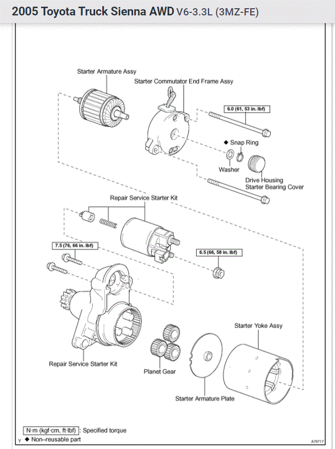

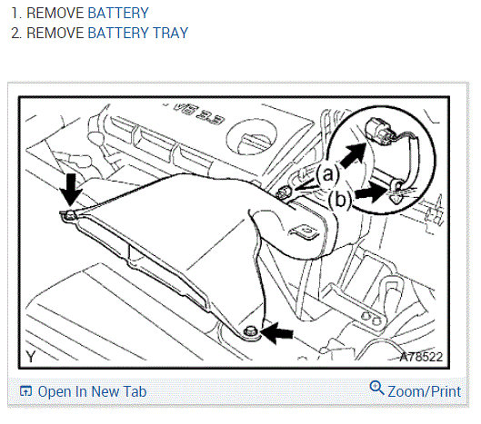

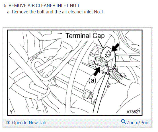

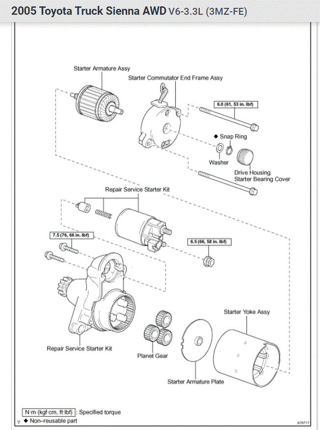

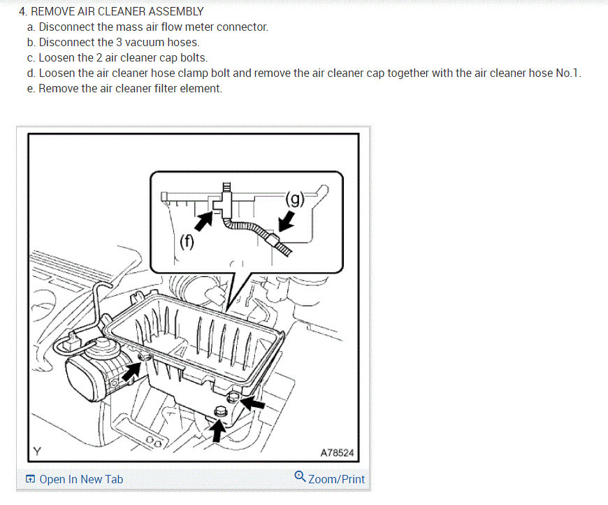

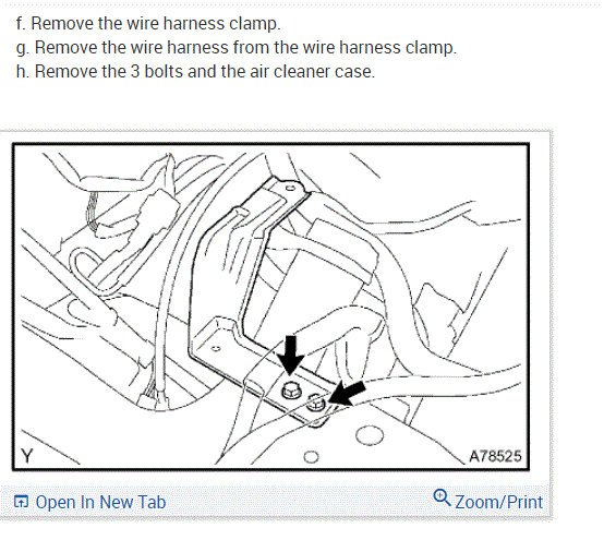

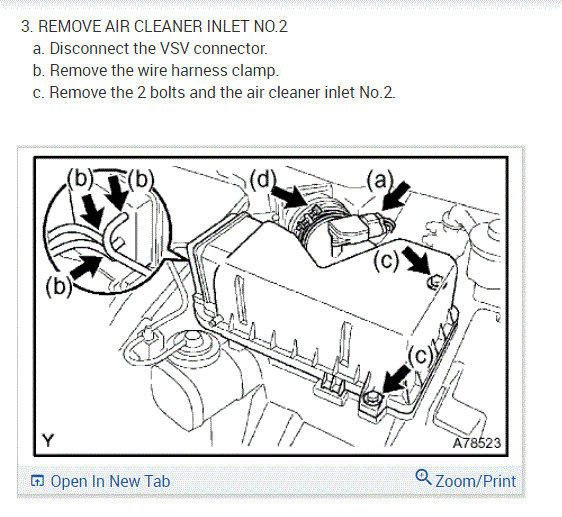

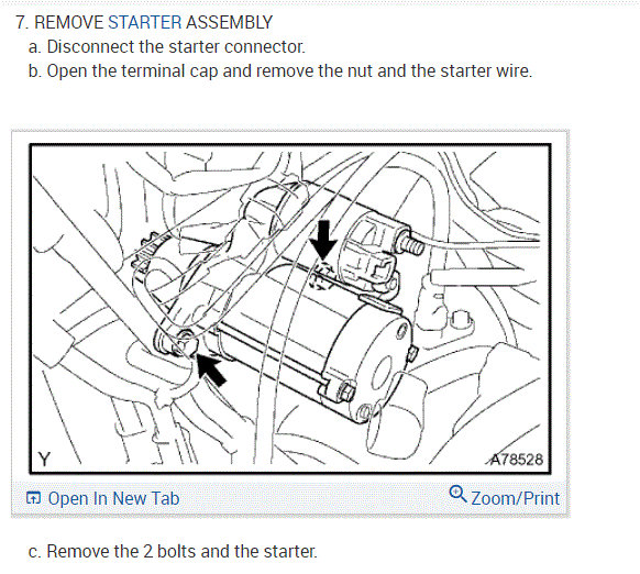

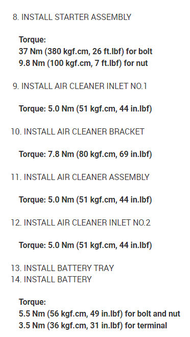

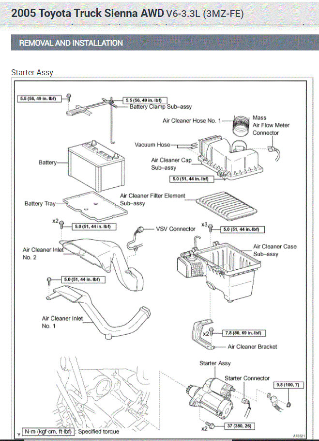

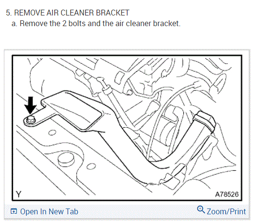

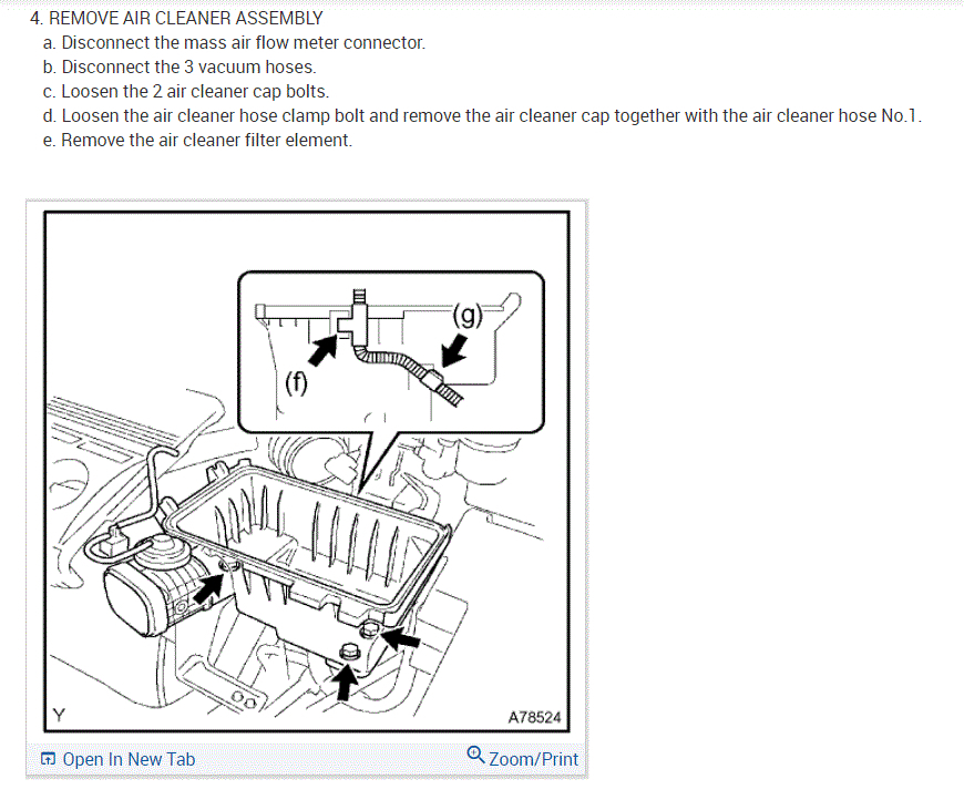

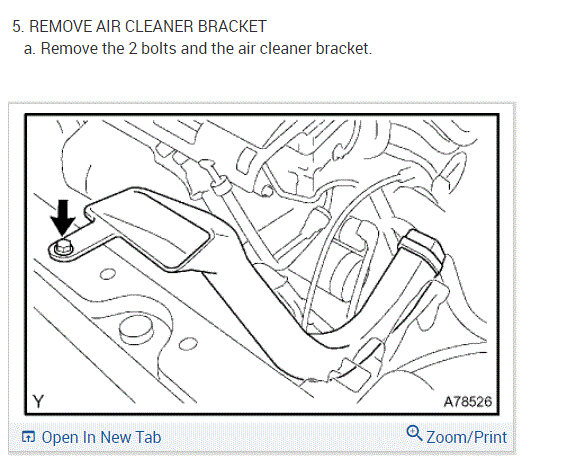

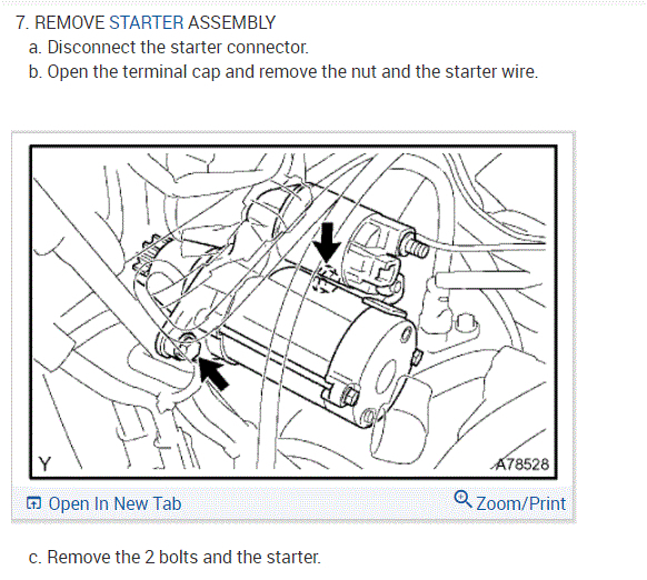

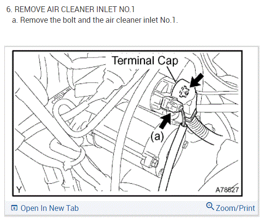

If you have everything disconnected, that certainly can cause the engine to stall. As far as the starter, if you are starting it while only one bolt is loosely installed, be careful. It can break the starter or where it's mounted. There is a lot of torque on it when cranking the engine.
I attached the directions below for the removal and replacement of the starter. I'm adding them just in case. Also, they provide the torque specifications.
Oct 16, 2021 at 4:02 PM
