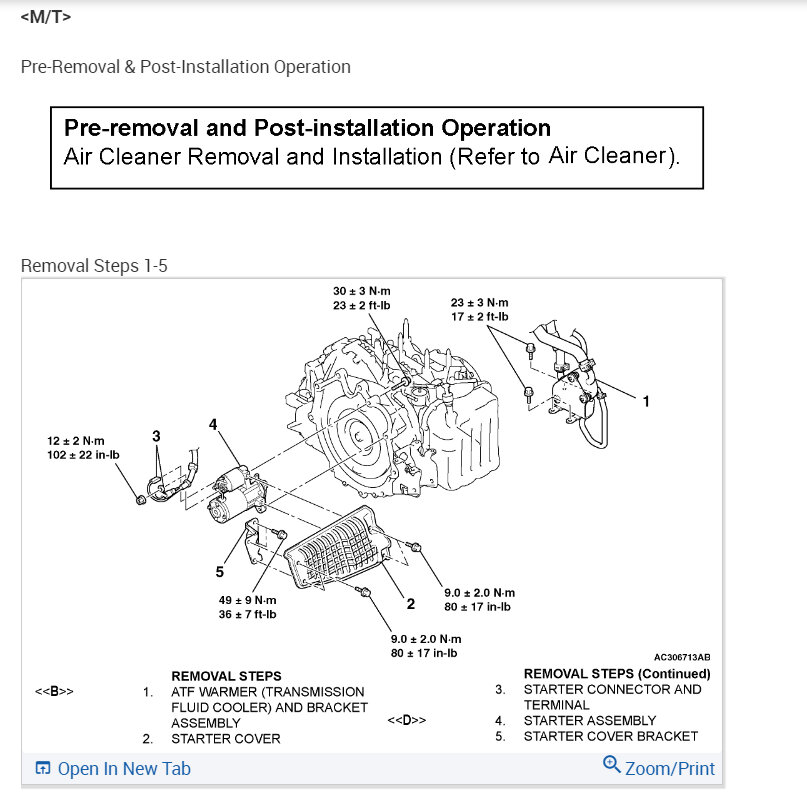

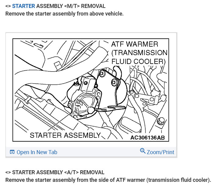

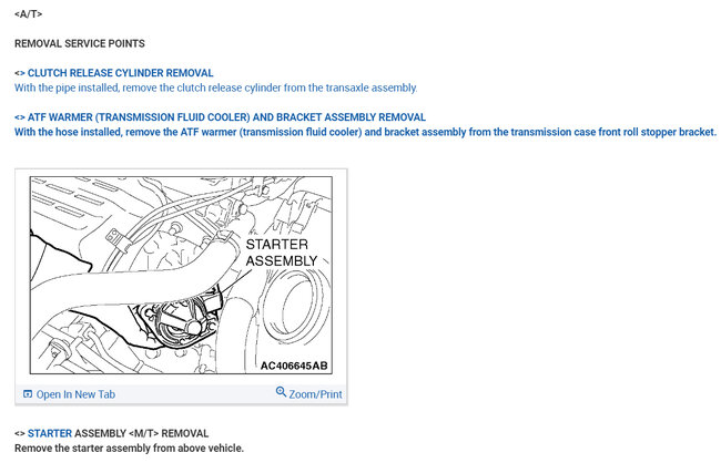

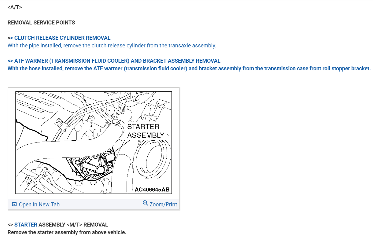

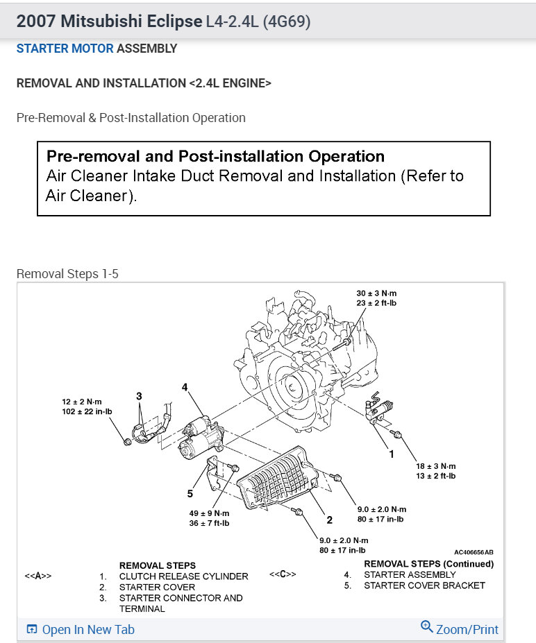

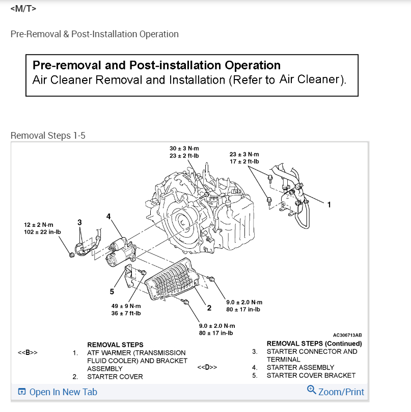

Most of the time the starter motor will be going bad, but I would start by load testing the battery and cleaning the battery cables.
Here are guides that can help us fix the problem:
and
If the guides above, don't help, please go over this guide:
Here is how to change the starter out. Check out the images (below). Please let us know how it goes.
Jul 17, 2023 at 11:14 AM

I have done that,and the starter works outside of the car.

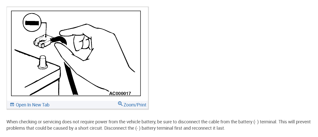

Could a bad ground possibly be the fault?
Jul 18, 2023 at 12:07 AM
  • 55,433 POSTS
Yes, for sure a bad ground cable or connection to the engine block can cause the issue. I would make sure the cable is in good shape and the connection is clean and tight. Check out the images (below). Please let us know how it goes.
Jul 20, 2023 at 2:45 AM
