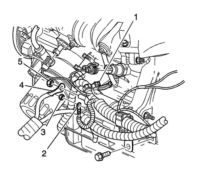

My starter is gone. I know this but I need to start my car to drive it home as it's stuck in a Walmart parking lot. The starter smokes from the bottom when trying to start it. White smoke. Is there a way to bypass it so I can drive home? It won't crank. Only clicks.
Feb 2, 2021 at 7:15 AM
  • 110,248 POSTS
There is no way to bypass the starter. It is needed to turn the engine for it to start. If it is smoking, I wouldn't keep trying.

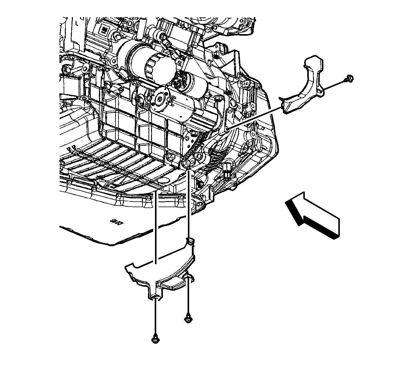

3. Remove the front transaxle closeout cover bolt.
4. Remove the front transaxle closeout cover.

5. Remove the starter solenoid "BAT" terminal nut (5).
6. Remove the positive battery cable terminal (4) from the starter solenoid.
7. Remove the starter solenoid "S" terminal nut (3).
8. Remove the engine harness terminal (2) from the starter solenoid.

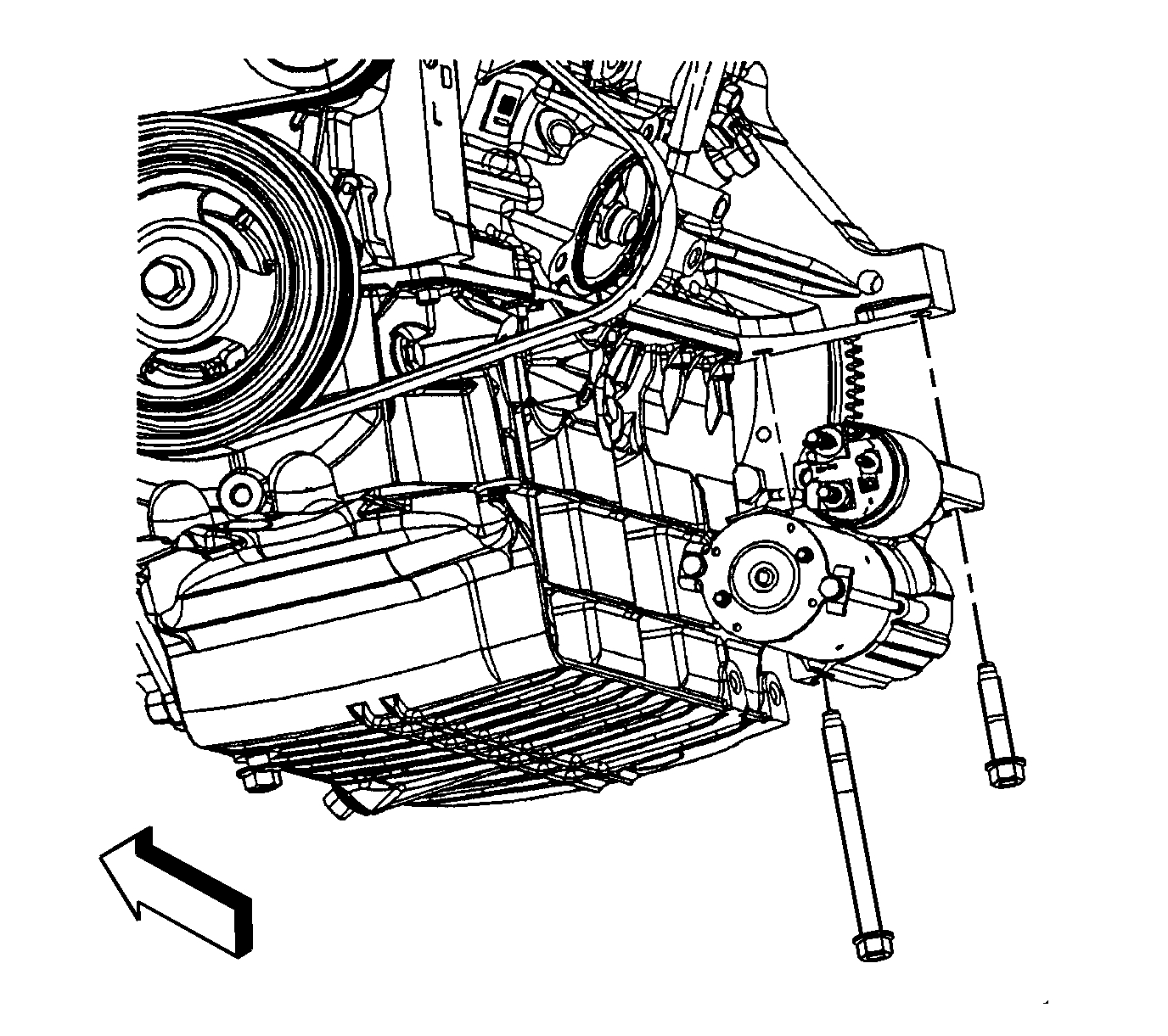

9. Remove the starter bolts.
10. Remove the starter.

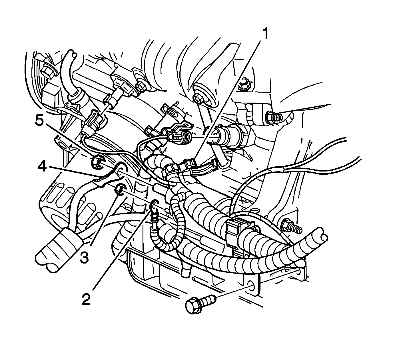

NOTE: Before installing the starter motor to the engine, tighten the nut next to the cap on the solenoid BAT terminal. If this terminal is not tight in the solenoid cap, the cap may be damaged during installation of electrical connections and cause the starter motor to fail later.
pic 4
1. Position the starter to the engine block.
2. Install the starter bolts.
Tighten the bolts to 40 N.m (30 lb ft).
NOTE: Refer to Fastener Notice.
