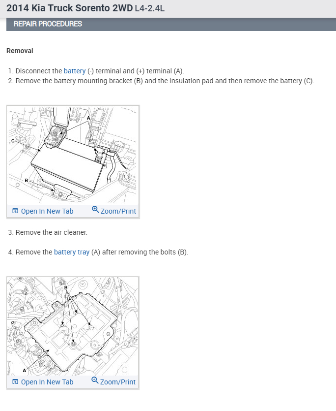

The car usually starts after about four cranks, every now and then it takes 8 to 10 cranks to start, could it be electrical or the starter going bad?
Mar 14, 2022 at 6:29 AM
SQM
  • 6,383 POSTS
This could be due to a weak battery or a starter.
Load testing the battery can help you determine the cause.
You can also try to jump start the vehicle and see if that takes the 8-10 cranks or if it starts normal. This can also tell you if it is the battery or the starter.
https://www.2carpros.com/articles/how-to-jump-start-car-battery-using-jumper-cables

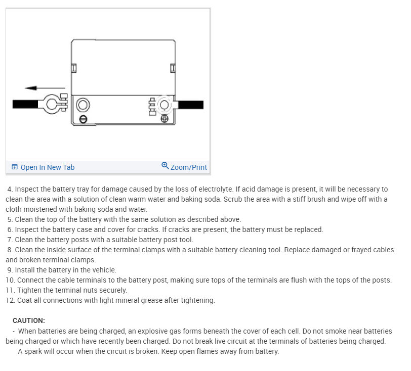

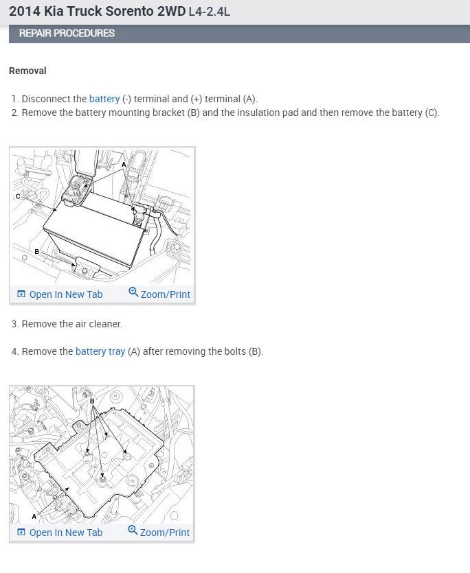

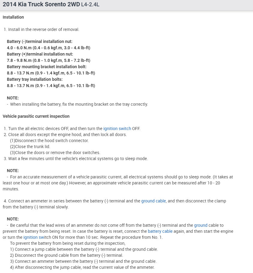

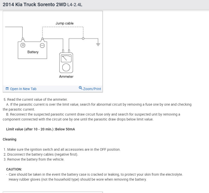

I have attached the battery replacement procedure below.
