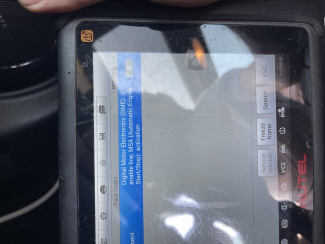

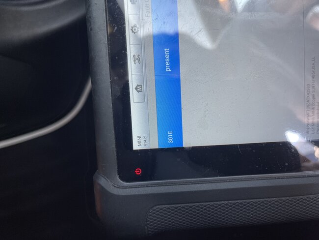

So, i have had few times where i would go start it and it just would just click. But the 2nd time starts right away. Today it won't. It seems the starter is wanting to turn but is weak. I parked it 4 days ago and it was fine. I put a jumper on it but that did not help. Also, the only code i see is the one attached. The But i think that the sensor is hooked up to the negative terminal. I kept trying and trying and this is a push button car so i did that and every time it would just click. Starter issue most likely? But i also hear the clicking relay on passenger side whenever i try to start it. The only thing i saw with that code is the intelligent sensor. But i doubt it would have these symptoms.

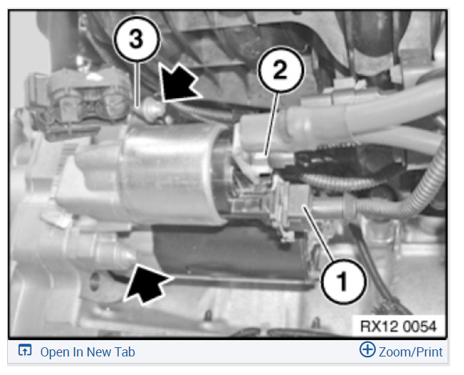

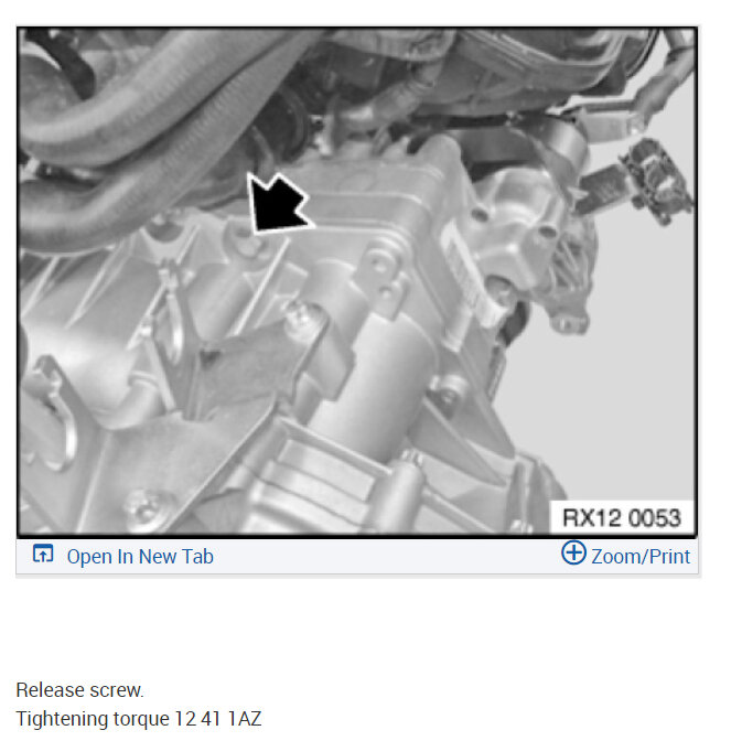

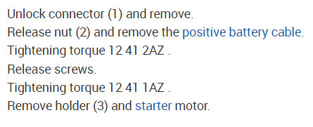

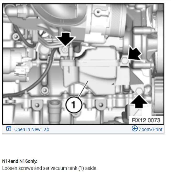

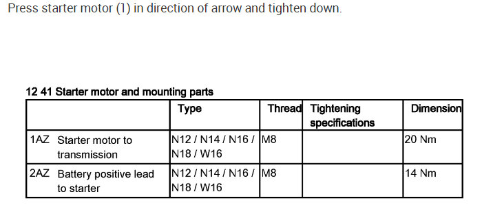

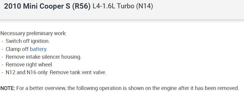

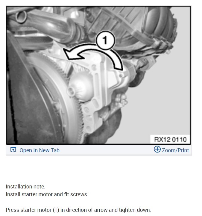

Chances are it is the starter, but if you use a test light on the trigger wire you can tell for sure, please go over this guide which can show you how to do the job and I have included starter replacement instructions as well.
Here is the location and how to change out the starter motor. Check out the images (below). Please upload pictures or videos in your response of any problems so we can see what to help you with.
