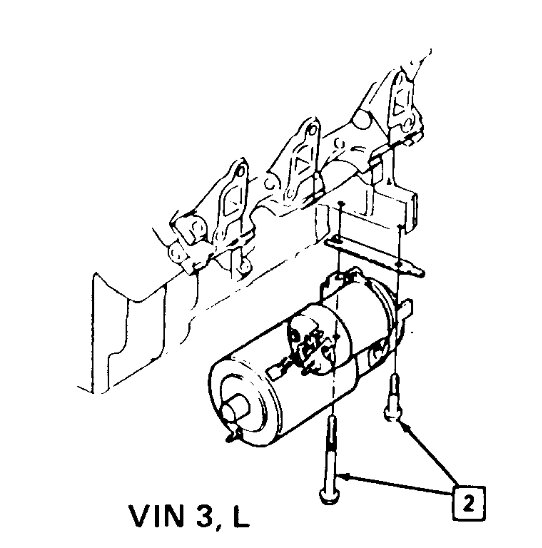

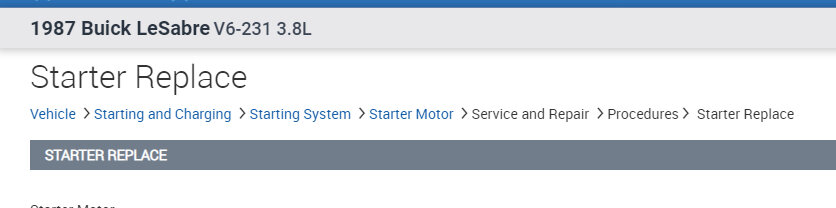

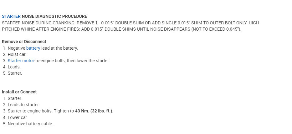

It sounds like the starter Bendix has failed. The Bendix is what kicks the starter drive gear out to connect with the flex plate and turn the engine. In this case, I would replace the starter motor.
I attached the directions below.
Let me know if this helps or if you have questions.
