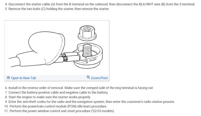

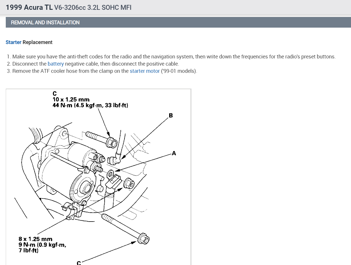

Installed a new starter. Hooked up the battery cables and everything started smoking. What's causing this?
Apr 24, 2023 at 2:12 AM
  • 55,423 POSTS
It sounds like the starter you installed is defective or the wiring to the starter has been installed incorrectly. Here is a guide to help you step by step for the starter replacement and instructions in the images below to show you how on your car.
Check out the images (below). Please let us know what you find.
