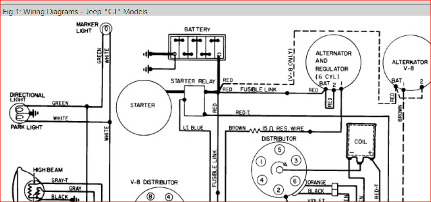

Hello, I bought this vehicle without a starter. I am wondering if you have a picture showing where the two wires connect?

I have attached a picture from a wiring diagram. Hope this helps and feel free to ask any questions. Thanks for using 2CarPros.

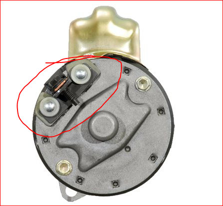

Sweet! Thank you! Do you know if the positive wire connect to the bolt in the front of the starter or back?

It would be on the back. I have attached a picture and circled in red. Hope this helps and thanks again for using 2CarPros.

How about the ground wire? It clicks but does not spin or engage.

Have you had the starter motor tested to see if it works? The starter is not grounded. Hope this helps and thanks for using 2CarPros.
