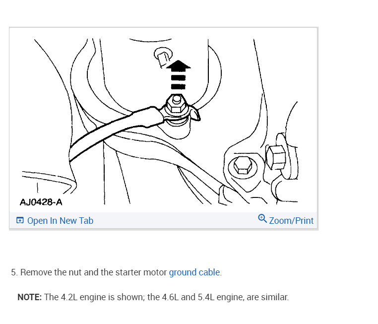

I installed a remanufactured 4.2 in my truck listed above. I go to start it and hear a loud clicking sound. If I push start the truck it turns right on. What is happening?
Aug 22, 2022 at 7:58 AM
  • 55,402 POSTS

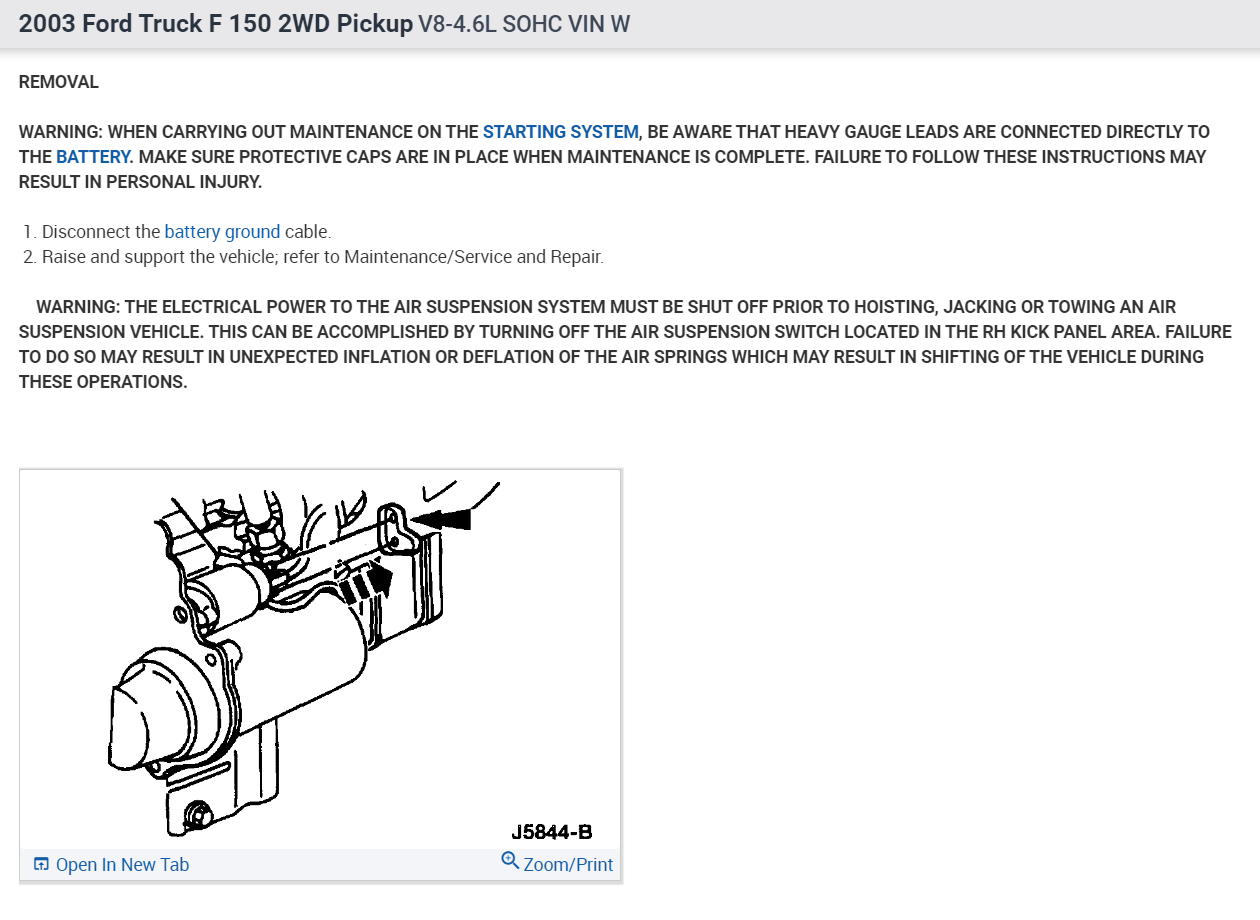

You could have the wrong or a bad starter motor, can you see if the starter is getting power when the ignition key is turned to the crank position?
This guide can help:

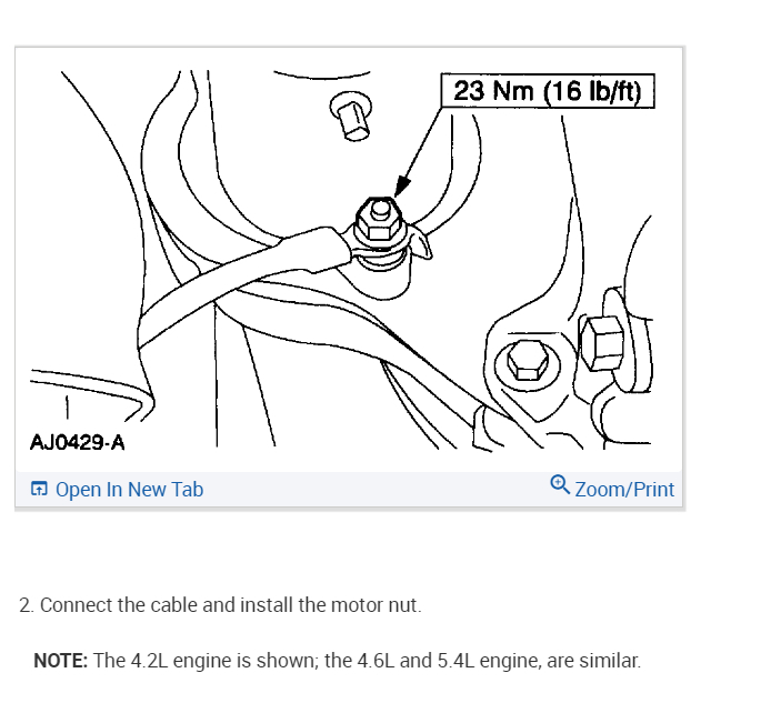

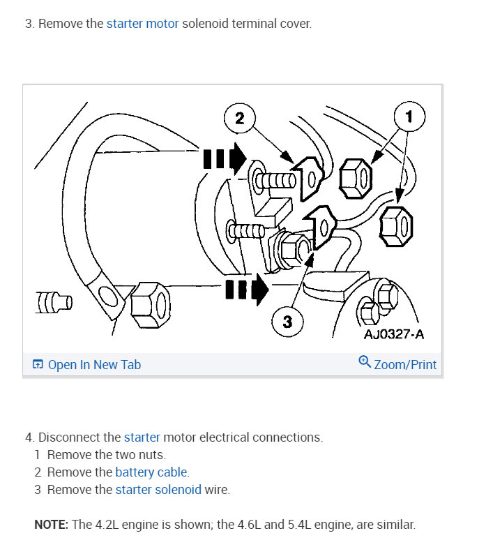

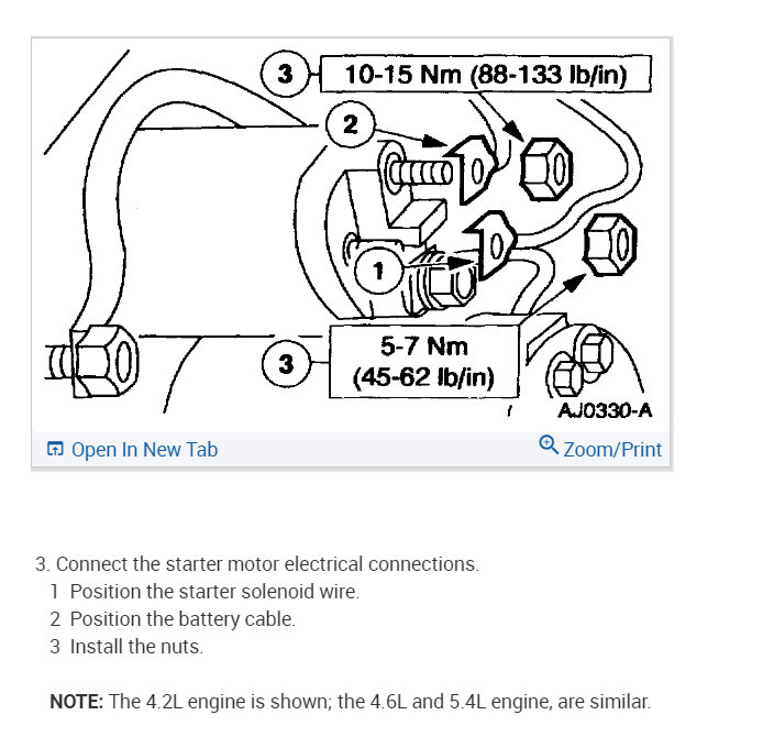

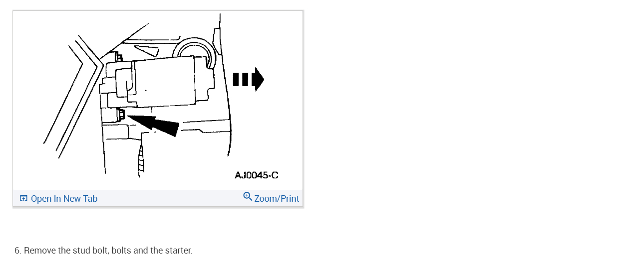

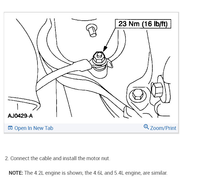

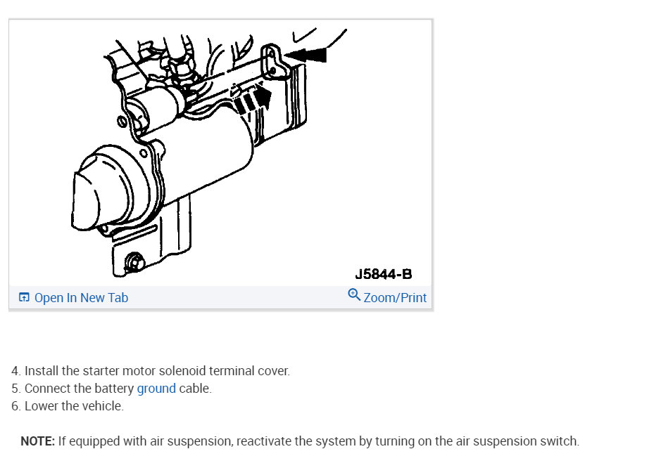

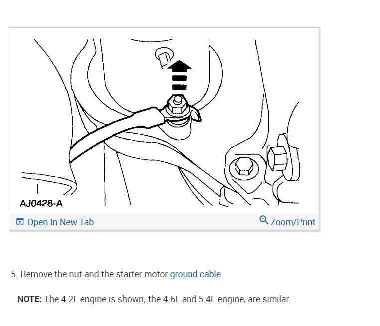

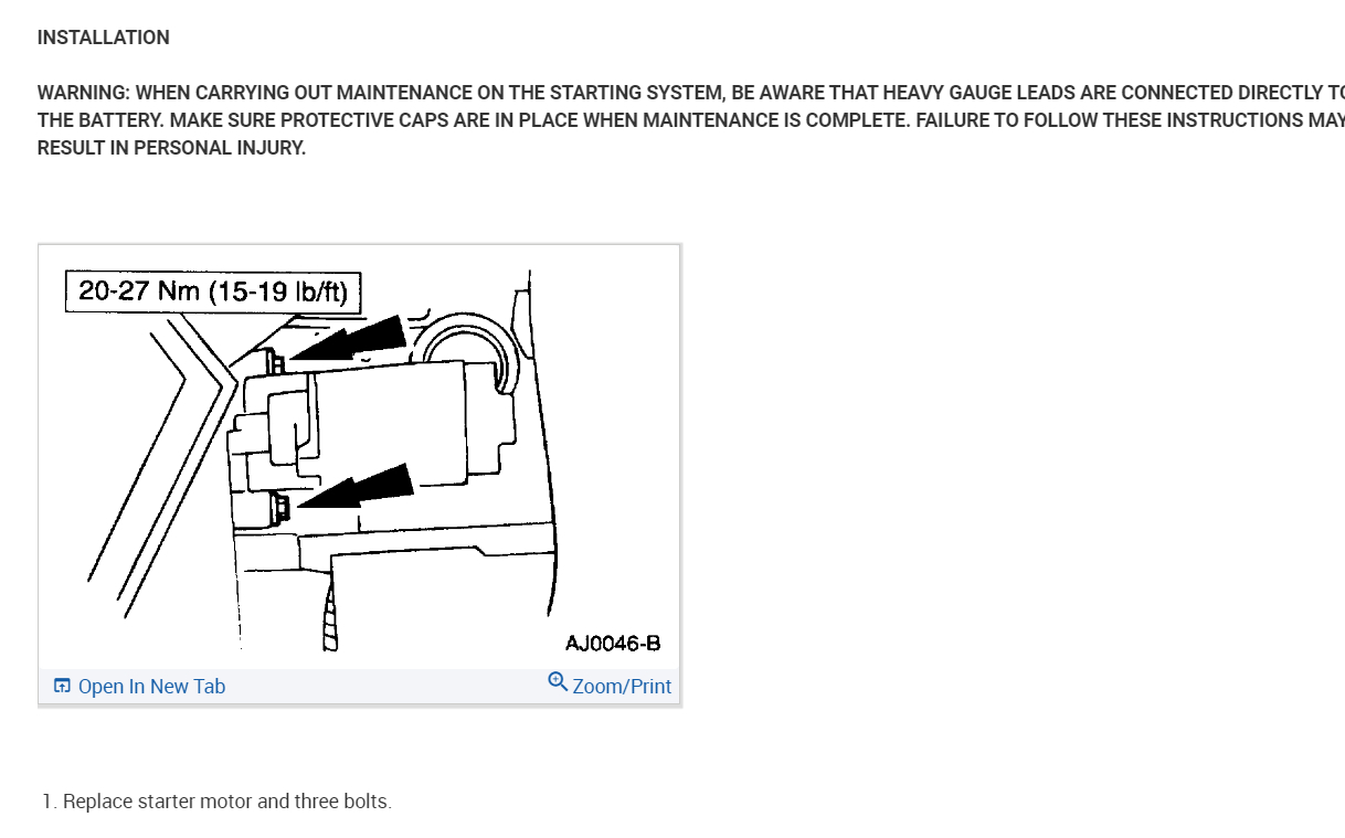

Here is how to remove the starter in the diagrams below to see what's going on, also if you could upload a short video of the noise and what's going on it would help me see how to fix it. Check out the diagrams (below). Please let us know what you find. Also, it shows a ground cable going to the body of the starter did you reinstall it? Please follow the wiring on the starter solenoid as well.
Aug 22, 2022 at 10:57 AM
JOHN GARZA
Yes, the starter is getting power when the key is turned on. Another thing is it's the same flywheel and starter I had on the previous motor.
