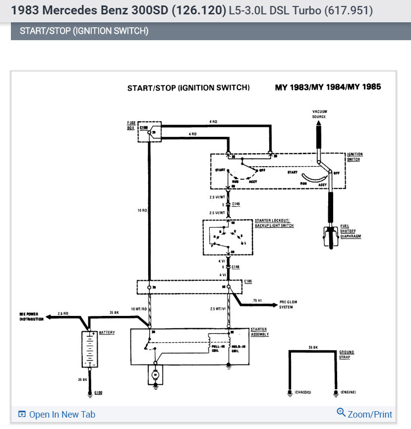

Got hard to start leaving town barely cranked, stopped at home will not start again. Replaced rewound starter so far. Where is relay?

It does not have a relay for the starter. Here is a wiring diagrams to help you see how the system works. Is the battery okay? Here are two guides that can help:
and
Check out the diagrams (below). Please let us know what you find.
