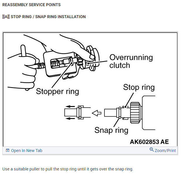

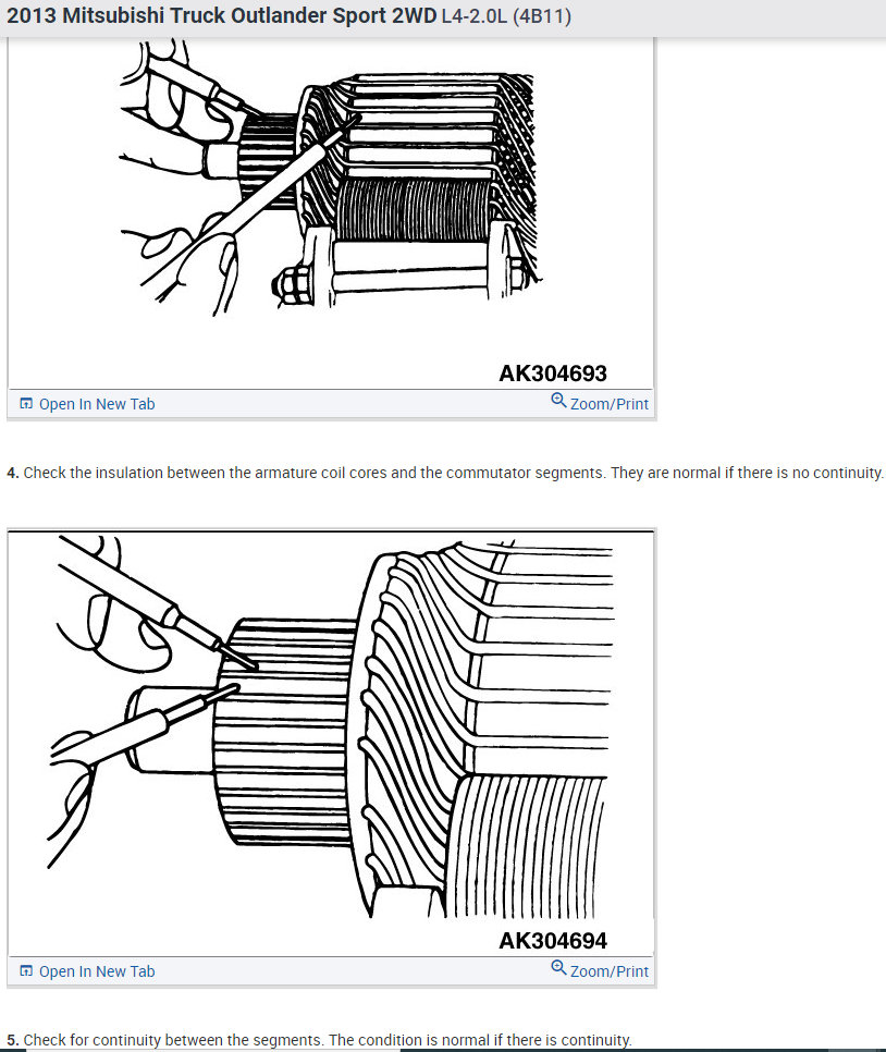

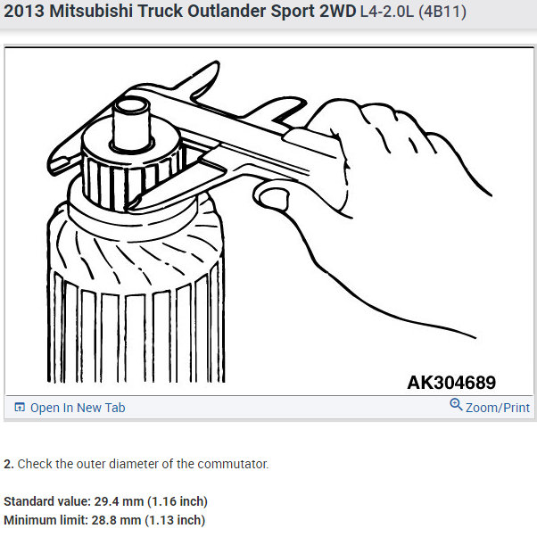

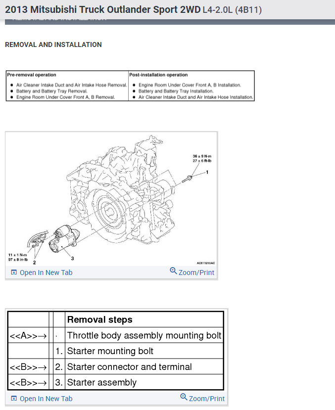

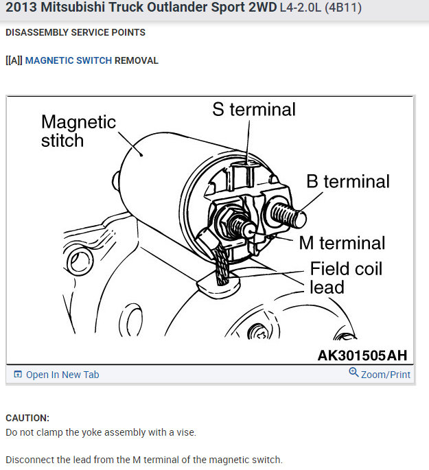

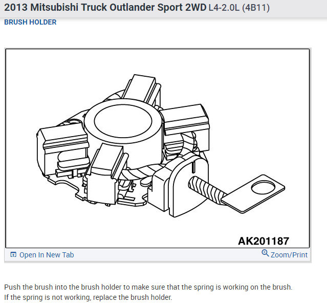

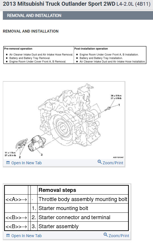

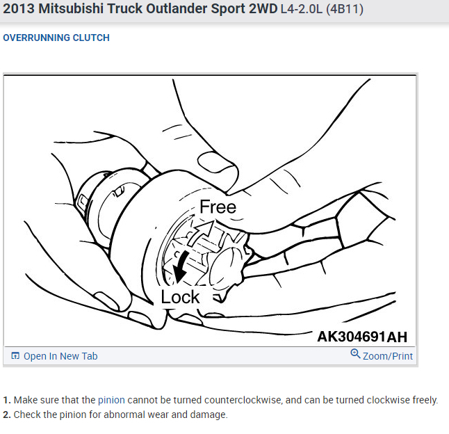

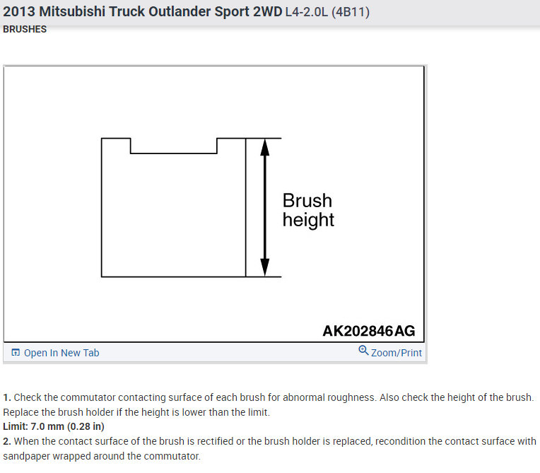

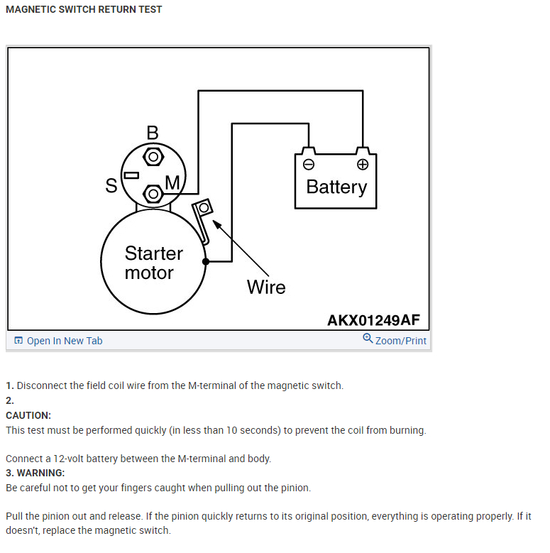

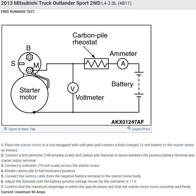

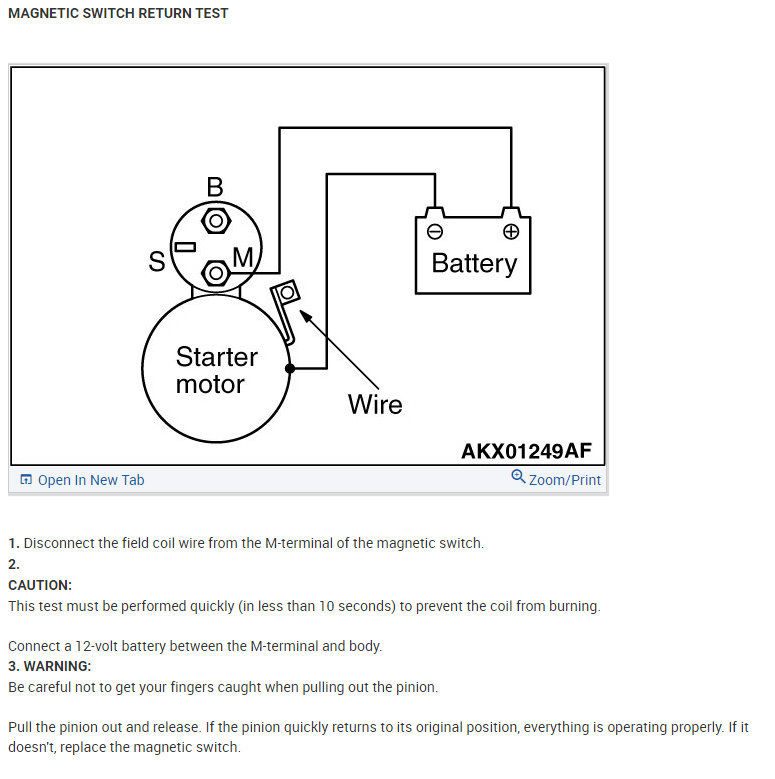

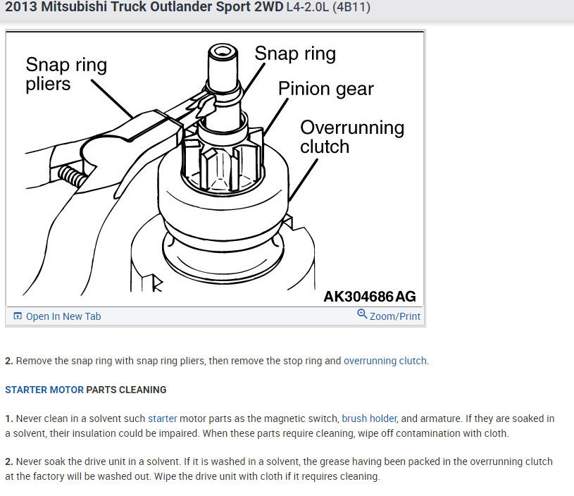

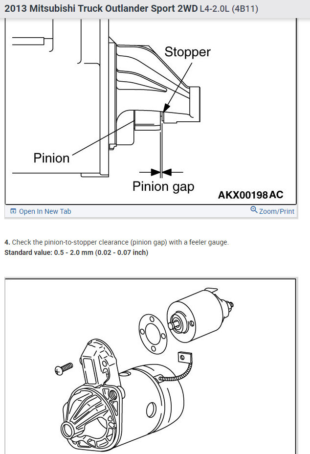

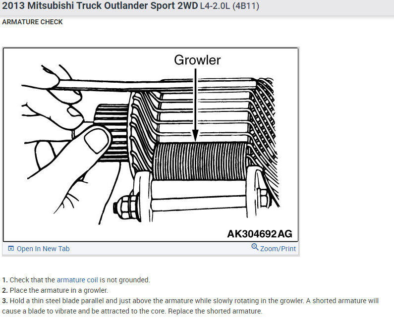

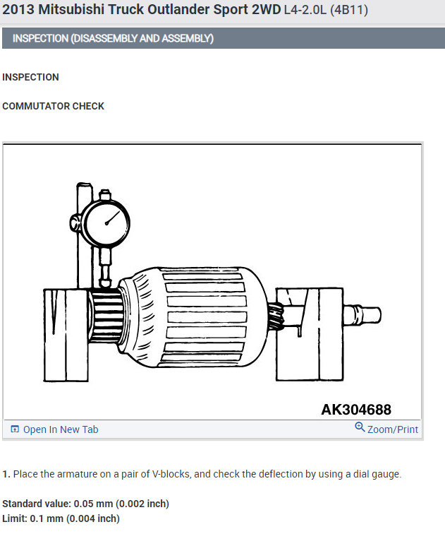

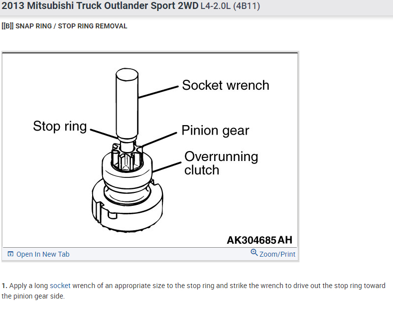

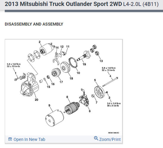

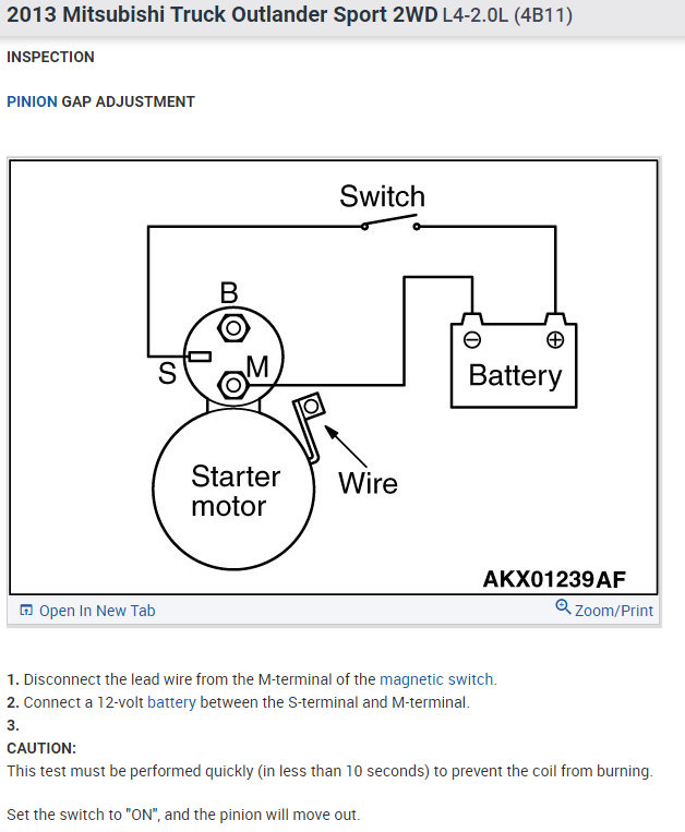

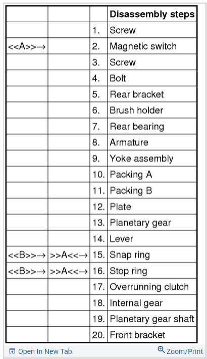

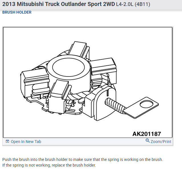

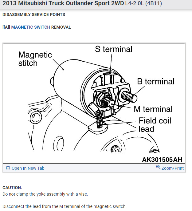

the car starts most times but does not start sometimes and when it's not starting it only makes one click.
Jul 15, 2021 at 1:40 AM
SQM
Experienced Mechanic
6,383 POSTS

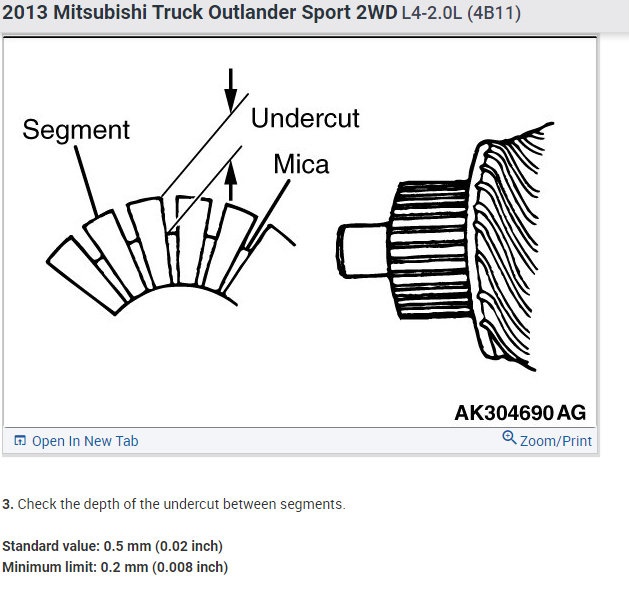

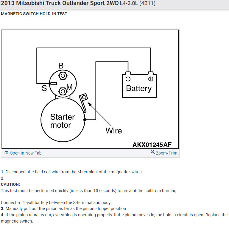

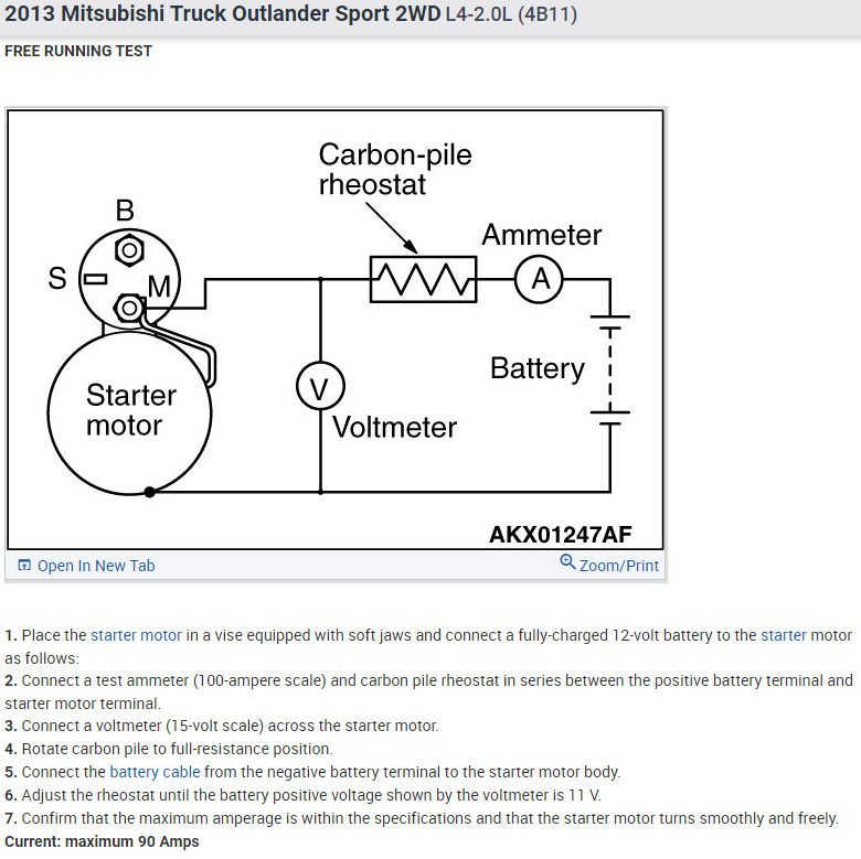

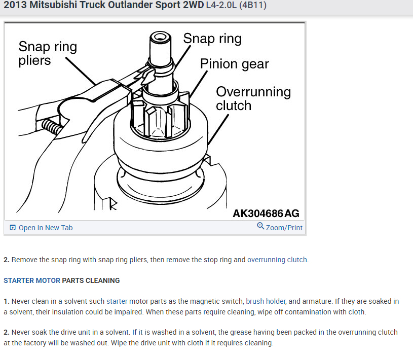

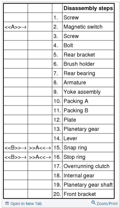

I have attached complete replacement and rebuilt procedures for the starter, see bellow.
You also might find this article helpful:
https://youtu.be/iySmMQM5OLE
Let me know if you have any questions.

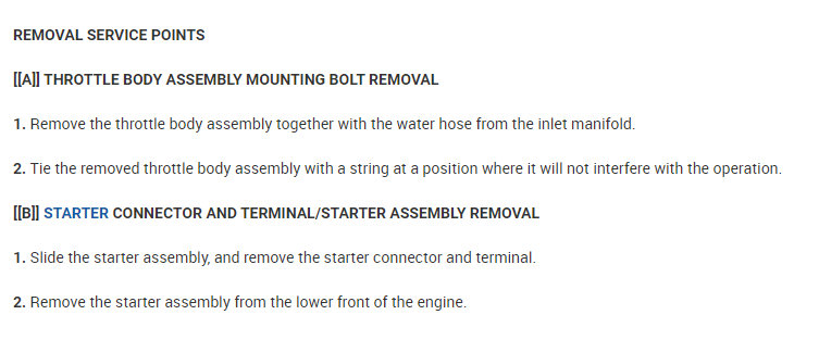

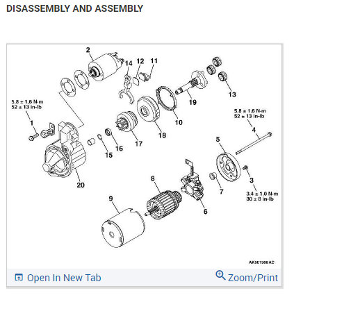

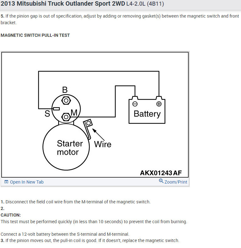

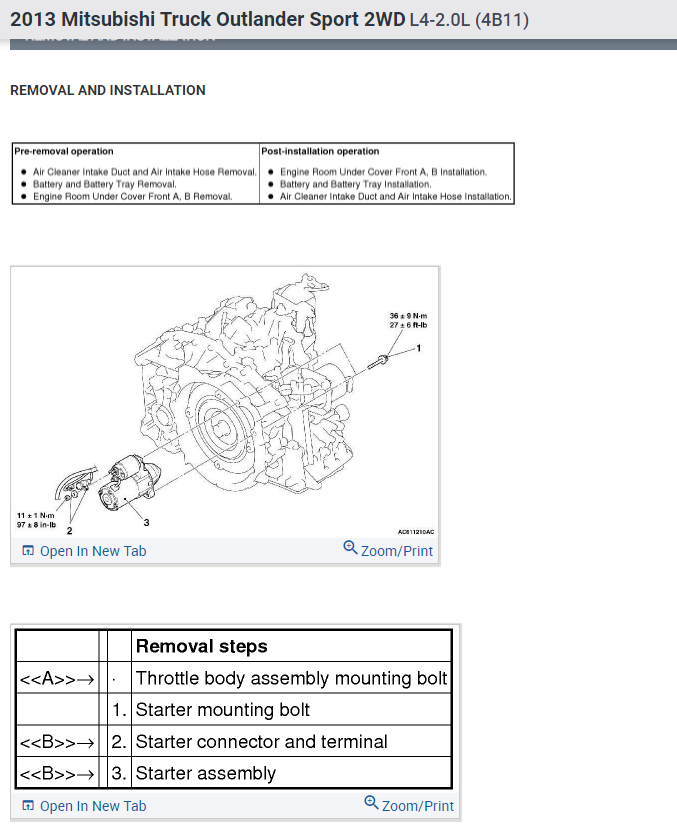

Jul 15, 2021 at 2:03 AM

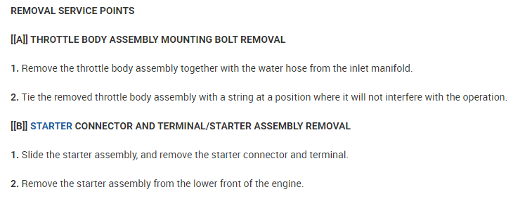

COLBY_STEPHENSON2000
32 POSTS
I have attached the removal and install of the starter motor below. With the amount of miles I would just replace it. It could make for a bad day if you remove it and try cleaning it and reinstall to find it still doesn't work.
Let me know if you have any further questions.
Thanks,
Colby
